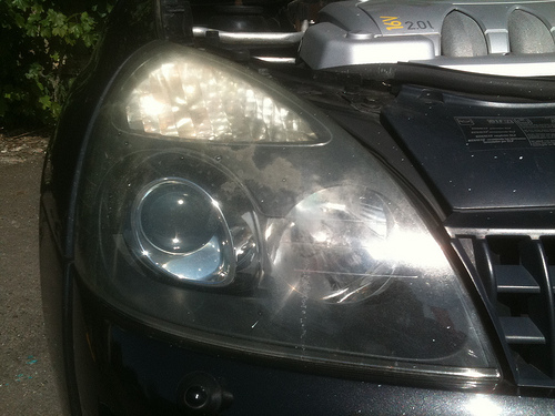

Okay so I had damaged lights due to oxidation as far as my knowledge goes from when I looked up the problem on here and Google so I went ahead and attacked it with some Lens polish I bourght off eBay. Said that it would fix 99 out of 100 lens and I had high hopes it woud just clean them up a little bit.
So I followed the steps and did it all how it asked, sand down with the lens polish through the grades then clean off, then polish them up with the polish compound.

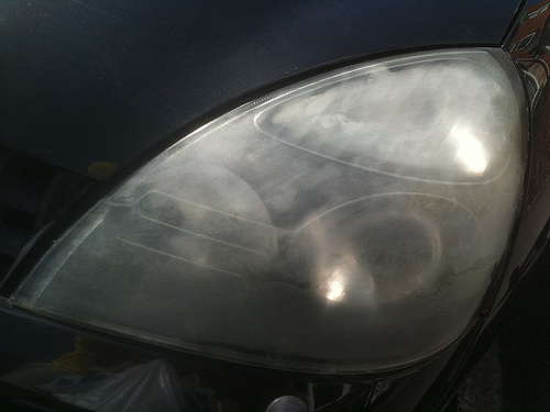

Thing is now there's a cloudy residue clinging to the lens now.. It washes off pretty well and looks alright then drys and goes cloudy once again :/ It's really annoyed me as now they look worse than before!
Anyone had this happen to them, how did they go about fixing them?

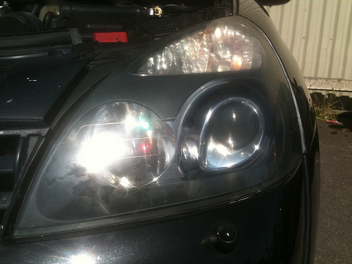

Sound, used to own a 106 :) Thought I recognised your nameeee haha. Just got myself a little polisher and some sand paper and meguires scratch x so should be mint in a few hours. Will post up the final result :)
  PB172
Okay done! Happy with what the outcome was, needs some more TLC but will probably have to wait untill I have no University coursework to finish... Well start then finish. Check this:
The outcome :)
Dead pleased :)
