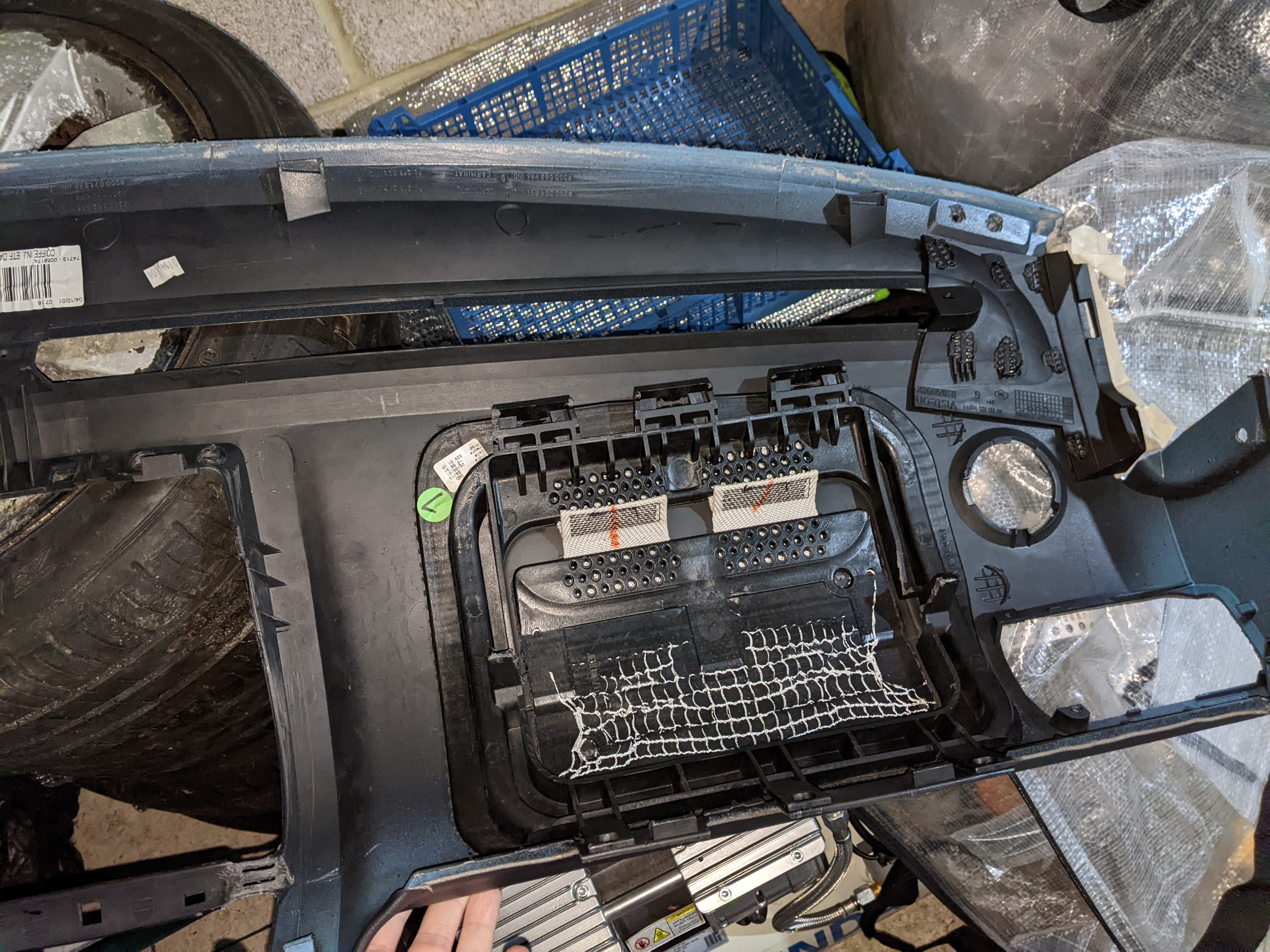

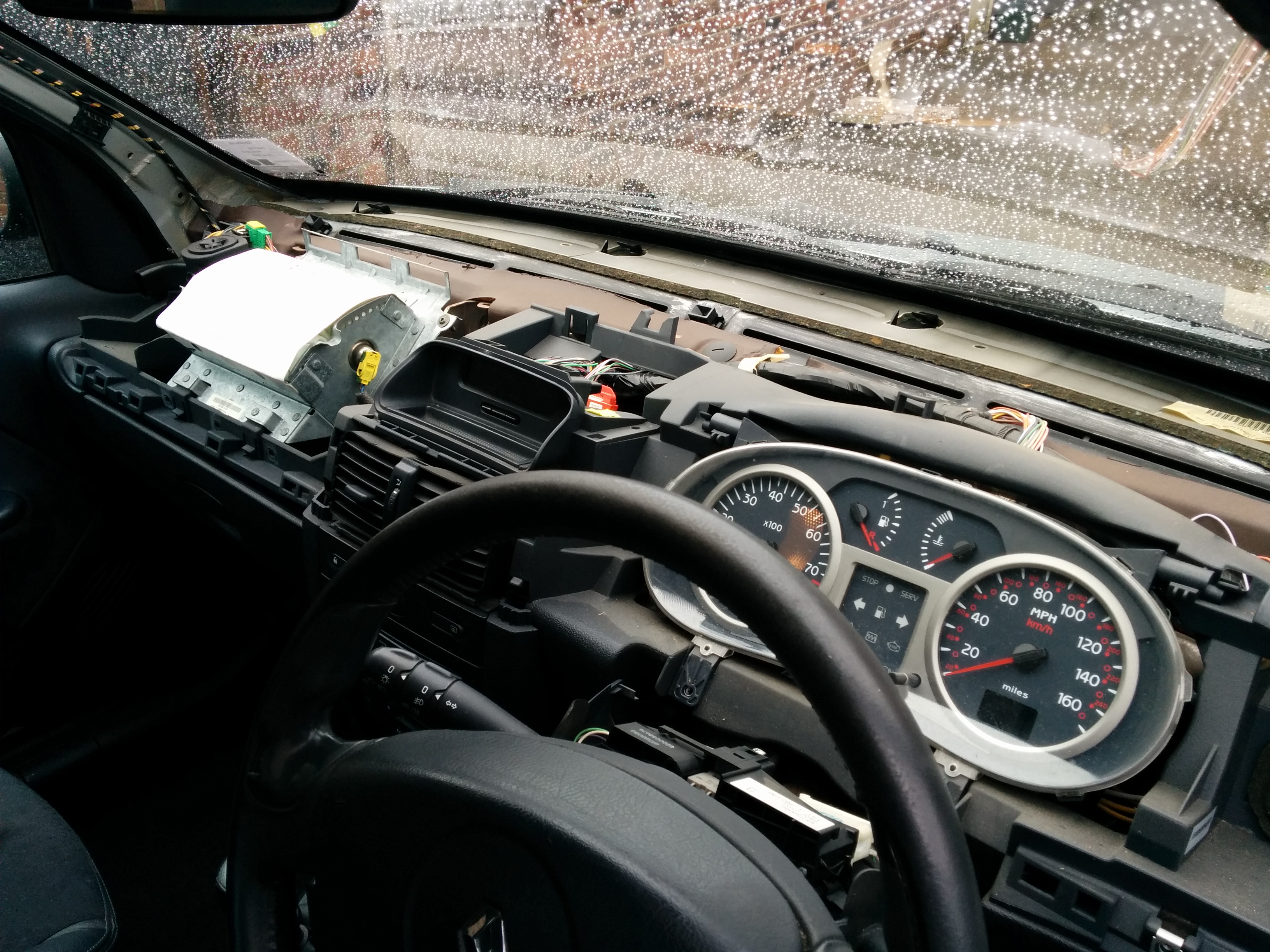

I must be piss weak, because I just can't get the left side of the upper dash to budge where the air bag is. Over on RenaultForums.co.uk there's a number of posts on this subject and as shown in most videos, the upper dash just pulls up and off, however there are a few posts that describe having difficulty in getting the left side off. The solution proposed in that case has been to "push down on the dash at the back of the airbag and then pull back.
In the above photo, I can see that there are three rectangular holes in the back of the metal airbag housing/frame, I'm thinking there may be some clips on the underside of dash that engage in those holes.
It would all make sense if I someone could post a similar photo of the underside of the dash to see what type of clips (if any) are stopping me from pulling the dash up and out.

Exactly the same thing happened to me. The airbag frame had been bent, so the slots in the dash wouldn't release. My solution was to unplug and unscrew the passenger airbag in situ and bring it out with the dash - super fiddly with a 1/4 wrench but it worked.
Then bent the airbag frame back into shape before reinstalling
Pic of the airbag slots for reference

*Pegs that go into the airbag slots
I read another post yesterday that said you have to pull the upper dash straight out toward you, not up.
So, in my case, it was probably a mistake to lever up the front of the left hand (airbag) side, because now it's stuck in that position and I can't force it back down into the normal position :mad:
