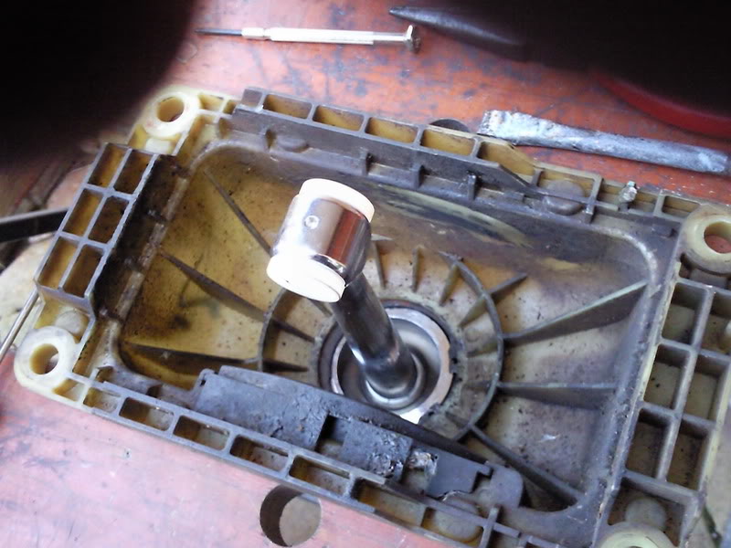

right if you look under the car there is a plastic bush on the end of the gear lever, this is my short shifter but you can see it here in white (yours is prob red ish?)
check to see if that is in tact, if its goosed it might be that. if that looks ok, follow the linkage down towards the gearbox, you will have a nut and bolt thats holds the linkage together, check to see if that is loose at all or if you can move the linkage in and out of the sleeve. if anything is loose it will need adjusting so you can get all gears and then tightening back up
hope that helps you mate, give us a shout if not and we'll take it a step further :)
