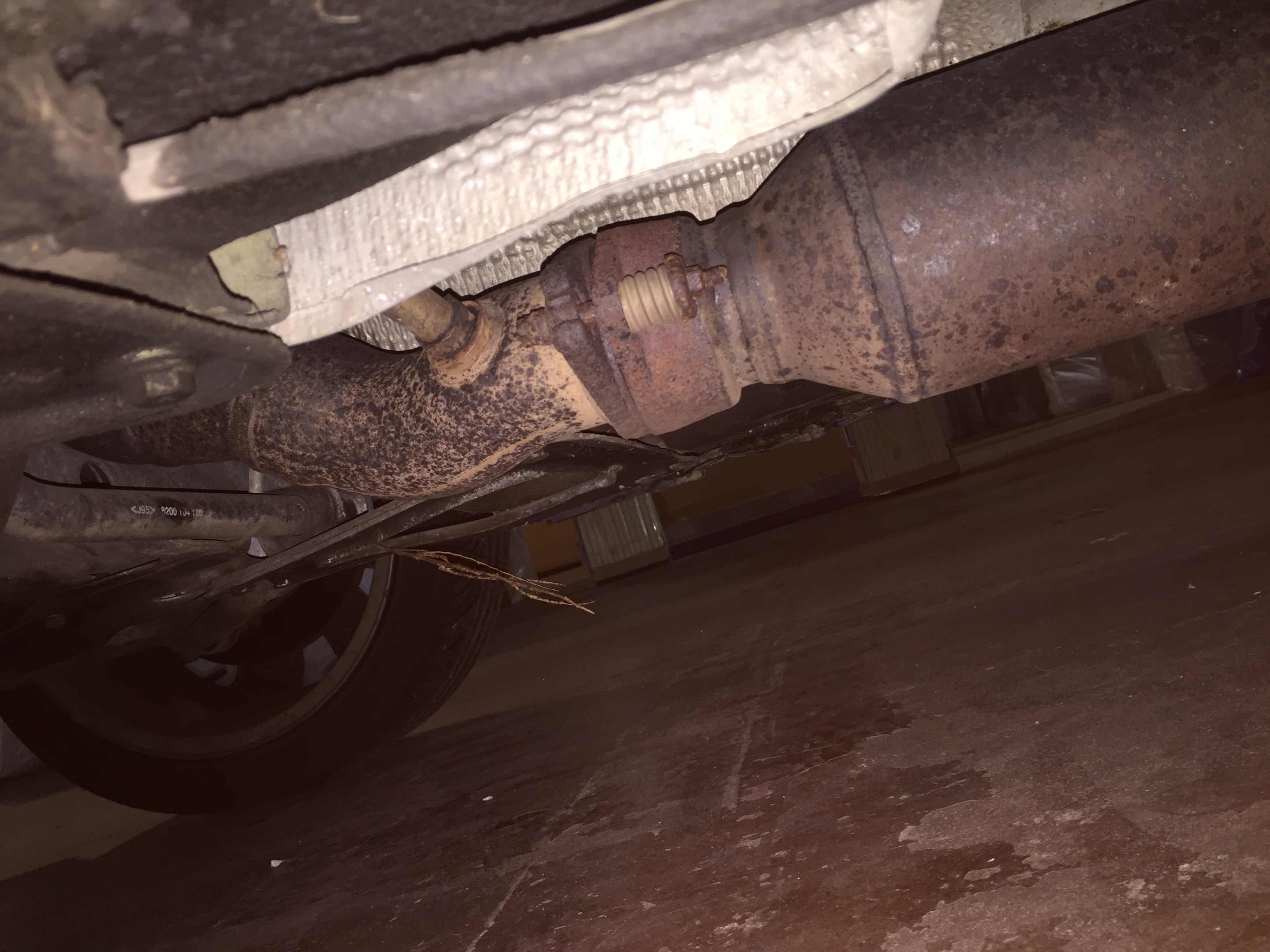

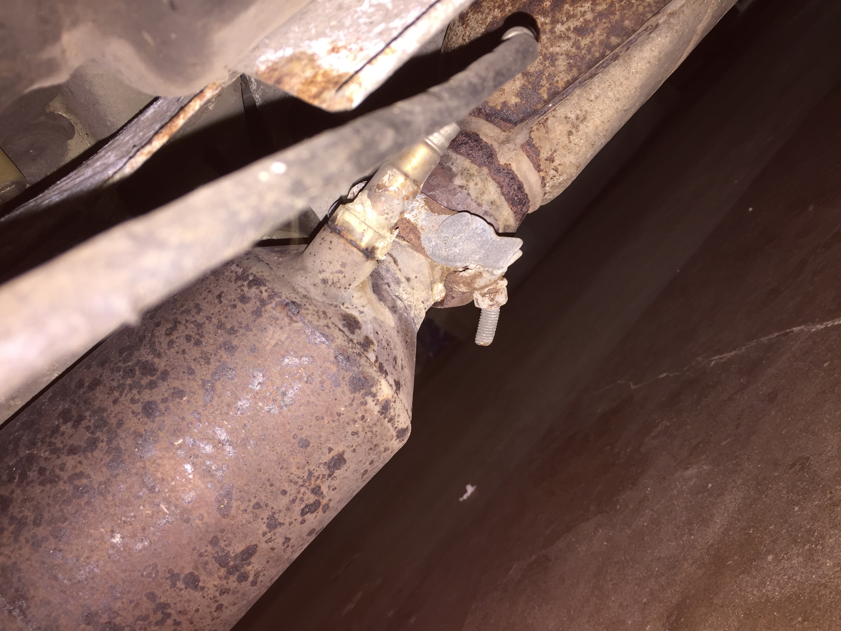

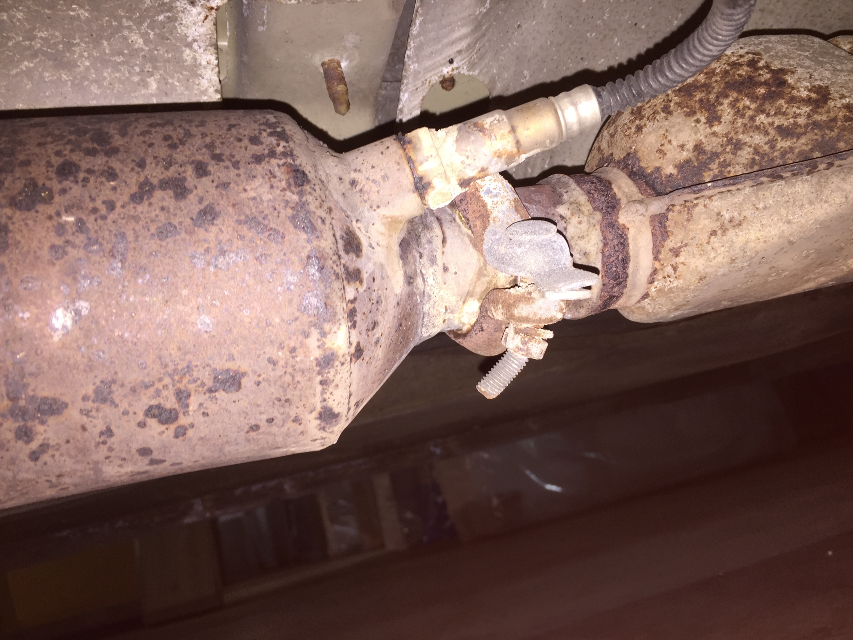

Just jacked it up and had a look underneath everything looks alright, the noise coming from the exhaust sounds like it by the cover maybe touching it, i took pics of the clamps, they look ok apart from one of the bolts have bent, any advice??
