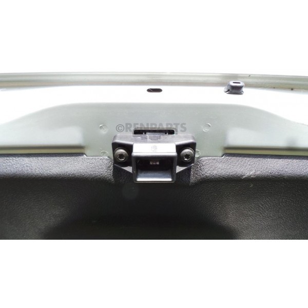

  Ph2 Meg 225
More than likely this part @GavC
I had it on my 1.2 where the inner part of the mechanism gets stuck, either so it thinks the boot is open and went off after 20 mins or that the boot never opened and the light never coming on. I stuck a screwdriver In mine and gave it a poke and was fine after.
Maybe worth a try as it will more than likely be that part.

Thanks buddy I'll check this part out!
