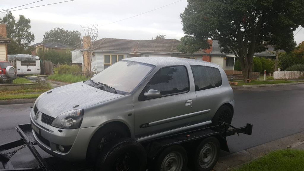

Purchased a little go cart to build as a track (race) only car. After completing a year of sprints in a jaguar xkr with more than enough power was sick of little clios keeping up with me over a lap. If you cant beat em jion em I say.
Test drove a crx, a mr2, a mini and by my criteria the[emoji79] factor the clio win hands down.
The other very important fact was i could make her very light and there was not too much electrinic bs like my Jag. After all quick lap times are made in corners and braking.

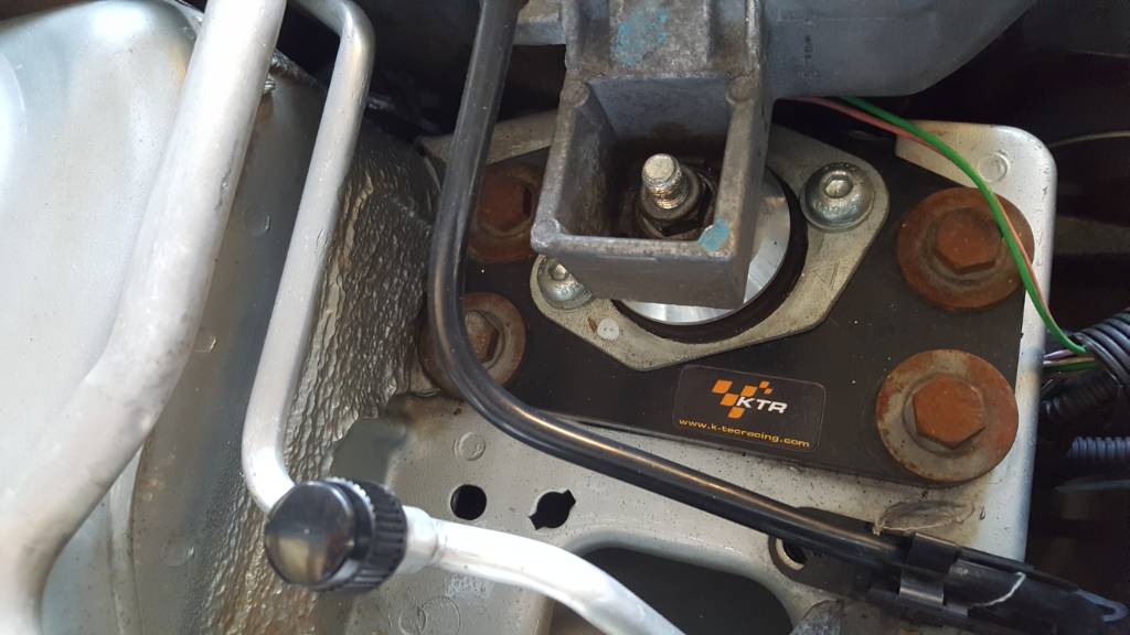

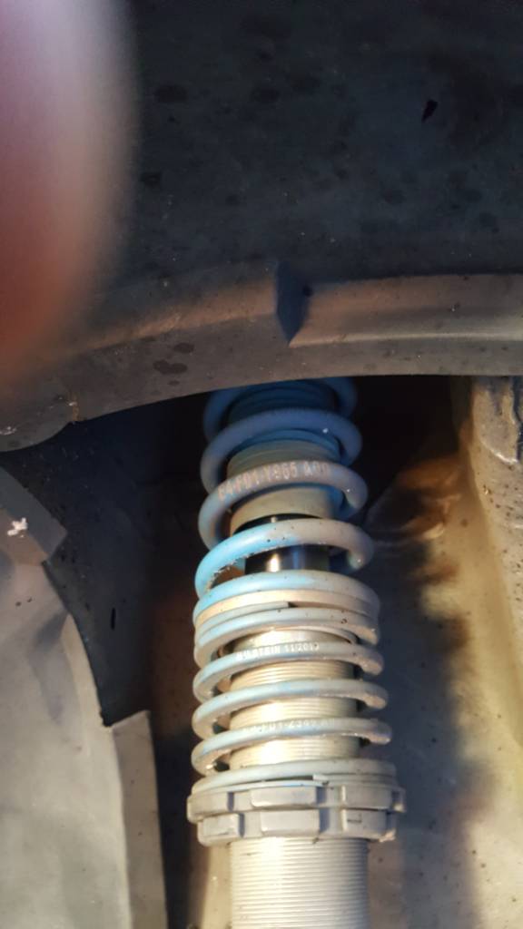

She came with a few goodies and wasnt a std 172. Bilstien coilovers, ktec engine mounts, front strut mounts and exhaust. (Dam they wernt pms gear but still good)

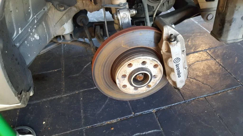

Brembo 4 pots on the front

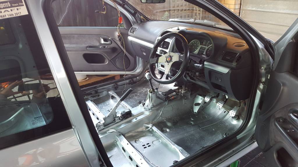

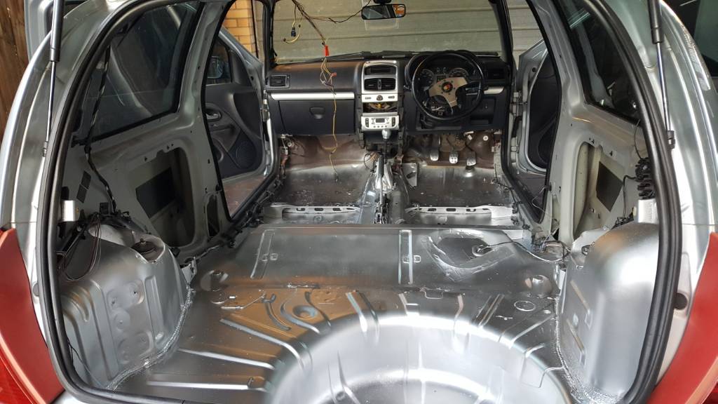

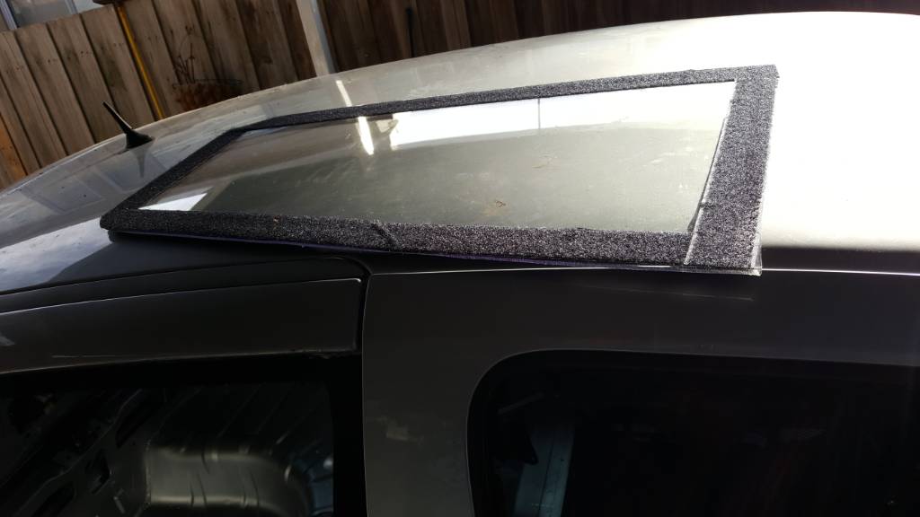

Time to start shedding some weight in preperation for the roll cage, race seat, harneses and other saftey items to go in for log booking and racing.

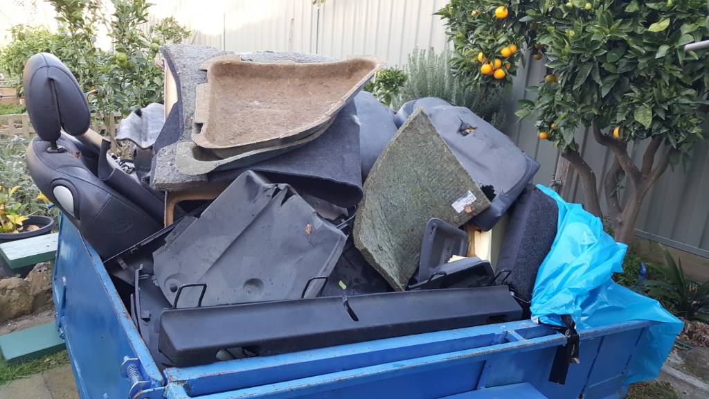

Stripped out all seats, carpet (that was super heavy) rubber stuff, plastic stuff ect ect. Got the grinder oit and all unnesesary brakets are now removed. Filled up a whole trailer of bits.
Thanks to the guides used resistors to bypass error signals from the now removed airbag.

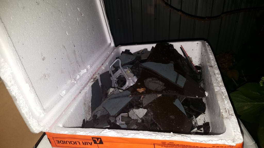

Luckily I work for a gas company so dry ice not a problem. 10kg dry ice pallets and afternoon with a screwdriver and a hammer and disgusting sound deadening gone. I work for a french company so totally understand the sound deadening on the "roof" as it would have kept some guy in job. There would have been 15kg of that black sticky crap in the car. Thank you dry ice.

Just an update on where she is now. With everything removed cleaned the shell then filled holes with silver tape and painter her silver as that was the easiest using 2 cans of spray paint.
Shes ended up fairly nice as i couldnt be bothered with taping up and masking. (Its a race car not a show car)
Still a little work to do on the wiring at the front. Im not going to go to crazy there as any problem caused by cutting too many wires will be a pain in the arse.

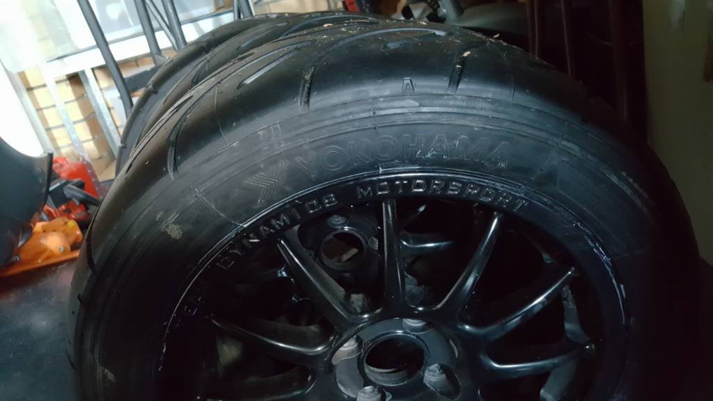

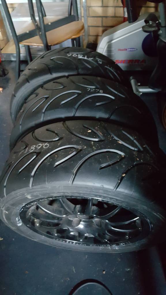

Upgraded my licence from a speed licence(sprint events) to a race licence. Also picked up the control tyres. Yokohama 205/50/15 advan 050s the maximum width for under 2 lt cars. They look so cool. Will use tyres to lower the car to the minimum 100mm at the front and have a 2 deg rake from rear to front. I have a scoda front thing(its not a splitter) and will make a front splitter and undertray from carbon fibre as being a front wheel drive im guessing I will need all the front grip i can get.(nothing worse than too much understeer)
Still to do fit front bumper with push in bolts. Then off for new door card set, rollcage and saftey gear, cams and a tune. After all this is done will sort the geometry out. Thanks Timotec

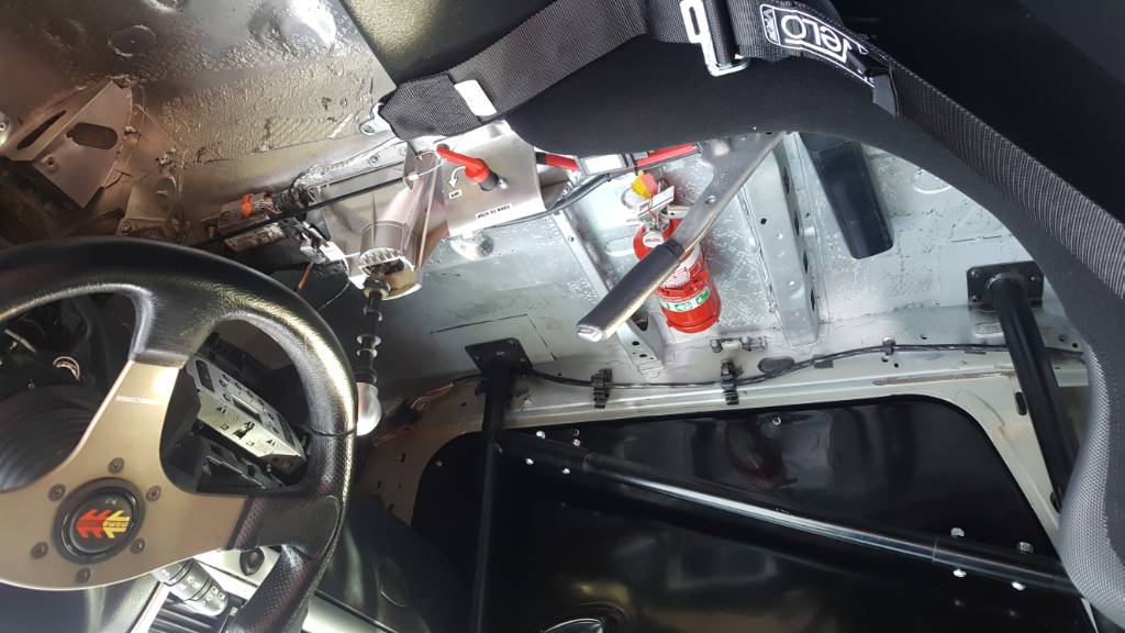

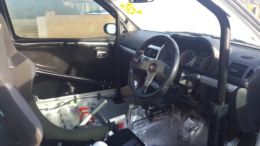

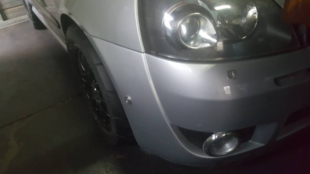

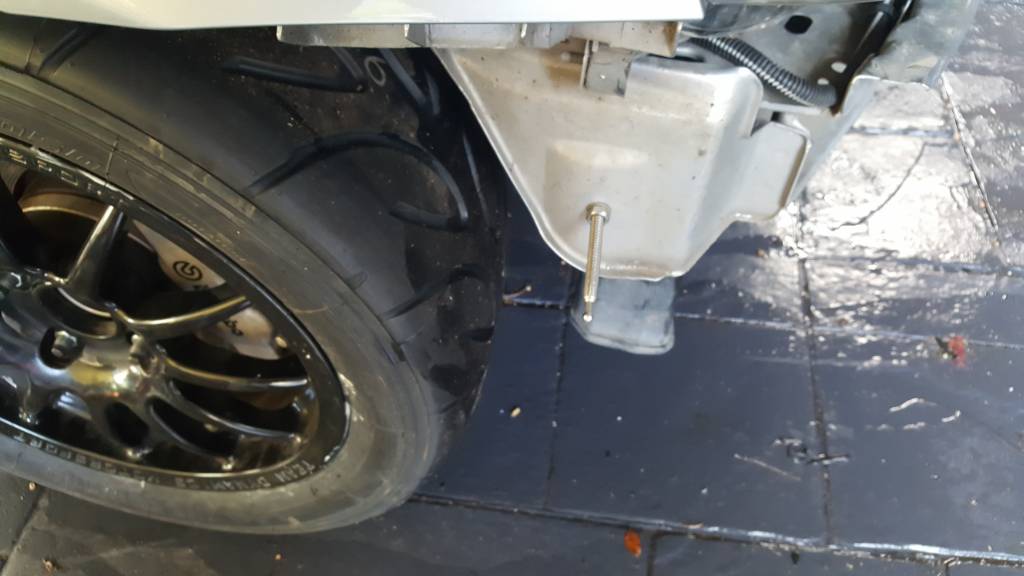

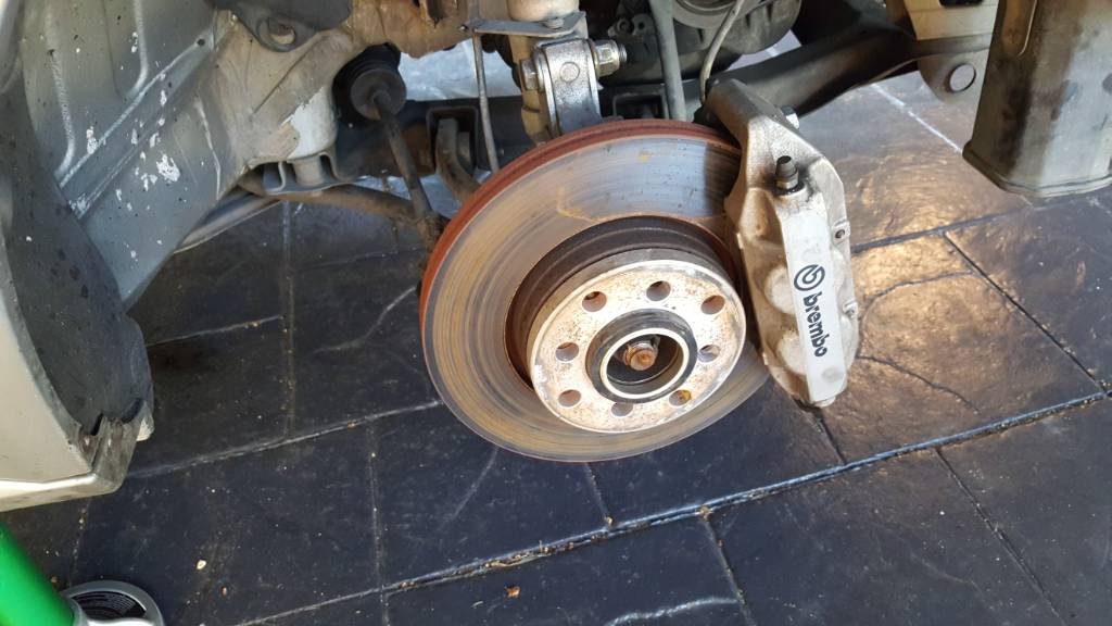

Few little more jobs today. Put on th e removable front bumper attachments, installed some air ducts in the fog lights to connect to the front brakes, aluminium taped up all the holes ive made and changed the oil. Wot a pain in the arse getting to the dip stick with a jms induction kit.

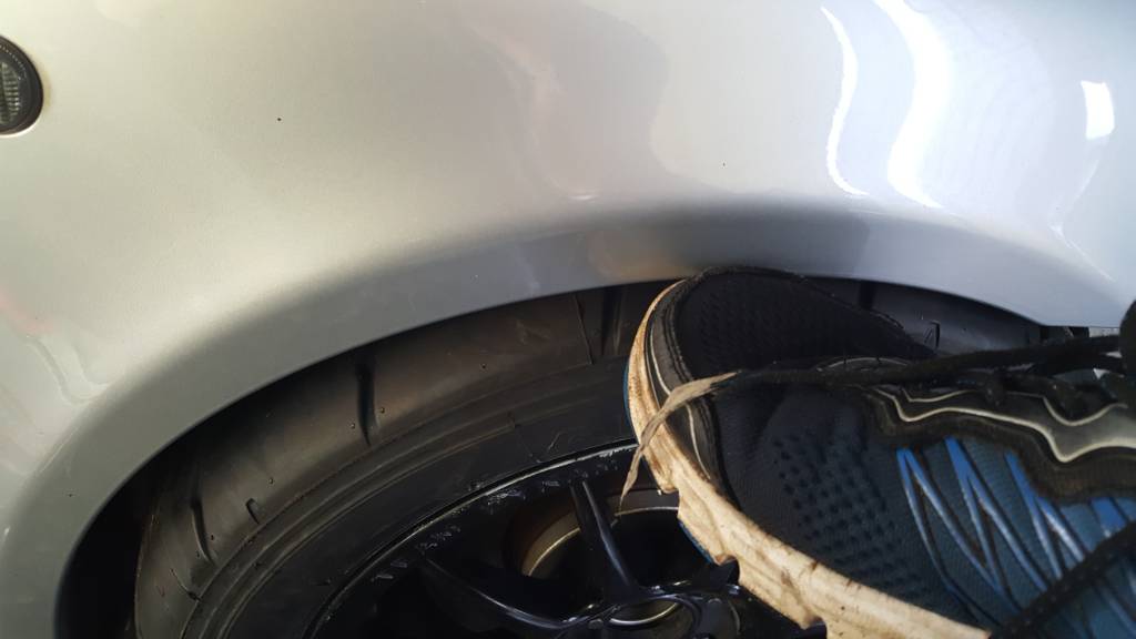

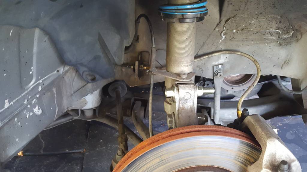

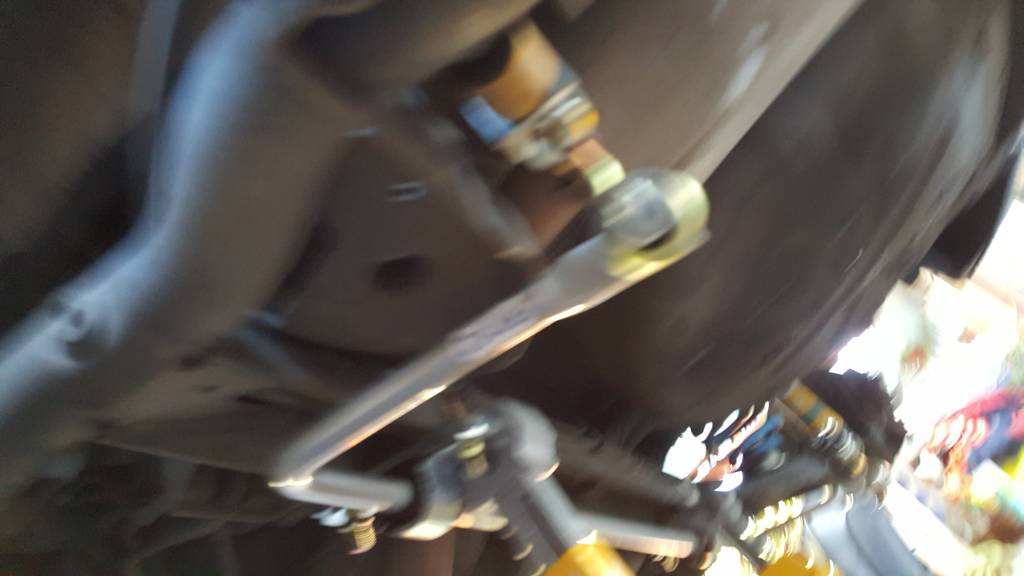

Quick update.

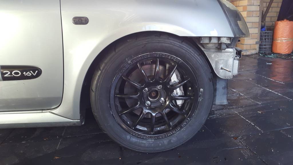

Car lowered to an appropriate level. Less than 1/2 a shoe can fit.

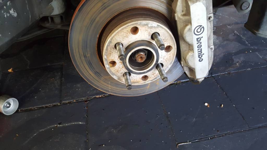

Wheel stud kit fitted. Wheel bolts are a total pain in the arse.

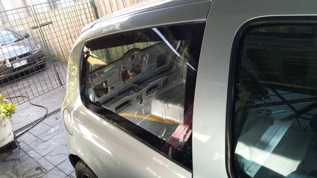

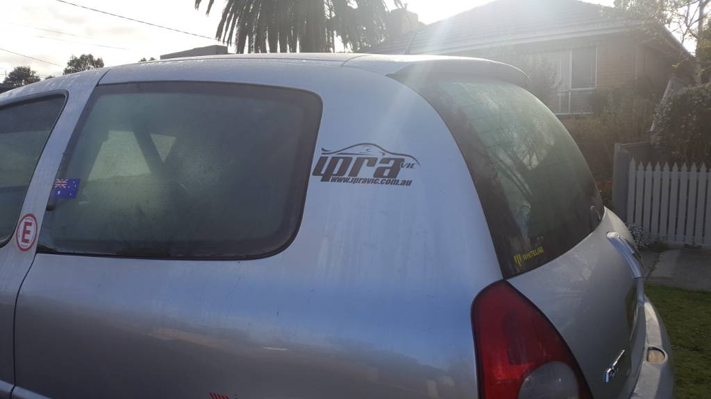

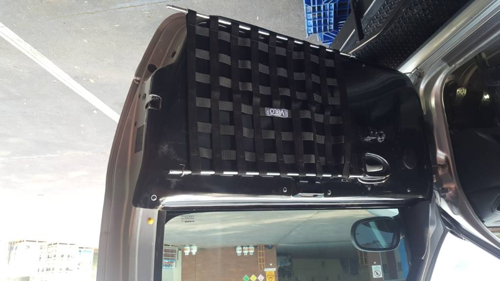

Lexan rear quarter windows in. Dont know the weight savings do know they look s**t hot.
Camber bolts fitted ready for track setup

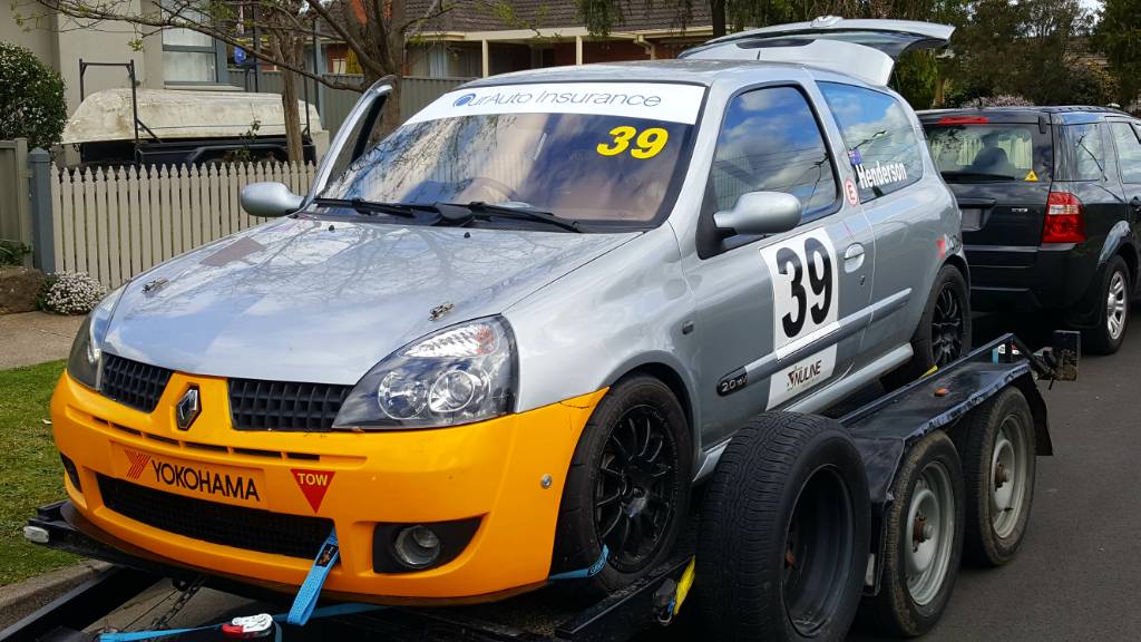

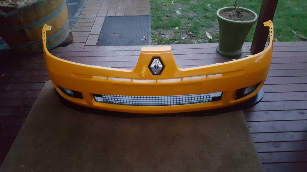

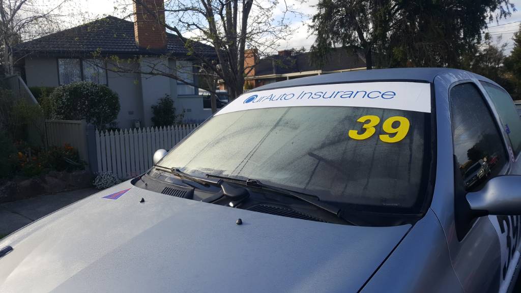

While waiting for my cage and cams and otger fast bits to be finished I thought some renault yellow to the bumper would add some speed. (Doesnt seem to be helping jolian palmer at the moment though)
Will look great against the silver.

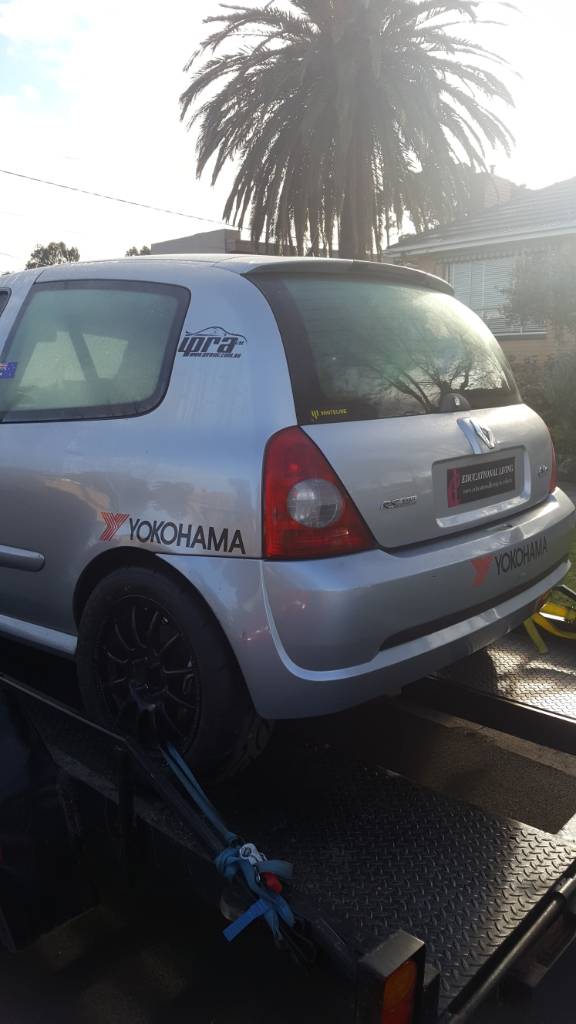

Finally got the car back ( well nearly)
It's been a while since I posted because the car's been stuck getting fixed for the last 3 months

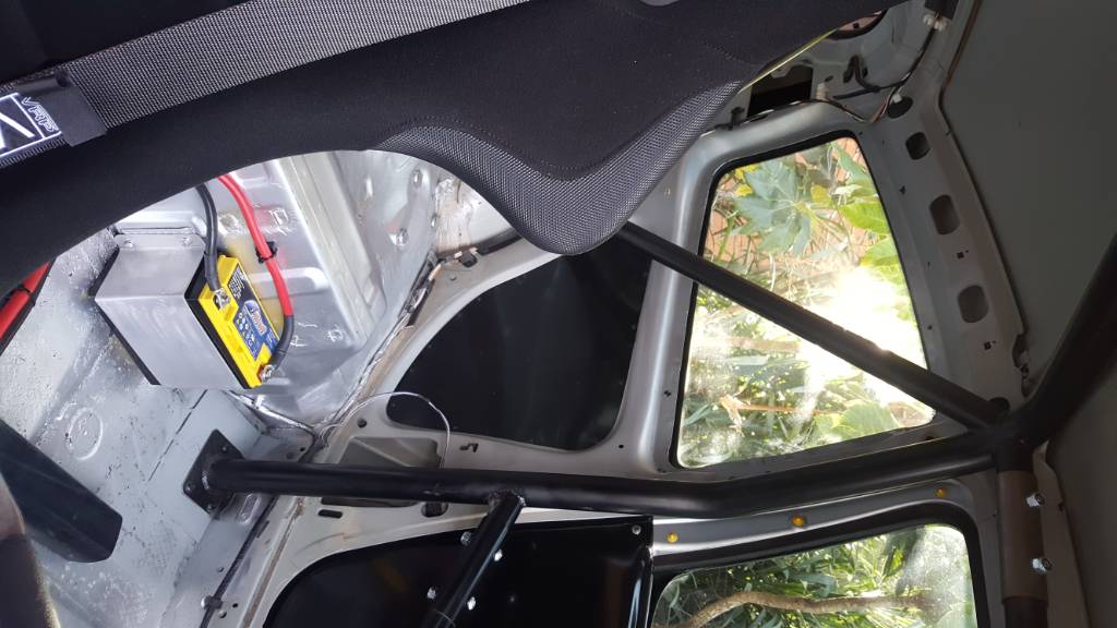

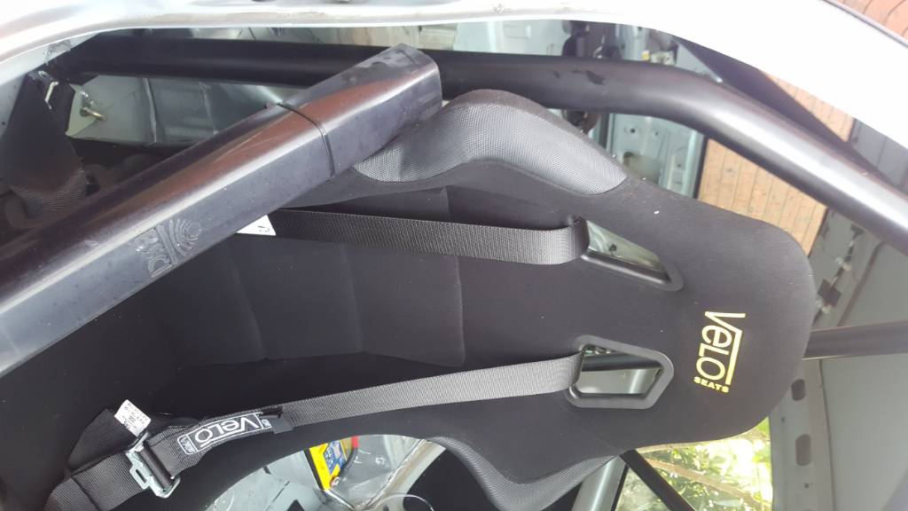

Cars finally been logbooked and is now cams registered to be able to race. Picked up the car Thursday night late thought I could Rush and get it ready for Saturdays track day at Phillip Island.
They have done a really neat job.

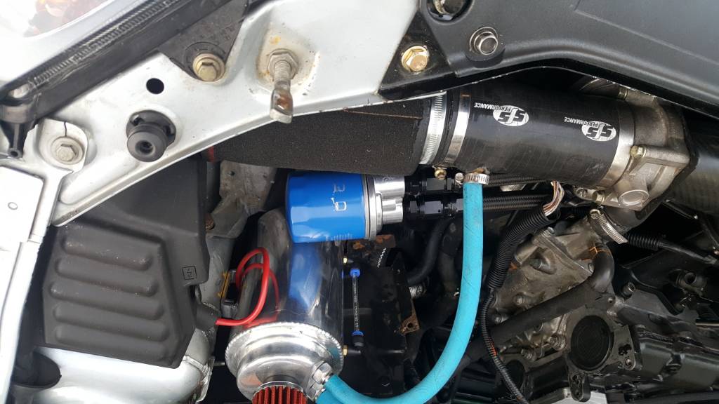

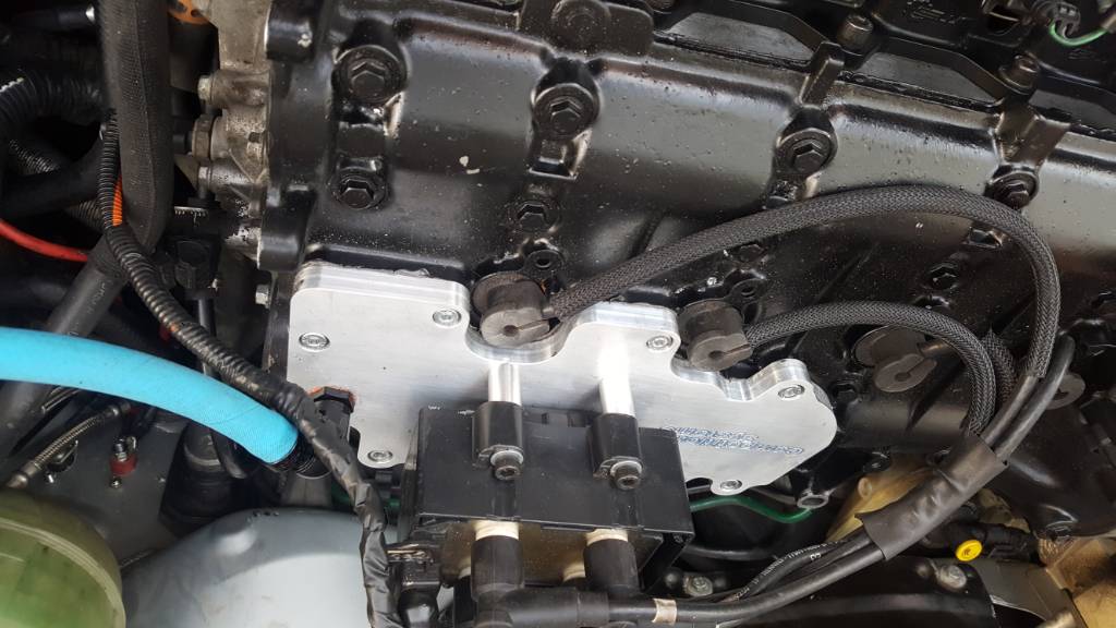

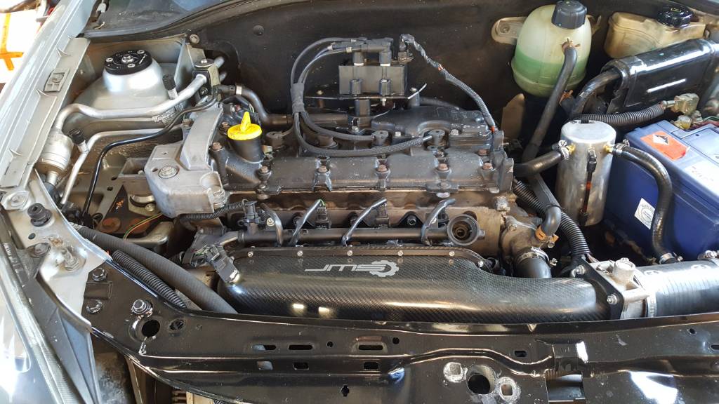

and the engine.
182 headers in, engine breather plate (laser cut) and remote oil filter and catch can.

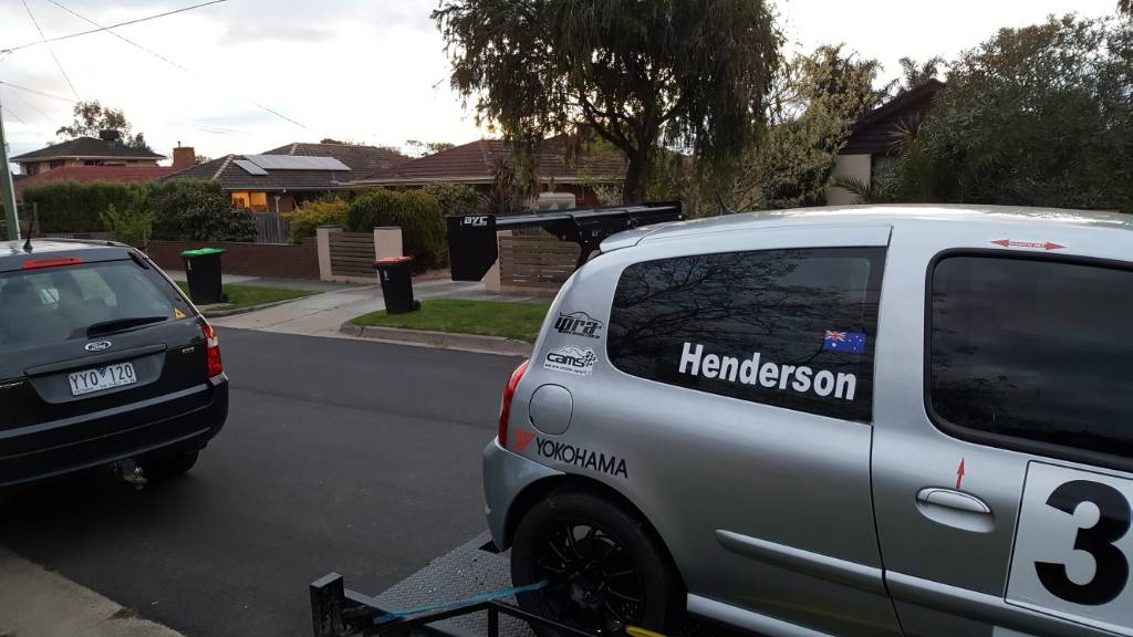

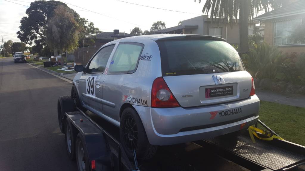

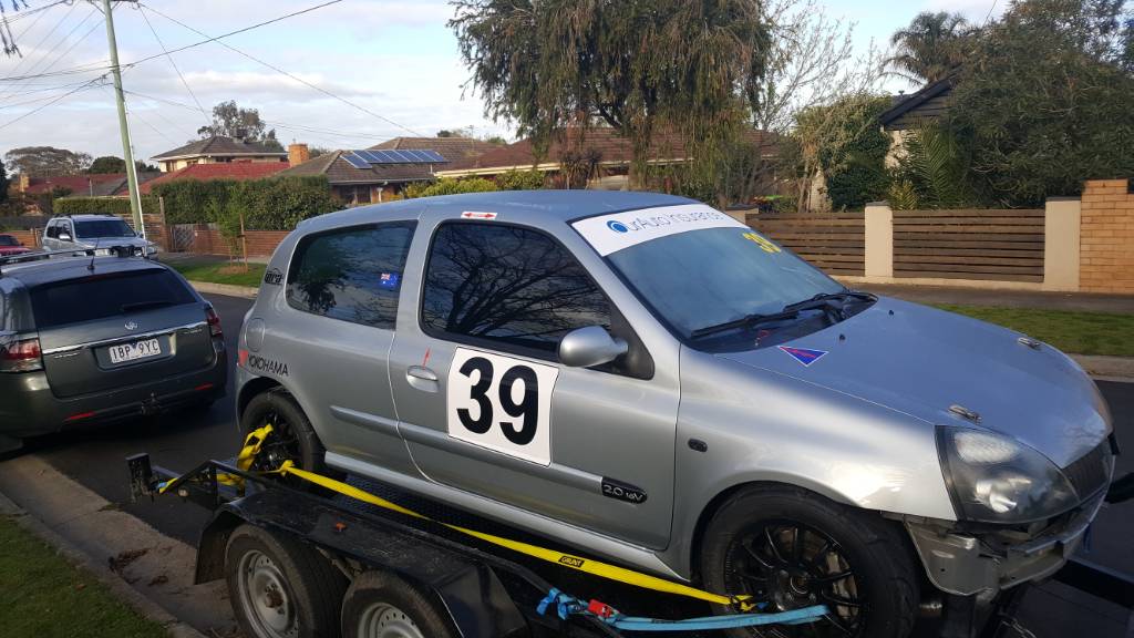

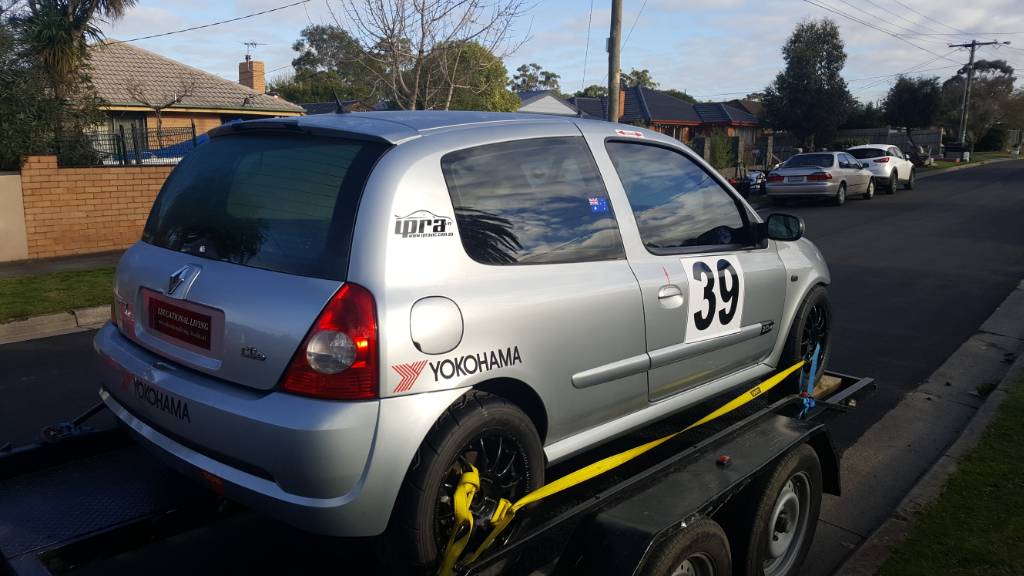

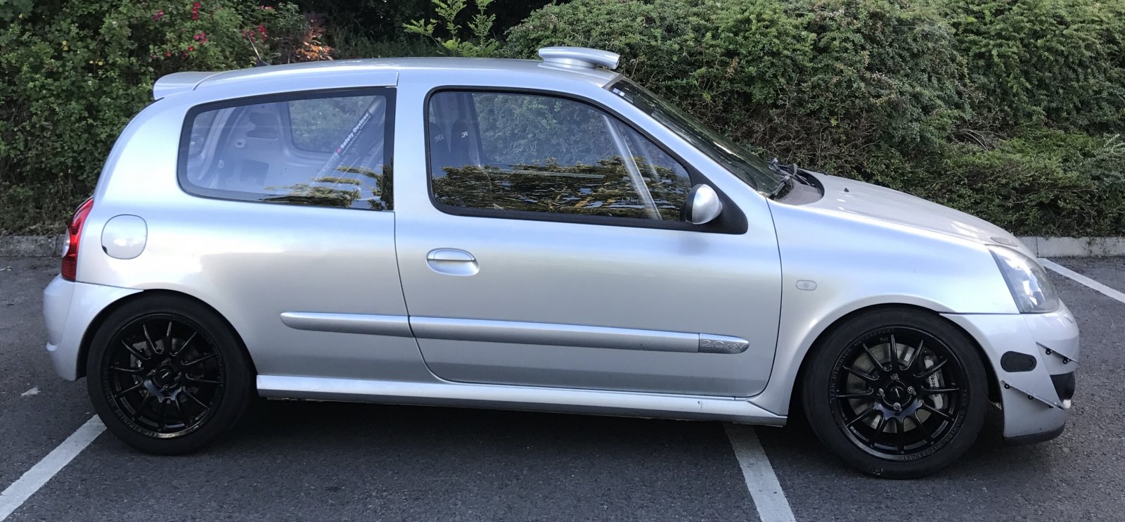

picks of her ready to race. First IPRA race will be gridding up on Saturday at phillip island.

BYC wing added for stability on turn 1 phillip island. thats one corner you need a big pair and alot of confidence in your car

Just a summary on what I've done to the Renault Sport Clio 172 so far and what's being done in preparation for next race season.

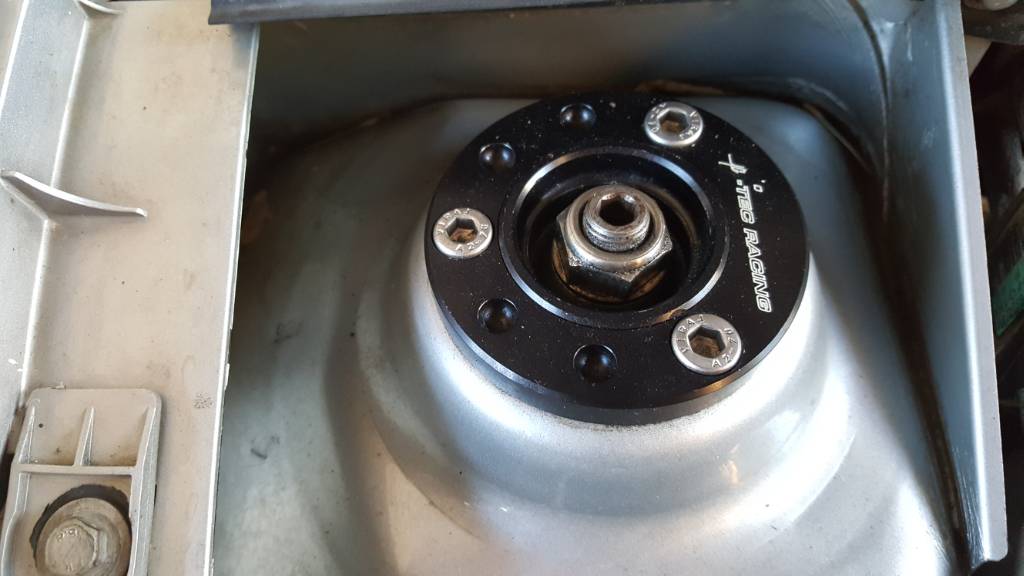

Bilstien B14 coil overs drilled out to allow camber adjustment
front camber bolts
Rear camber and caster shims
k-tec solid front upper mounts
Black poly rear bushes
k-tec solid engine mounts

battery moved to middle passenger wall
Yokohama A048 control tyres

6 point weld in cage
Engine cut off system
Race seat
HANS device
6 point harness

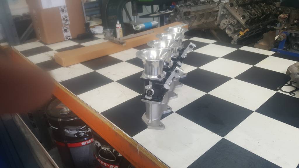

jenvey ITBs

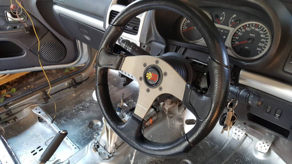

Detachable steering wheel hub
