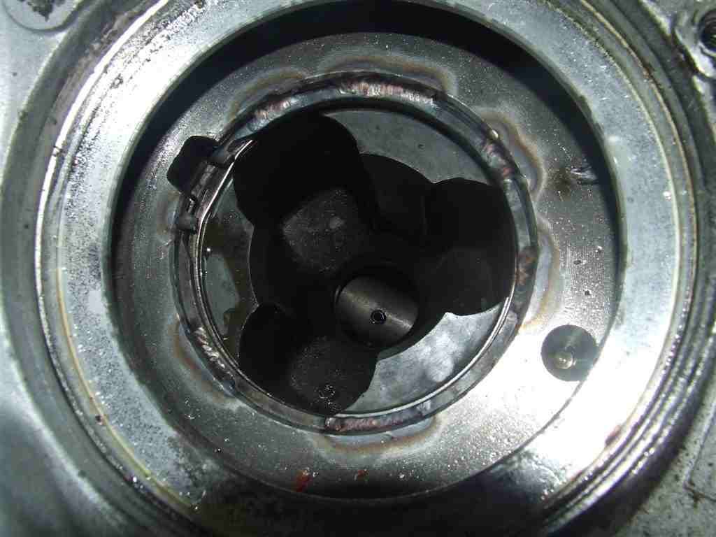

After a lot of hassle with the circlip iv decided to replace it and weld it in place. What my mate wants to know is what material is he welding with ie casing circlip and the slit where it goes into. Thanks guys
  Clio 182
  182
you got to drill and tap the holes?
Yep i stuffed a rag all the way round between the diff and box casing and stuck a big mother of a magnet in the hole where the shaft goes..
Only way i could stop the swarf dropping in the box lol, had the box out which made it easier but have done it in situ (never again)

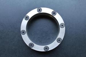

I have seen these on ebay but im wondering what actually holds it in place do holes need to be drilled into the box and then have it screwed in ?
  182
I'v got one of these rings to fit, is the diff no bigger than the hole in the casing as I don't want to end up drilling through the casing into it.
  182
To answer your question, yes the gearbox casing needs to be drilled and tapped to fit the ring, it replaces the circlip completely.
  182
Collar of the ring doesn't sit flush to the casing with mine (8 bolt GT performance version) unless the circlip is removed. I noticed with the thrust washer removed that the diff is the same size as the hole in the casing, so no need to worry about drilling into the diff.
