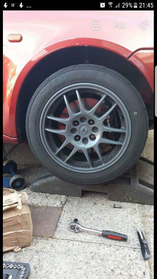

cs_dave
West Midlands
pic of the guy that bought my set when i broke the car
