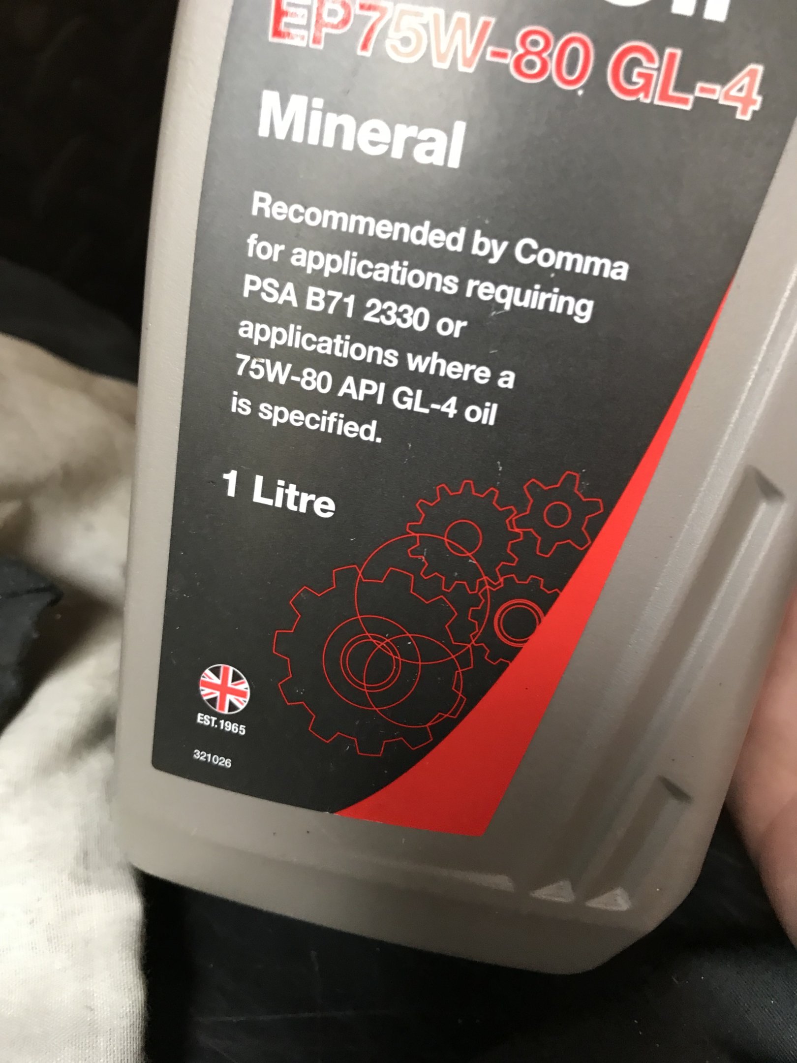

Cheap temporary gearbox oil
oreA
  BMW M135i; Clio 172
I’m tackling the near side driveshaft and replacing with a J&R which I’ve already purchased. Because of the ‘horror’ stories I’ve read about them not being fit for purpose I’m worried about having to redo the whole thing and end up losing the oil again. I happen to have some mineral gearbox oil that I picked up from Halfords a while back, could I put that in and run it for a while until I’m happy the driveshaft is ok, then throw some Redline MTL in?

It’s this stuff.....
