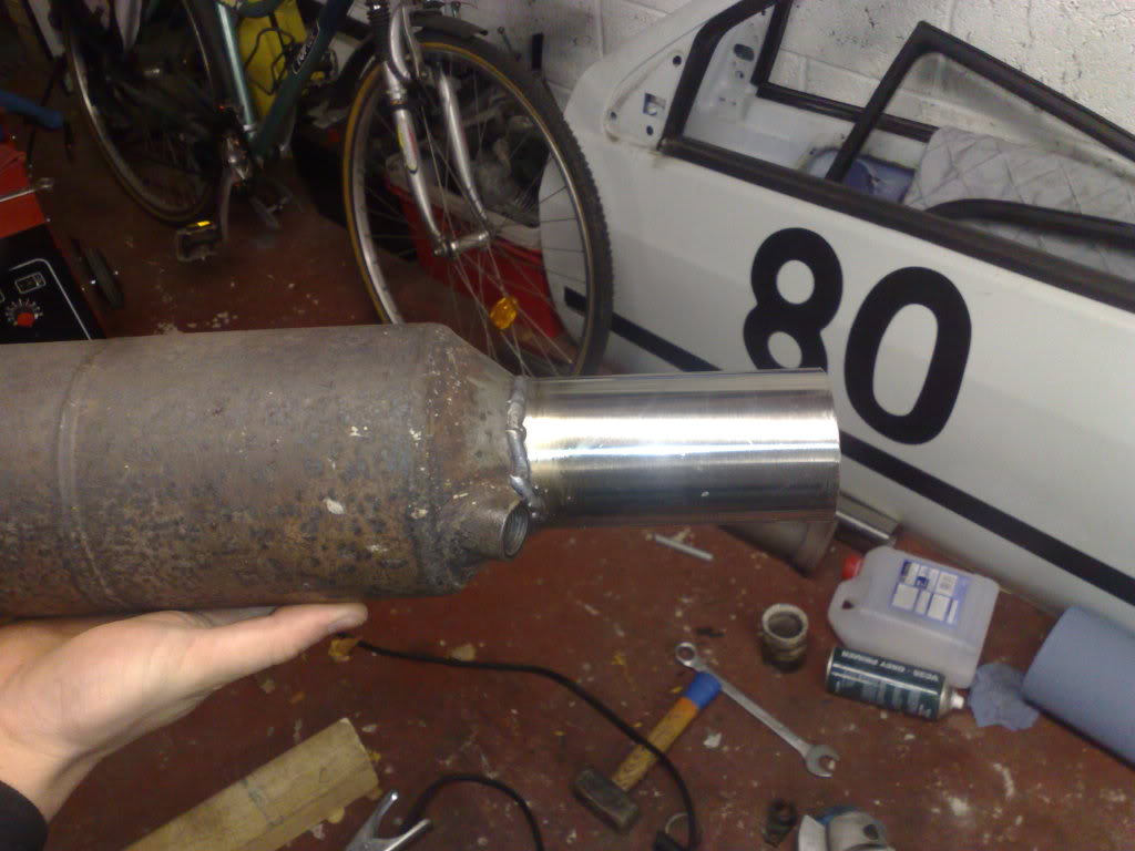

looks as though all you need is a piece of pipe and a welder
the one in the first photo just looks tack welded - presumably a mock up, as it won't be gas tight

Wasnt meant to offend anyone or their work but you don't a need championship winning history to cut a bit of metal and weld a bit of stainless steel.
You need a good welder lol

I would be around 2 hours labour (£80) plus around £20-£30 in bits (would use flanges so you could unbolt the cat still) plus the vat
no offense taken at all, but welding/fabrication isn't as simple as people think, look at miltek even they f**k it up!

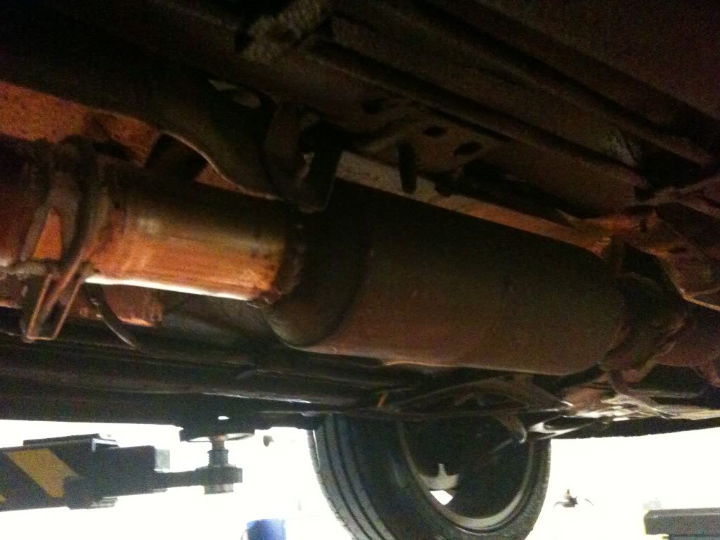

Had mine before and after tested with btb system, modded cat and inlets on the same rollers. 10bhp and 15lbft increase. And it WILL pass mot :)
Have a look at the mod BTB did on the cat. Nice bit of work to be honest. Holds the CAT higher too. £80 it cost to get done.
