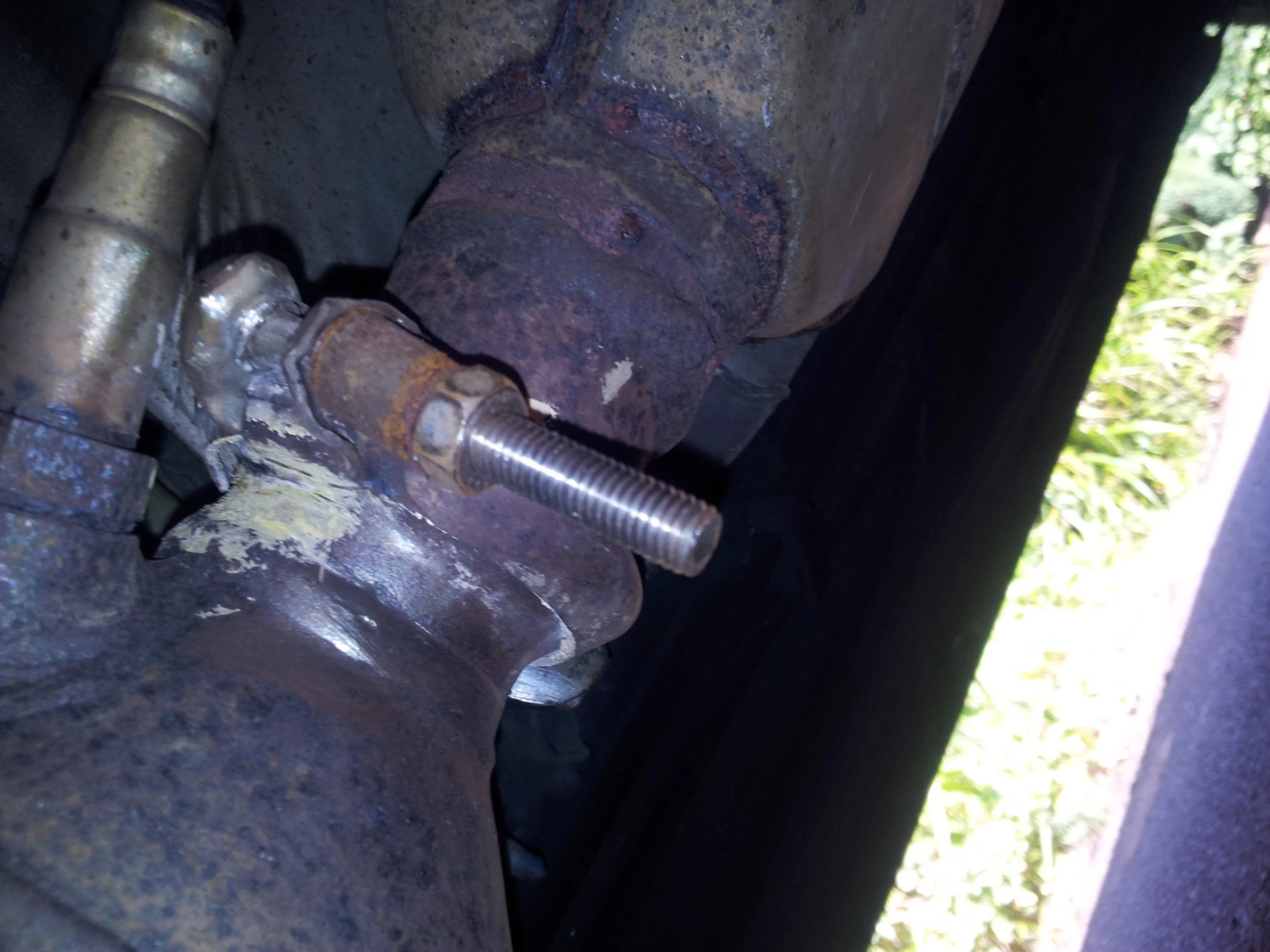

Thanks for quick replies - it is interesting that you say the genuine ones look the same as the Ebay ones - are they single bolt on one side clamps?
Maybe the one I have on there is wrong or old - here is a picture.
It's going up on the ramps again tonight just to double check that the weld hasnt split again (you can see some black on the cat where the crack was previously) but it might be worth just getting a new clamp I suppose.

that is an original clamp, but if you buy a new one from renault now it looks like the ebay one, but less flimsy
don't use exhaust paste, it goes hard and cracks. Use high temp silicon.
new clamp, 100% needed. not even a question tbh, just do it

Just on the join to the centre pipe. I had it re welded but it may have split again. The whole join is difficult to get right , eventually im going to have it setup differently. In the meantime im going to take it all apart re do the weld get a new clamp and try some high temp silicone as suggested. Since the exhaust is all straight having renewed all the mounts it shouldn't split again. Actually if you look at the pic I posted you can see some.black soot which OS where the crack was.
