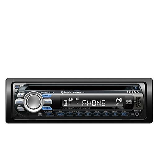

Noticed on the way to work this morning that my car stereo's not working!
There's no display on it all all, nothing. I'll dig out the manual when I get home, but in the meantime, any ideas? Could it be a fuse? Is it dead?
It's this one:
http://www.amazon.co.uk/dp/B001819LEG/?tag=cliospnet01-21

First thing to check would be the fuse and any wiring to the headunit.

Does ur fag lighter 12v supply work ? If not it's the fuse - was happening alot last month on here maybe the heat :\

It might be the inline fuse. Pull the unit out and check that.

Is there a reset button anywere?
If not try thr fuses will possibly have one in one of the leads from the back, or check the arial fuse in the main fuse box.

Pull it out and look either on the red or yellow wire and there will be a white or black plastic thing on it. Unscrew and check that. Shame your not closer or i would have had a look. It only takes about 5 mins to do.

Sorted!
All it took was a little poke of the reset button :eek:
