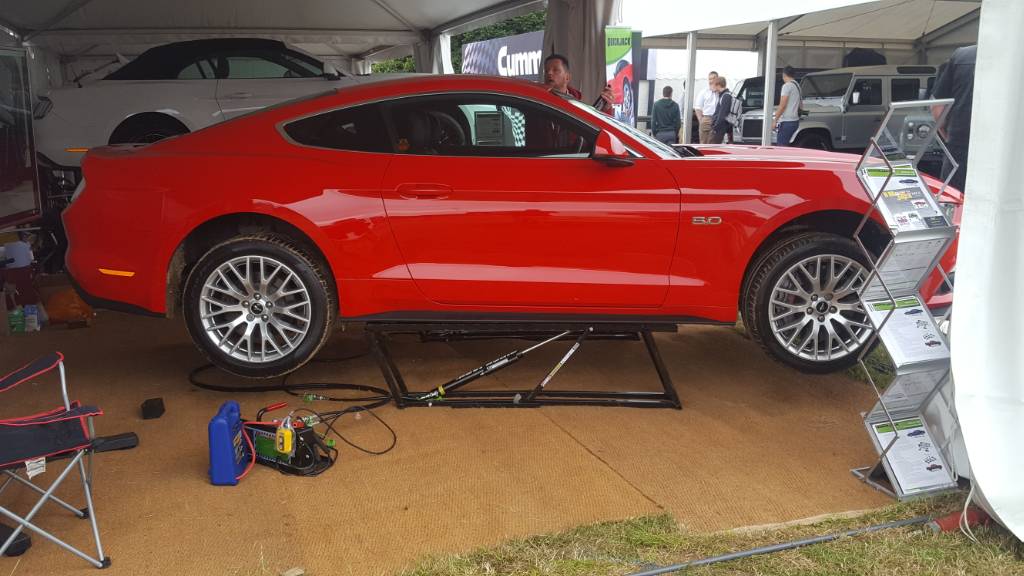

Yeah I like that ranger hydraulic lift - ticks a lot of the boxes but not entirely sold on them.
If I could keep the wheels on I normally would but a lot of work requires the wheels to be off

The diameter of the struts on the New Ranger lift hardly look substantial to me. Sure they are fit for purpose but lifting the whole car by the looks, not so sure I'd feel comfortable. Pistons can give.
Least with a trolley jack placed in the area that you are working for insurance, with axle stands that are usually pretty meaty, is not far off best what a DIYer can achieve IMO
Or- the best option- a Pit. No jacking of the car, no balancing, no creaking etc etc
Jaff.
A pit is no use and it gets in the way.
When hydraulics give they go gently, not suddenly like an axle stand, plus that ranger has a safety pole I the hydraulics do give

Just to add to this, i've been looking for something small and easy for lifting in the garage and the ranger lift i thought was a bit flimsy too until i watched this video of them
Jaff.
That’s pretty impressive - I’d still like to see one under failure though
Jaff.
The thing for me is it could fail with 10 tons on it or 1 ton on it either way I’m toast if it’s safety feature (that little bar) is useless. Hence I’d like to see one fail under lid to see how that handles it. That’s when it becomes worth the money imo

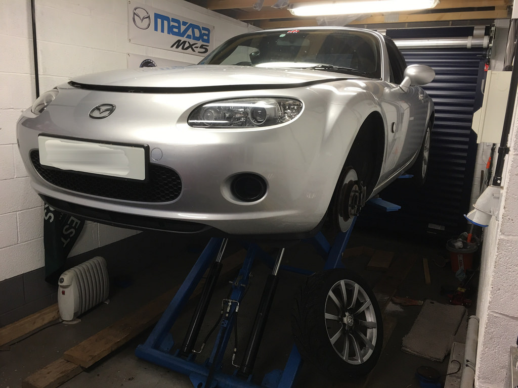

If you are thinking of investing in a lift, I would say go and do it - I had a garage built a couple of years ago and made sure I had enough left in budget to buy a scissor lift - which I sourced from BH Repairs, who I chose as they aren't far from me, and are also a lift repair/servicing company, not just a importer/reseller of Chinese kit (https://www.ebay.co.uk/itm/Mobile-c...972805?hash=item3624d1f245:g:QcQAAOSw7NNUHI9R) and it has been great - I have used it for a range of jobs on my MX5, clio and also building my exocet kit - next job is looking like the cambelt on my brother's newly acquired cup.
I have found it a great balance of convenience and useability for my (normal height!) garage - it lifts to 1.25m (4ft) which is great for doing most jobs - leaving you a nice working height and plenty of space to get under and around the car... not the cheapest, but certainly a good addition to the garage - and on the safety question it has a substantial mechanical ratchet-type locking system which will hold it in place should the hydraulics fail.

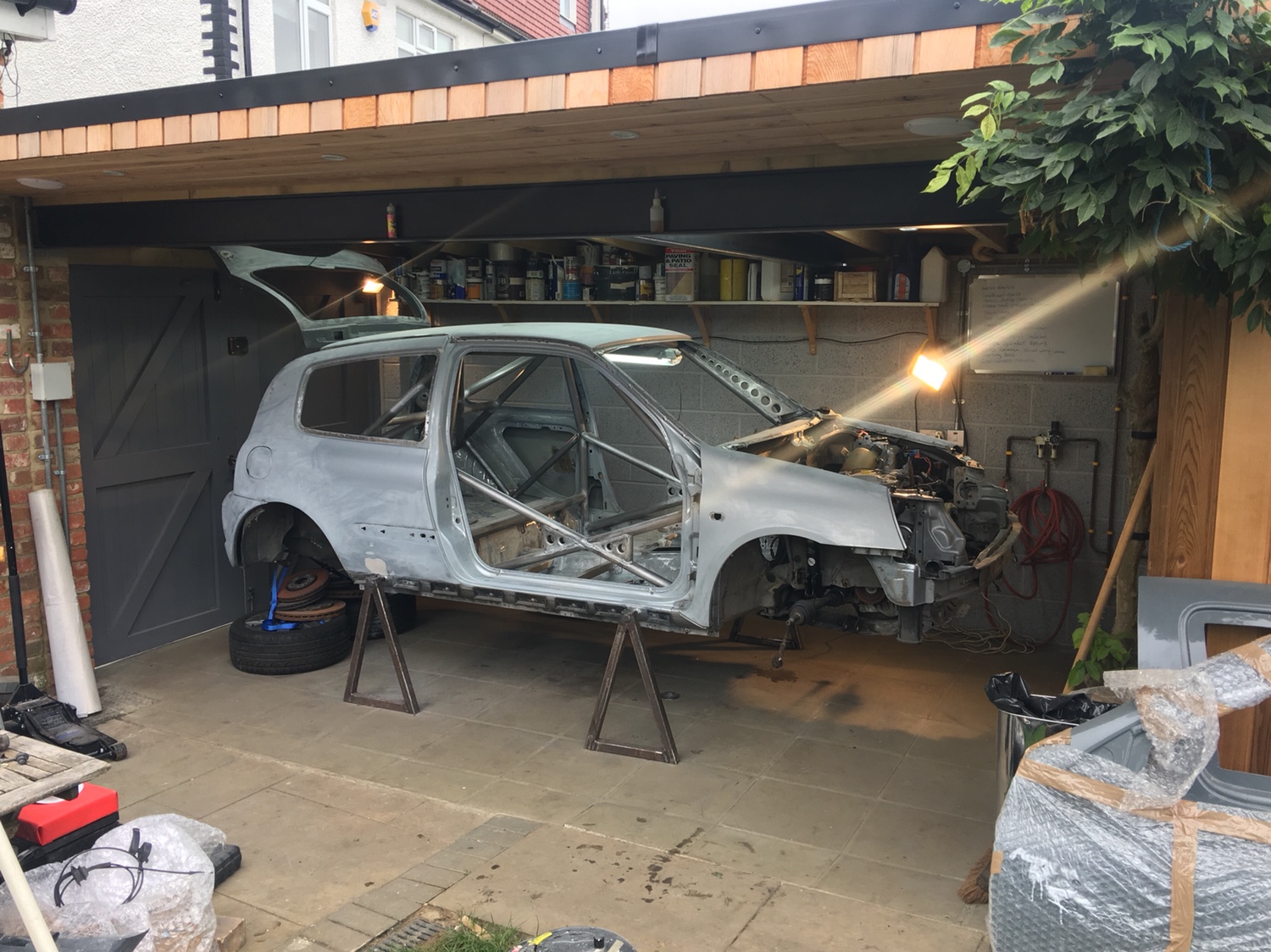

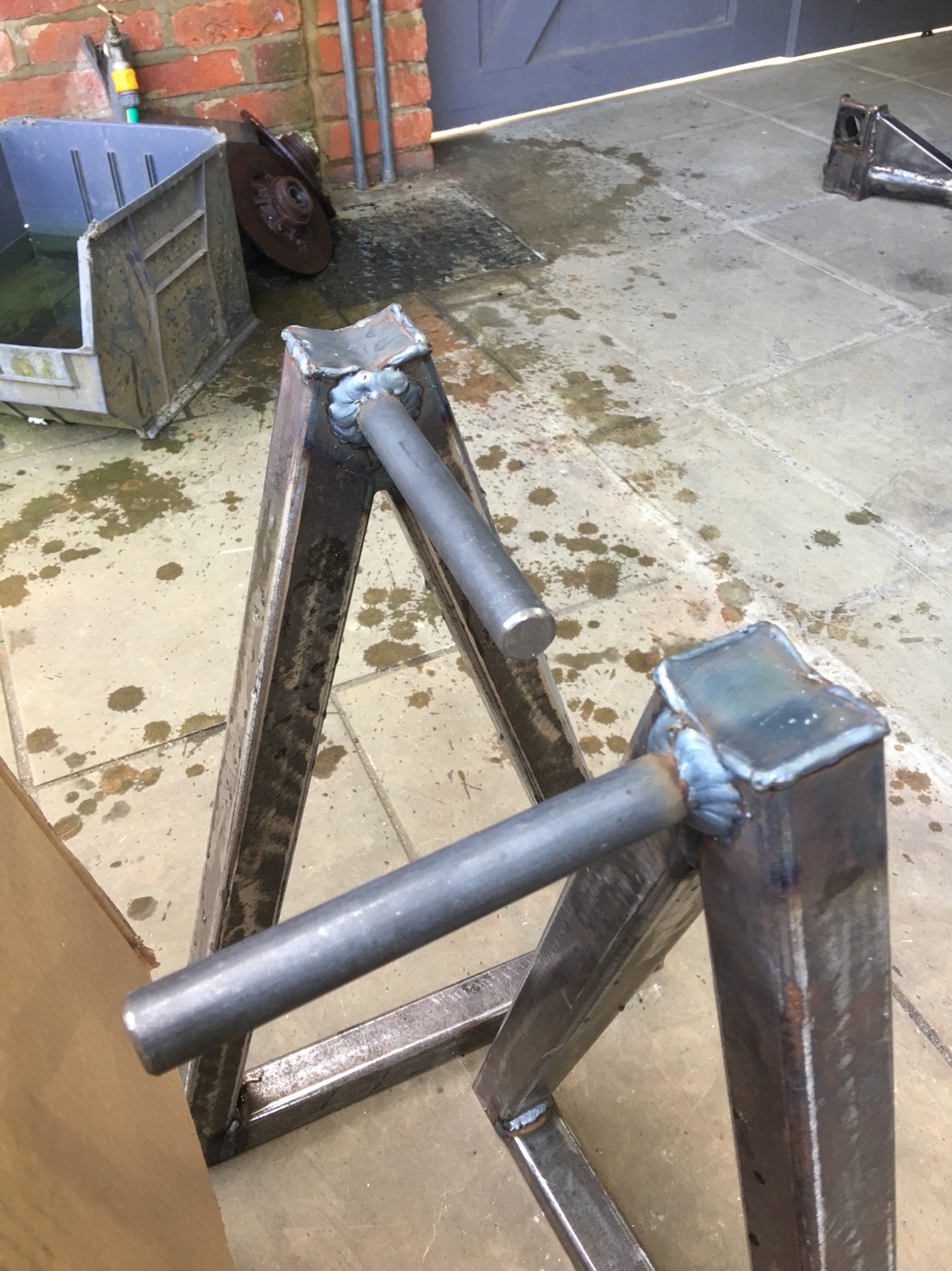

If you were to accidentally kick one of those out though, what would happen?
You can’t do it by accident. The pin is long. And underweight secures it. Needs to be lifted to take it out. We kinda tested it with a rubber mallet. Under weight it barely moves. Maybe 3-4mm at a time. So to slide 150mm of the pin there is a lot of “accidental” knocking needed. Unfortunately might not be the best solution for a daily lol
