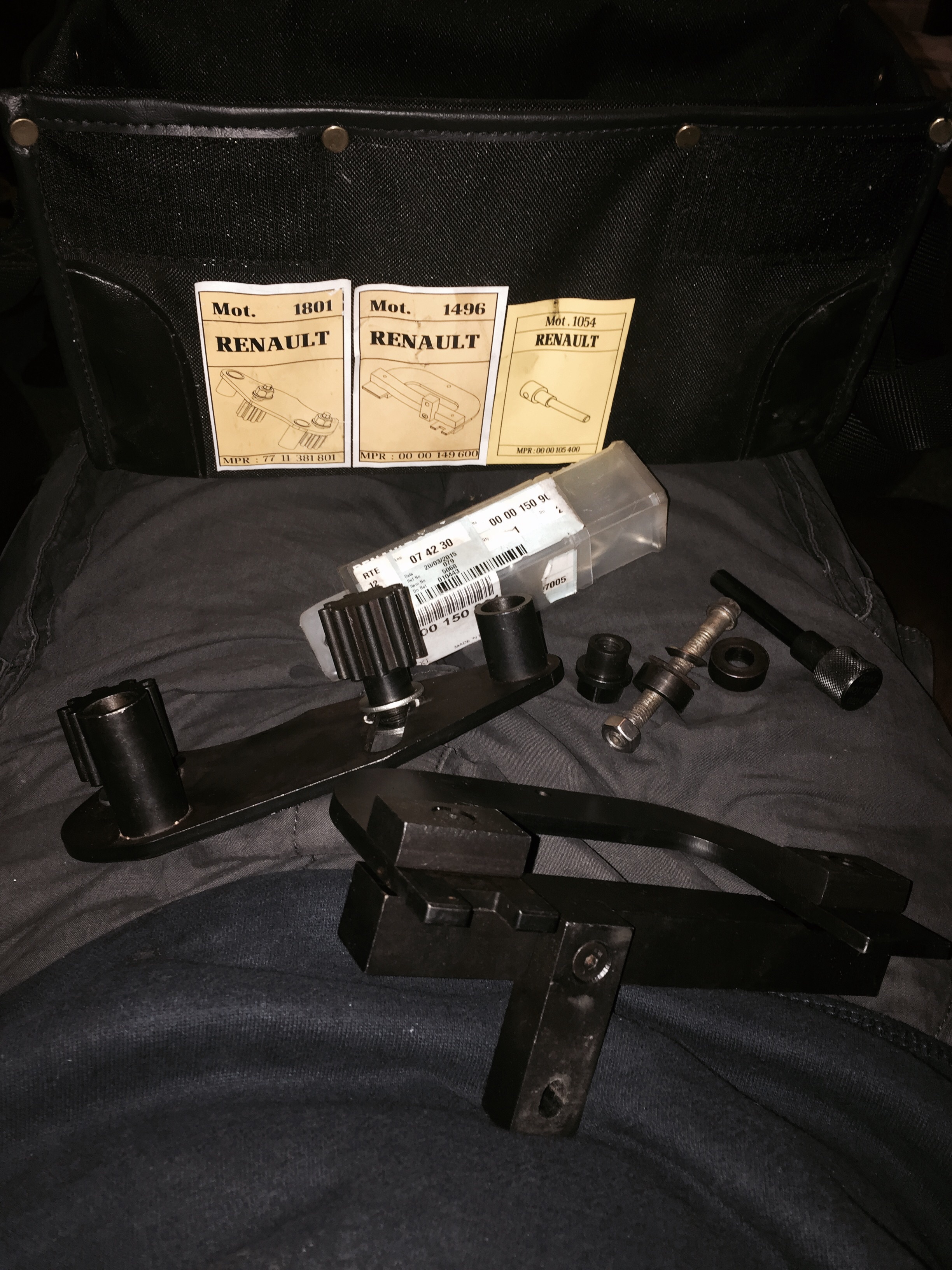

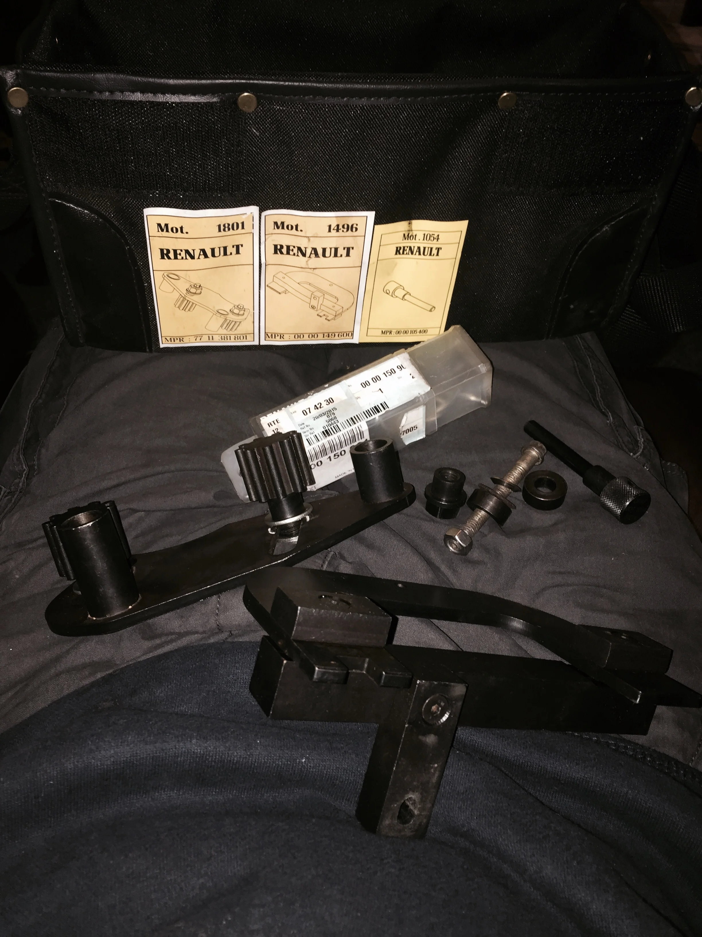

Yep, too much scaremongering about timing belt changes on here! It really isn't a complicated job with the right tools. That's the important bit - the right Renault tools. If you don't use the tools or buy cheap ones and the timing will be out.

  • The tools are not the cheapest, although one garage I almost went to claims the 1.6 Megane timing tools will do the job

locking pin is different, other than that the rest is the same.
If you do not mind me asking, how is the pin different? Does it engage with the crank too loosely etc? From @car.crash 's pics (although it is always hard to tell) the pin looks remarkably similar to that used in the larger Zetec engines timing ; I am happy to giving the dimensions of my timing pin for the Zetec.
Of course, one would still need the tools for the upper end...
Everyone on cliosport knows only BTM can set cam timing correctly on a 172 !
If what happened on mine was true from a very well known respected specialist (the timing was ever so slightly out) there may be some truth in that!
TBH I was going to give my Clio a go; I have changed a few before modern and old. I am no Jedi at engine work but it seems to be a logical process on a Clio. But the price of the tools and the hassle (i.e time on a driveway with variable weather!) of changing it made me send it BTM's way!
  dan's cast offs.
the k4m pin screws in to the block and fwir (been a long time since i did one) the pin goes in and the crank is turned until it hits against the pin whereas on the f4r the pin goes in to a timing hole in the crank. daftly enough there is a balancing drilling right next to it!!

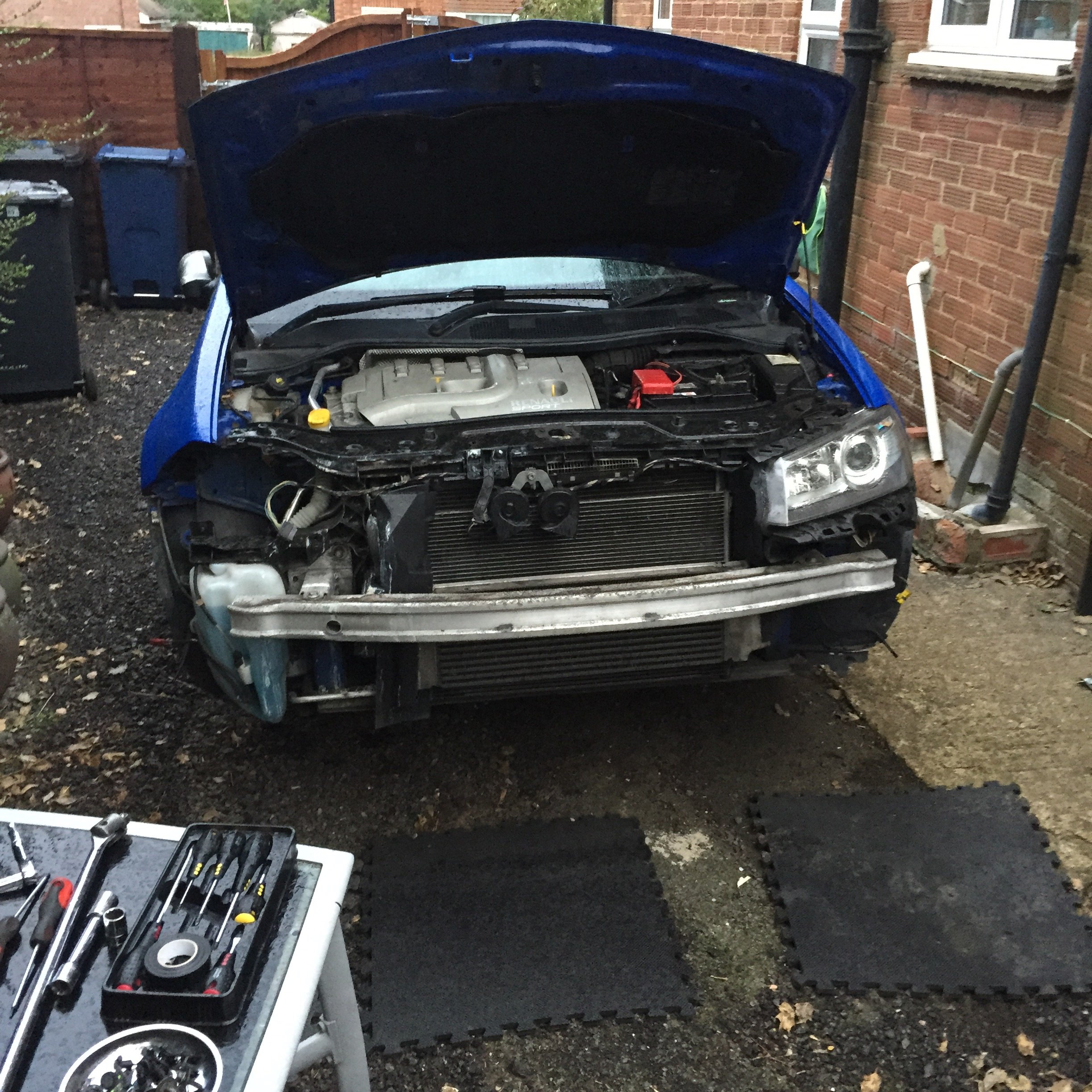

There's always been a lot of witchcraft surrounding cambelts on here , which isn't the case. Good luck with it , would be interested to see some pictures of the change if you get any.
  Clio 172
Cheers mate, I have a project thread which I'm keeping track of progress and I did think about adding a few photos to prove it isn't impossible. Thanks again
