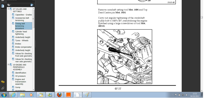

Heard about this this morning, didn't realise it was yours. I thought it was the crank pulley bolt not tightened/torqued properly from the conversation I had. Not uncommon for a charger install to highlight this when it's been "fine" upto that point. There's actually 2 published tightening torques/angles in the renault workshop manual, and I believe most of the time these have slipped the looser way has been used. I always use the tighter of the 2 settings, and I've not had any of the cars I've done a cambelt on that have subsequently had a charger fitted slip the pulley. There's an arguement for adding the megane sprocket to reduce the risk, but there's definitely an error in the manual too
  182/RS2/ Turbo/Mk1
If that bolt was the one undoing not the tensioner as previously stated, then the bottom line is that running a charger off such a poorly located pulley in the first place is a specification error TBH and always going to be a potential point of failure, and there is no way that renault would honour any issues with that car if it was taken to them anyway.

TDF did belt, torqued up normally, possibly to the looser of the two specific figures, as no charger on the engine.
You fitted a charger afterwards, and at the time didnt then increase the torque on the bolt to give it a better chance of survival (ie the higher setting Dan mentions)
Then it failed.
If I was TDF I would be amazed if someone pointed the finger at me in those circumstances TBH, you did the charger install, and its almost certainly as a result of that extra strain the bolt undid.
Did whoever you got the charger off explain to you that it puts a lot of strain on the pulley and that you should check the pulley torque as a matter of course when doing that sort of thing?
Not that its their responsibility TBH, if you werent aware of the implications then it shouldnt have been you doing the work, it should have been someone who knows about such things and hence would have made sure that bolt was really well torqued up.
Sorry if it sounds harsh, I really feel sorry for you that it happened and I am glad you are sticking with it not giving up and I hope it all goes well with the rebuild, but ultimately this is just one of those times when you learn from your own mistakes IMHO

I think Dan said there were two possible torque levels, one higher and one lower, both potentially correct. He always torques his up to the higher one so perhaps if yours was torqued to the lower one (still correct according to the book) then that is why it could have failed.
