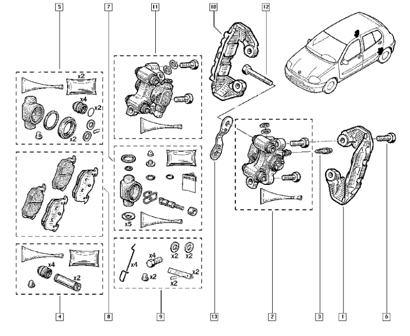

from what i can make out in the picture it's number 3, part number 77 01 071 172:

Thanks Maynard! I'm guessing they are the same on the front?
Any chance of a part number for number 6 there? Probably the same on the front those bolts as well.

don't buy them from renault there £12 each :eek: go to a motor factors and get the peugeot/renault ones for £0.50 each:approve: there are only a couple of sizes can't remember off hand

Number 6 is 77 01 025 057 priced at £1.63.
And yeah, it's the same for front and rear.
