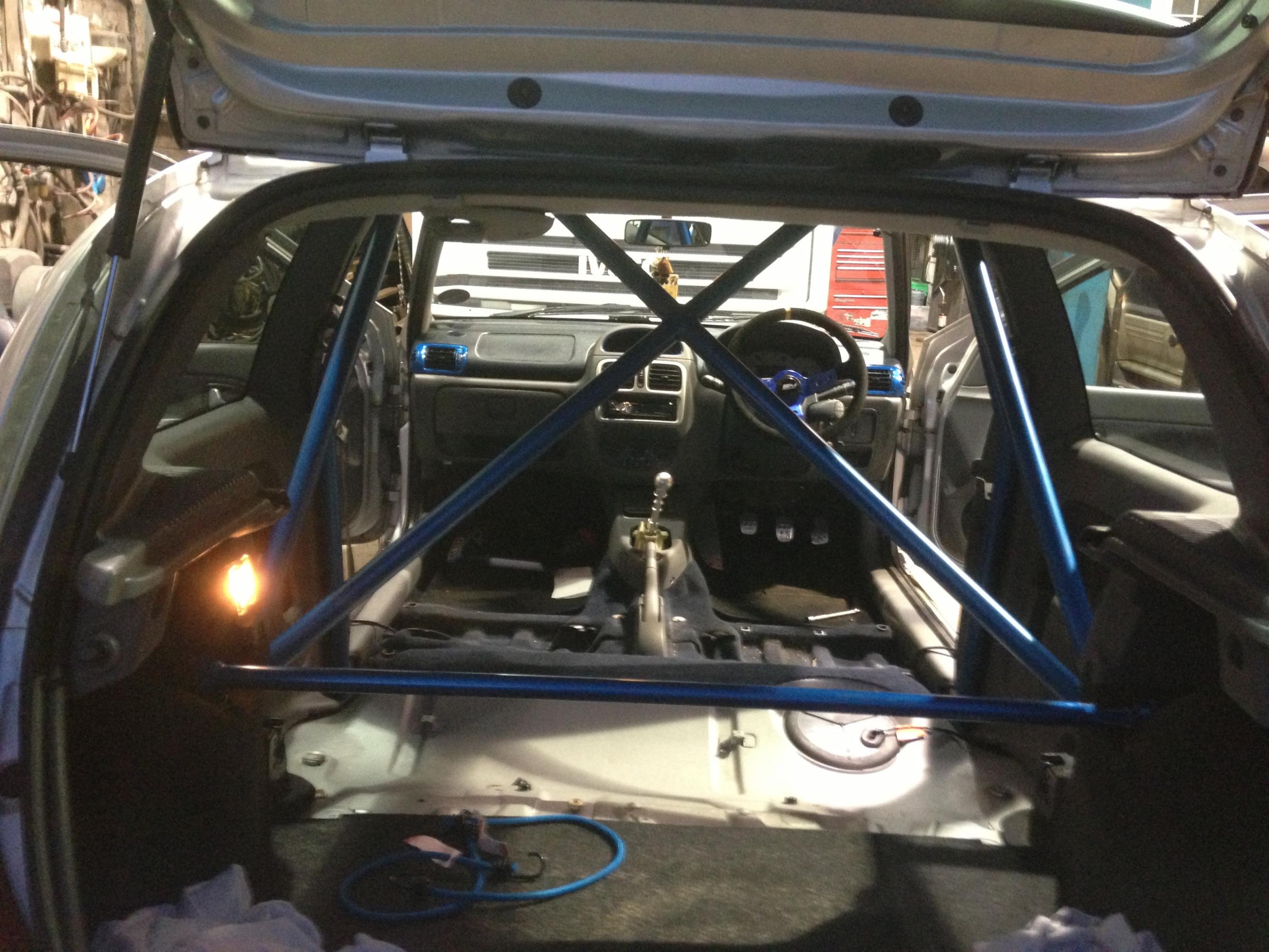

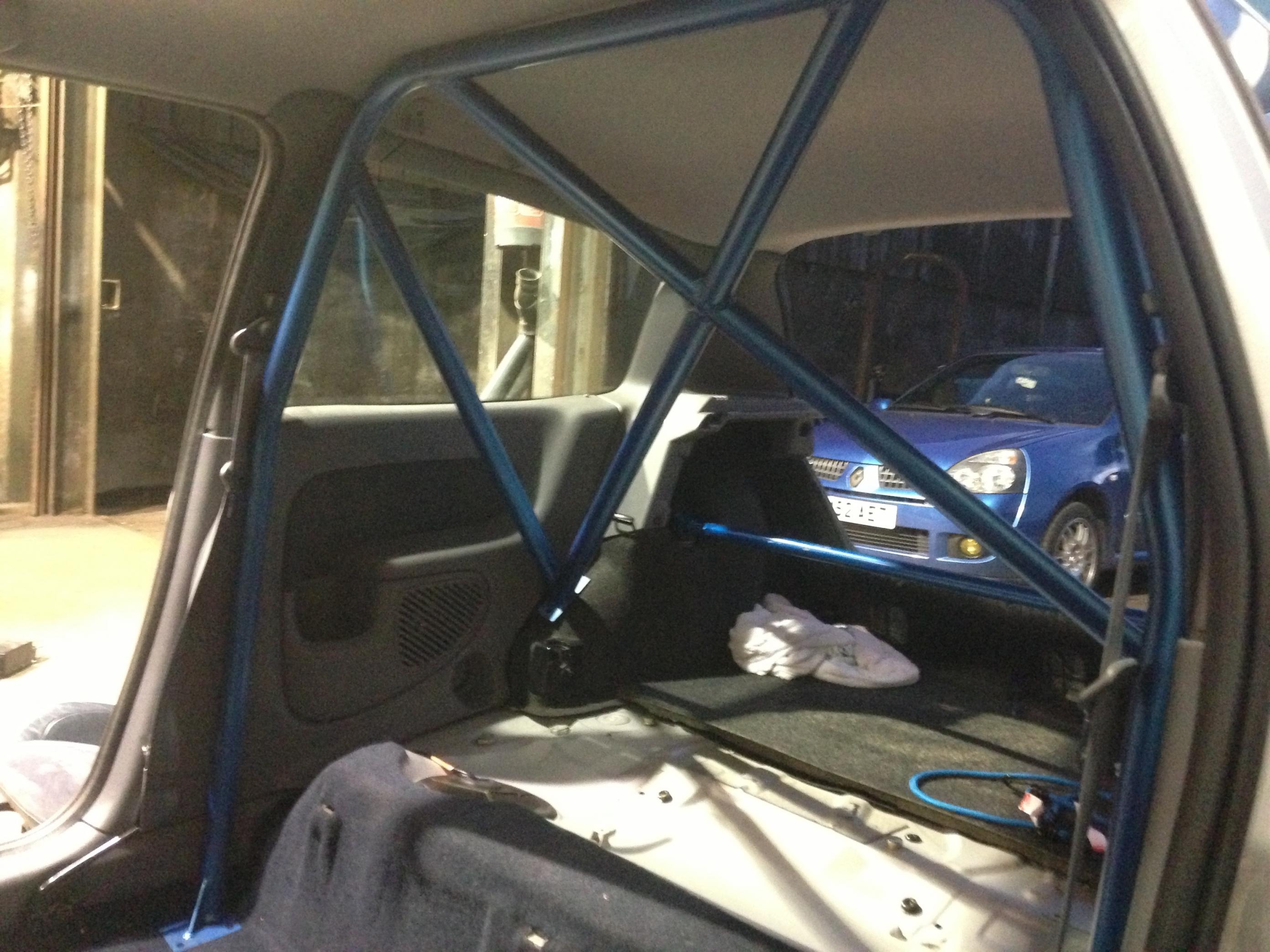

I've got one of them ebay 150 quid cages its surprisingly really good it fitted perfect all the angles are sound as.... I'm not competing in my car I just wanted something for the odd track day etc etc and for the money it was excellent.... Now I prepare my self to get slated for saying this lol

It's steel don't know what grade but its not bad atall for the money the floor mountings are ideal It's m10 holes... I drilled 10mm holes " the only part not included that I made were some brackets for the underside of the car" I used an oxyacetylene torch and cut 4 brackets out of 5mm thick steel to mount to the bottom of the car to spread the load of the cage " didn't have to but I chose too " I covered the holes in tiger seal and used m10 bolts and ni lock nuts with a washer unsure on washer size as was just in a box of crap in the workshop ...... Tbh I like it it's decent and well worth the 168 delivered ...... Like I said I don't compete or anything so for me it's perfect

Sorry just seen Sams post ... The mounting issue wasn't too bad the foot plates were angled and sat nice and flush really was impressed and the holes are m10 so a little wider but yeh the idea of this one was big washers and a pissy nut that's why I decided to make under car plates for the money though I'd say good value for money good product :)
  Clio 172 phase 1
It was here within a week which was awsome 7-10 days he said it would take was here in 5 ..... No rattles atall I used tigerseal in the holes to eliminate water n all that really goodbye I won't be disappointed needs 2 people to fit it though lol was a bit of a pain to get in the car but once uve sussed it it's easy

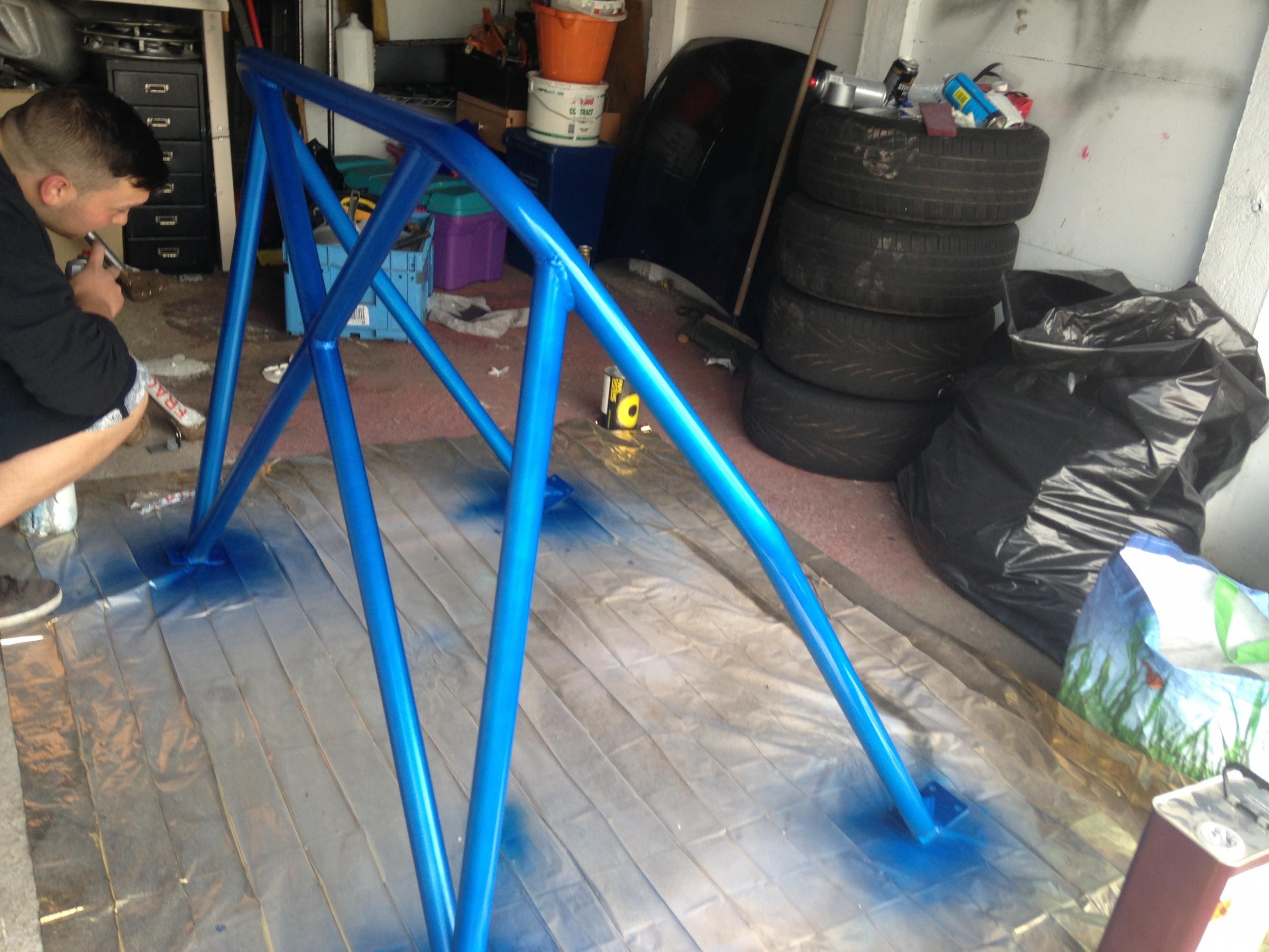

Sound, ill be spraying mine before I fit it anyway but it's looking like ill be ordering one of these badboys later :)
  Clio 172 phase 1
I've got the rear cross and I've painted it mg trophy blue with a pearl over the top looks nice fitted :)
