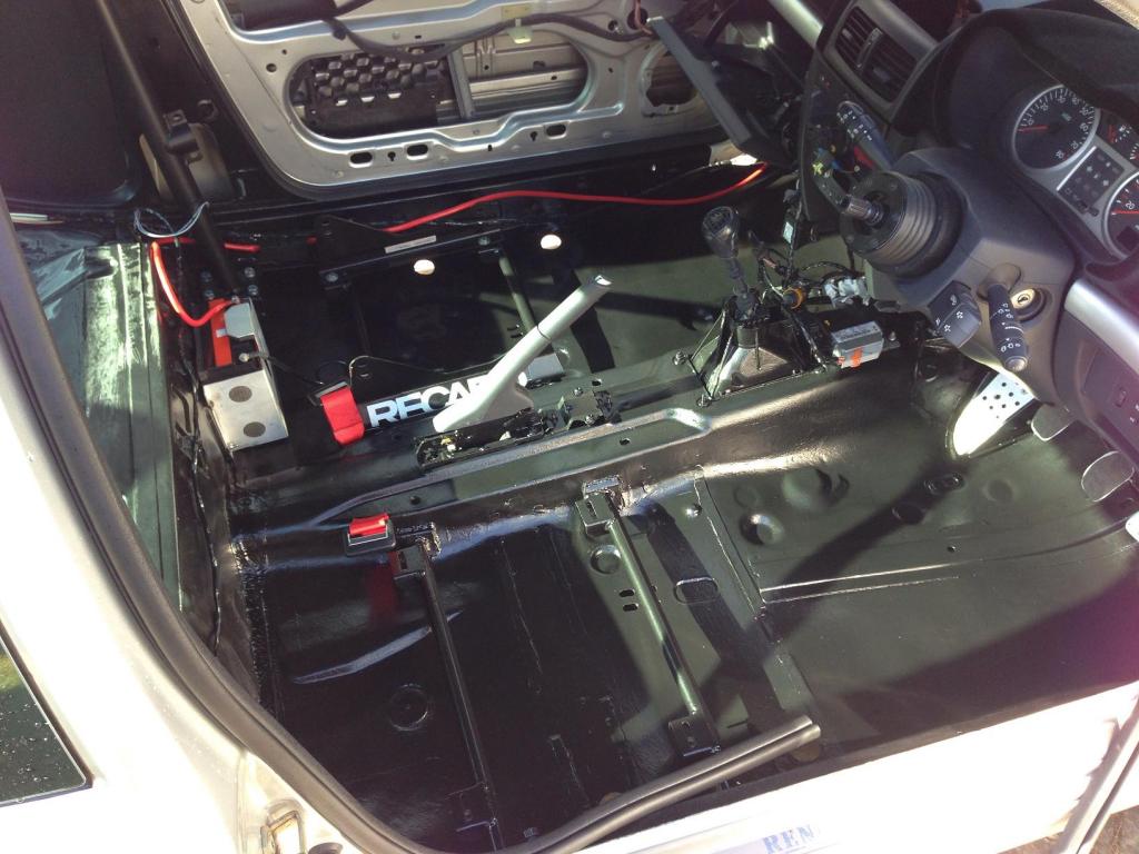

I've got my battery behind my seat, but the power cable runs to the center console for a cut off switch, so for example.. copying my cable length would be no use to you. (unless you were doing the same).
The earth/black/negative wire just needs to be as long as the position to the nearest earth. Mine is about 7 inches. But again, you should string it so you know for sure how long you need for where you want to put your battery and route your cables.

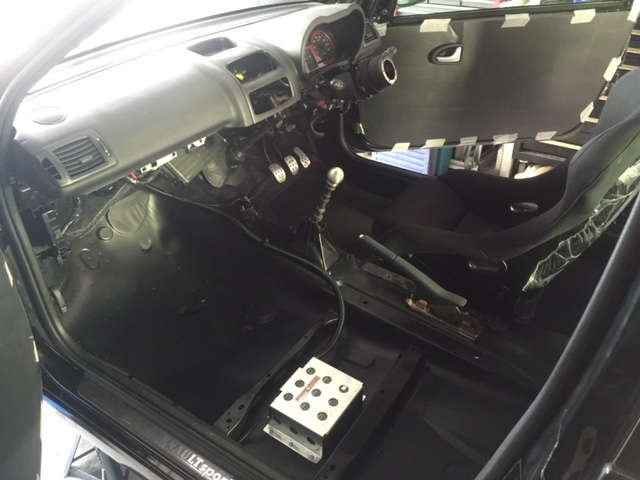

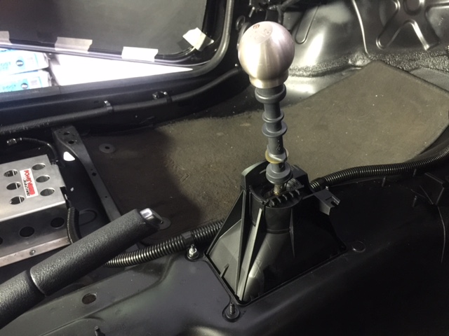

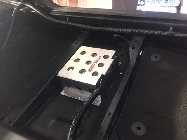

there i found this
Also the route of the read battery cable is Looks fine for me. Also the Location of the battery. But without the disconnector Switch.
