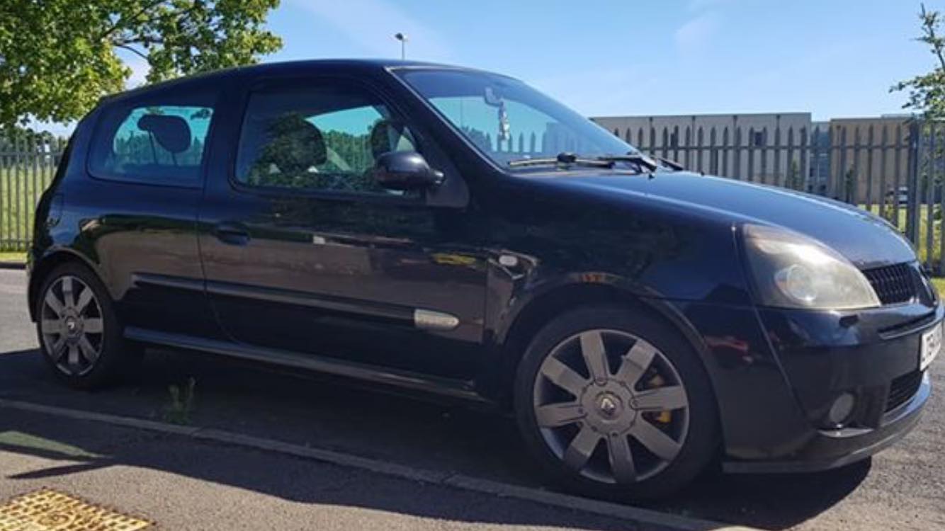

Got myself this 182 and can't decide wether to do bucket seats and strip interior or cooksport springs and braided hoses, i have a budget of about £850

  Mk5 Golf GTI :)
Tyres
Brakes
Shocks
Lowering springs
Service
Check stuff isn’t falling off
Cambelt done?
Induction kit
Exhaust maybe
Re map.
Rest if any on fuel
  MK7 Golf R, Clio 182
Take it you want to do track days?
Brakes and tyres will make the biggest immediate difference I think.
If your on a really tight budget talk to @George@RTR_Parts about the brakes. Probably hc front disks and ds2500/3000 pads, Leave the rears standard, braided lines and replace the fluid with performance stuff. I use ATE stuff which is cheap as chips and I hammer my car and don't have a problem.
You can find some decent second hand tyres very cheap on here/eBay etc. Be warned about track tyres on the road though. Doesn't take much to make them illegal and some are lethal in the wet. There are some that are half way between the two though.
Other than that make sure your filters and fluids are all good. General maintenance is kept up and go and have a blast.

Do a track day as is.
See how you get on.
Buy some tuition.

Stripping the car will make the sq.rt of FA difference apart to your hearing / sanity, on a normal track day.

Cant go wrong with a set of standard brembo front high carbon discs and some PBS pads! A relatively cheap set up compared to what you could spend on braking, will make a hell of a difference too!
