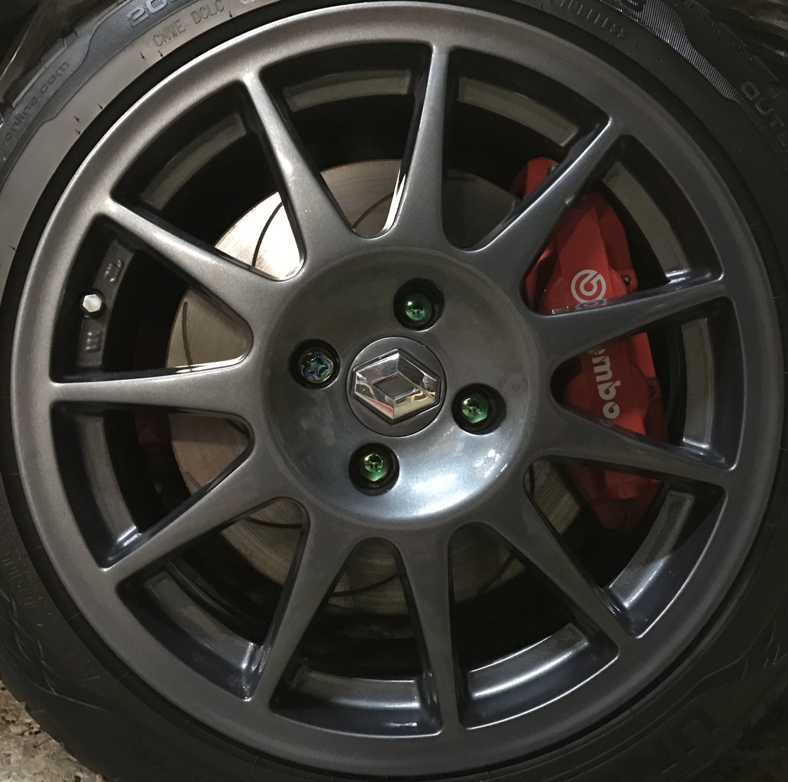

What size discs are you planning to use? They say they are for 300mm disc's which is fine, but if you're planning on using 280mm you can't use those brackets. Nobody has machined 10mm off a brembo caliper because the internal cavity size of the caliper is unknown, and milling a hole into it wouldn't be a good idea! For 280mm discs you need 5mm off the caliper and bracket mounting faces.
Also there was a batch made on here a while ago out of 7xxx aluminium and although its strong it doesn't resist corrosion well. See https://www.cliosport.net/threads/failed-brembo-brackets.824410/.

I've sent all I have made out for coating. I'm not sure if they are all spoken for atm. I'll probably do some more but they won't be for a couple of months. If your sticking with 300 discs then the pure brackets are spot on?.
  406 V6, Race Buggy
Ouch, yes, don't use 7075 where crevice corrosion is likely! At least anodise it...
6082 is far better suited for long term use where a couple of grams don't matter (and a caliper bracket is mainly about stiffness rather than strength anyway)

I'd rather have the pms ones. I don't see any reason to make them like that for 300 discs. Steel ones have plenty of thread to screw into, no need for studs. Hopefully they are better made then their Clio inlets too!

You still need to be careful with the 300mm conversion if the Turinis have wheel weights as iv recently found out with the PMS bracket.

Yeah there's not much air between the wheel and caliper. Using hex head bolts instead of cap heads gives you a few more mm clearance but probably still not enough for wheel weights.

PMS are on another level and are a good bit of kit, A very good bit of kit for 300mm discs
Im running 16" Cup Turnin's and I have had no issues or problems. All I done was get the wheels balanced on the inside edge away from the calliper.
