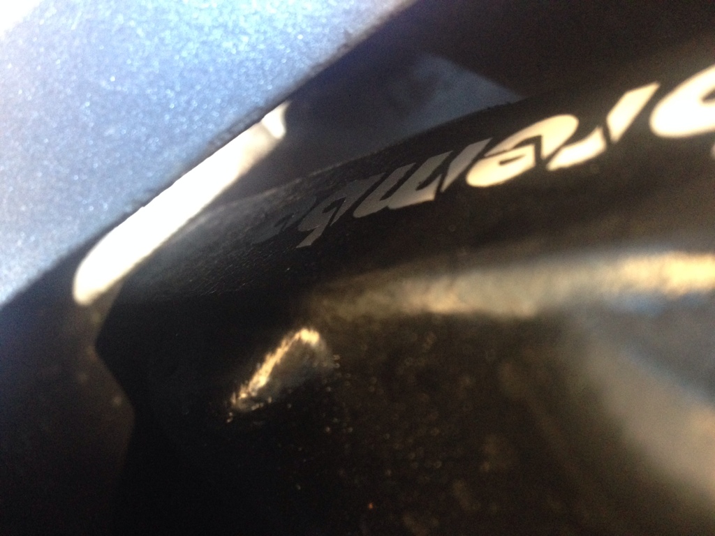

Spacers will be needed I think, circa 5mm. I haven't tried it with 182 alloys, but with 16" 172 alloys and 16mm spacers this is the gap;
