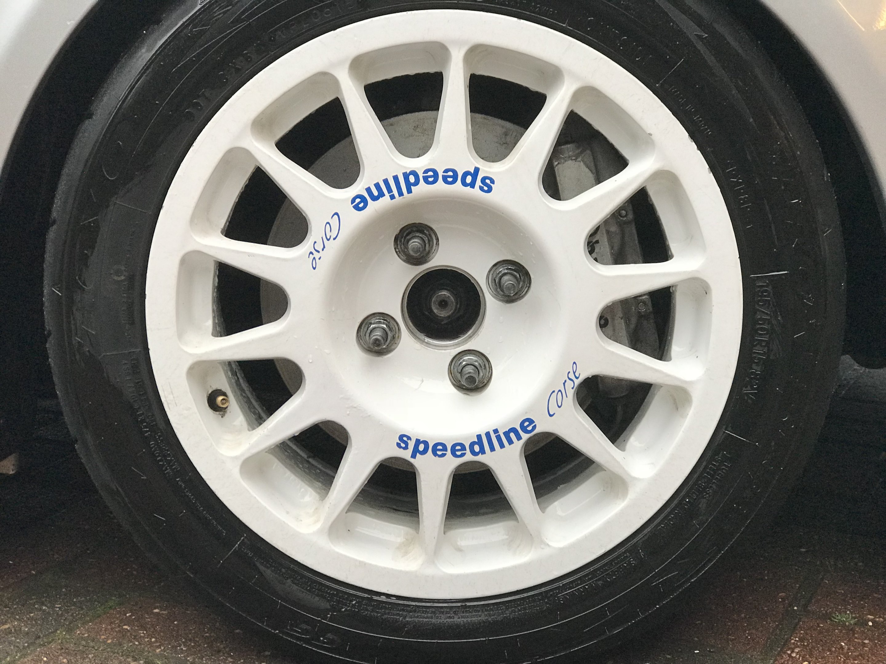

Am in the middle of getting myself The parts to fit 197 brembos on my 182 turbo which is running 15” 2118 and the 280mm discs. My question is what size spacers are needed and how much needs milling off the callipers to fit ?

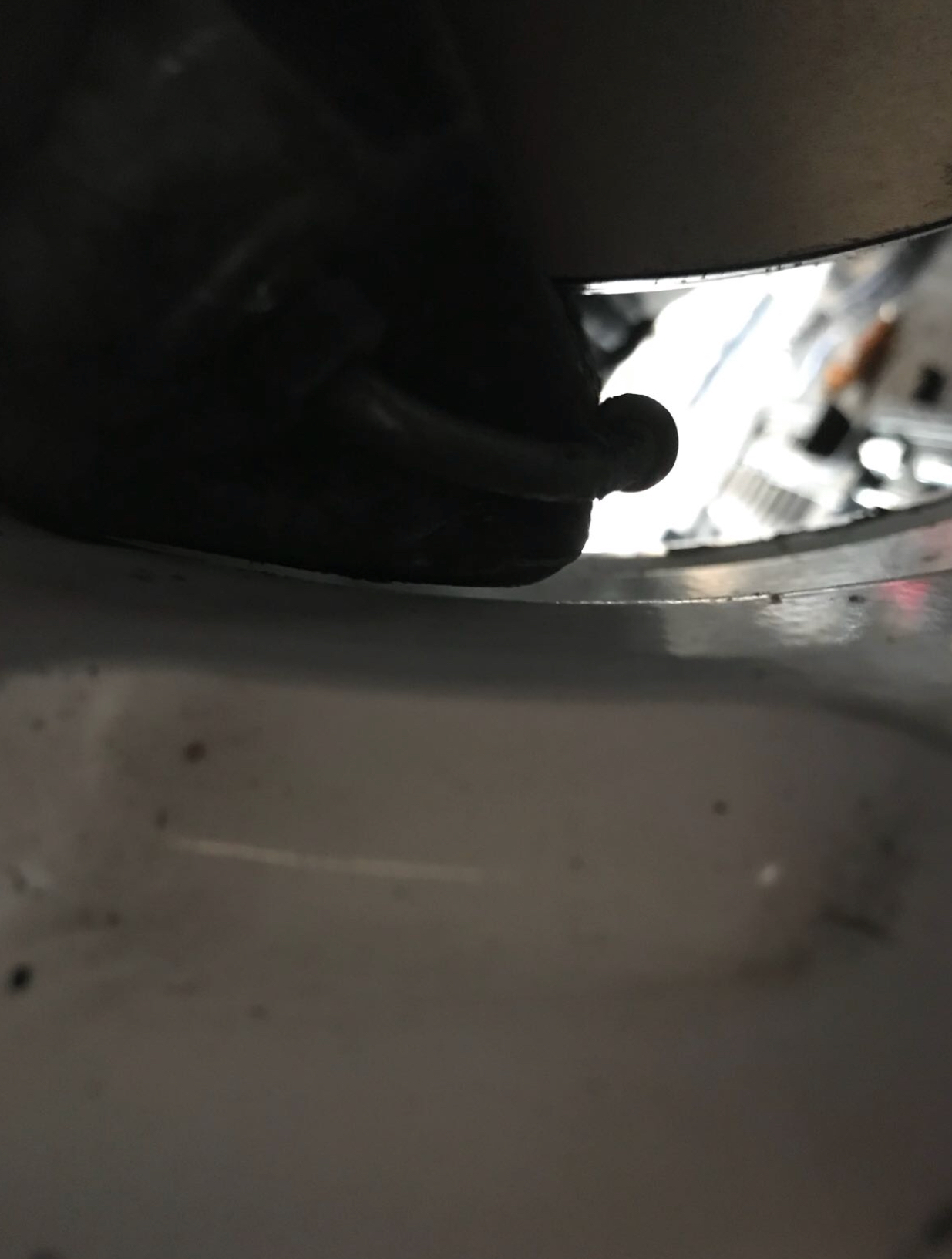

Just done this and it’s been a pain in the arse! In the end I had to have 7mm removed from the callipers and run a 20mm spacer. The bit I can’t remember is what offset the wheels are?!
It’s so tight it’s untrue. Any wheel weights have to be at the back of the wheel or else they hit the calliper.
