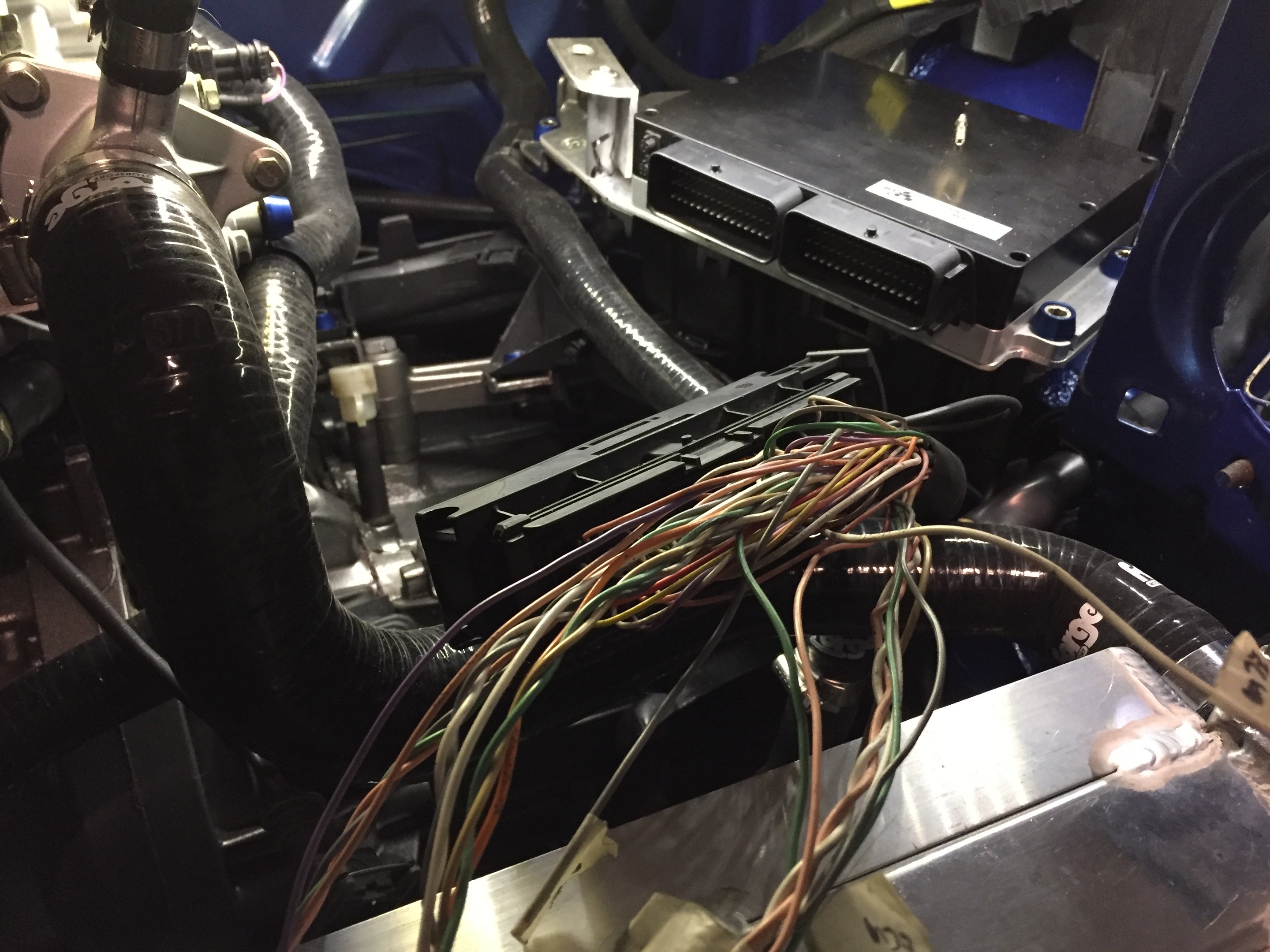

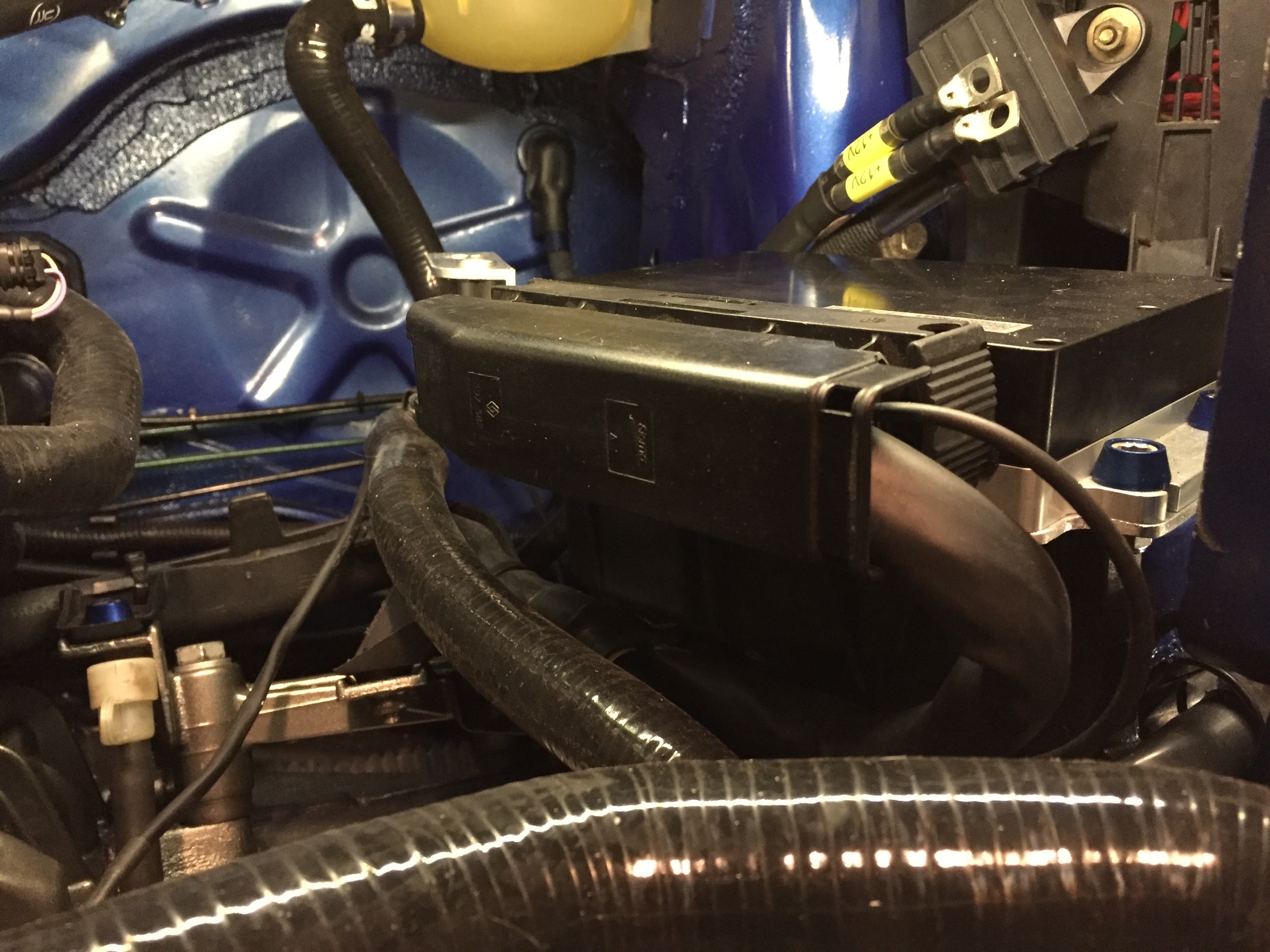

Had an hour spare this afternoon so I thought I'd do a bit more. Decided to be like this guy:
The end result was this:
As you can see still a few wires to shorten/add terminals to, but I think there's only about 10 or so left. Then the loom is finished. Another job ticked off the list!!

Nice neat work with the wires :up:
