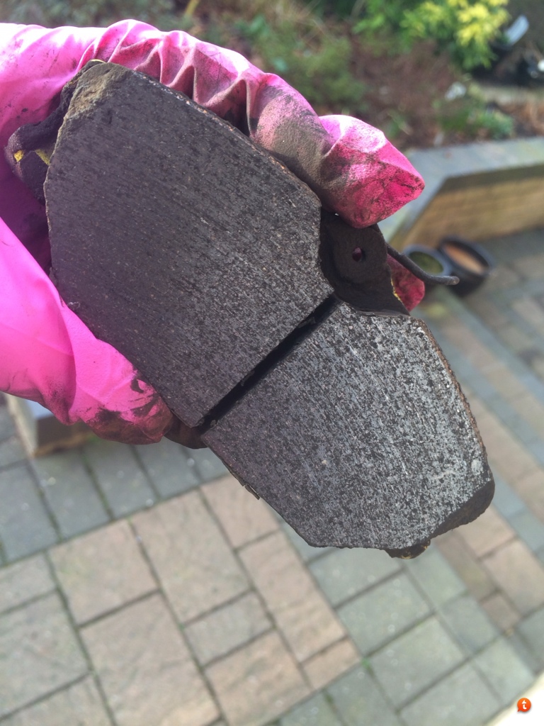

Here is a pic of the pad surface should new pads do the trick?
There yellow stuff pads btw

I mentioned mine went through a noisey phase at around a few hundred miles, but that passed quickly. If its both sides and you've done more than 1k on them and they're still noisey there's no harm in trying to rough up the pads with a little (light) sanding but I've only ever had to do this with overheated/glazed cheapo pads on my crappy-er cars. EBC's come with a bevelled leading and trailing edge anyhow, your look they they still have some of this but the pads are clearly worn down a bit. ???

Looking at the crumbling on the pads they have had a hard time and fit tight ,

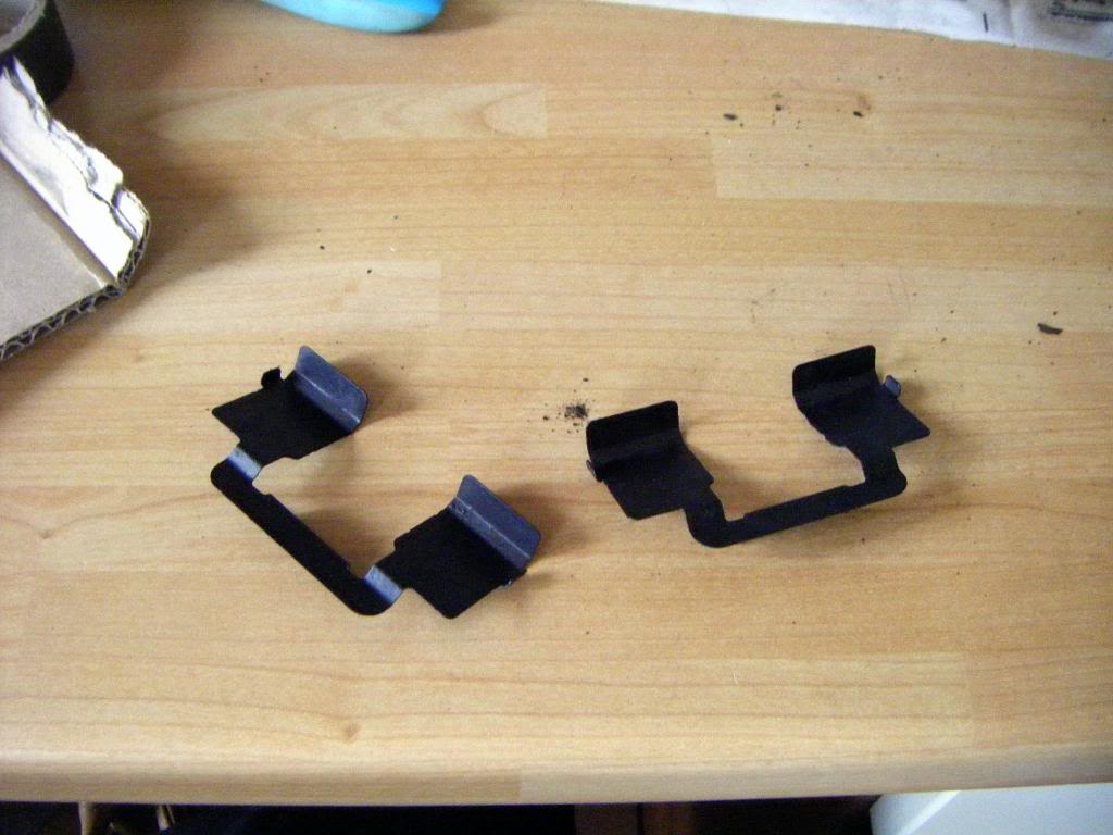

This is what I'm on about. (credit to Benny06 for the photo). They are refered to as anti-rattle shims. Problem with them is that dust and corrosion builds up between them and the caliper where they clip into place. This makes evrything a tighter fit than it needs to be - pads get tight in the caliper and can't slide freely. Probelm is that to clean everything properly as harv and i have suggested means you need to remove these metal shims. I, and quite a few others on here, have found that the brakes work better without them alltogether, especially with aftermarket pads which are sometimes a little oversized in the first place. It might not be the reason yours are noisey but worth a try because they shouldn't be tight like you describe. If you can get everything clean and your shims are OK to fit back into place then doing that you might find the pads are much free-er, but its often hard to prise the shims out without bending them, or they are just too corroded to be worth refitting. Like I said, new (good quality) OE pads come with new shims. So unless you get new OE pads, just take the shims out and make sure everything is clean.
