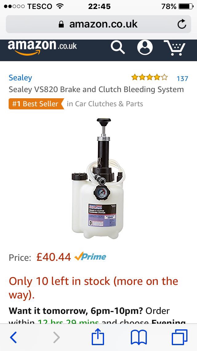

Got one of these recently , works wonders

Tried a vacuum bleed this morning and that did not work so went and brought a ezebleed kit (the valve fitting is s**t kept leaking so chopped it off and connected to my compressor set at about 18psi) pumped about 1l through and got a reasonable pedal but when the engine is running the braking is right at the bottom, so tried the old fashion way and still the same.
