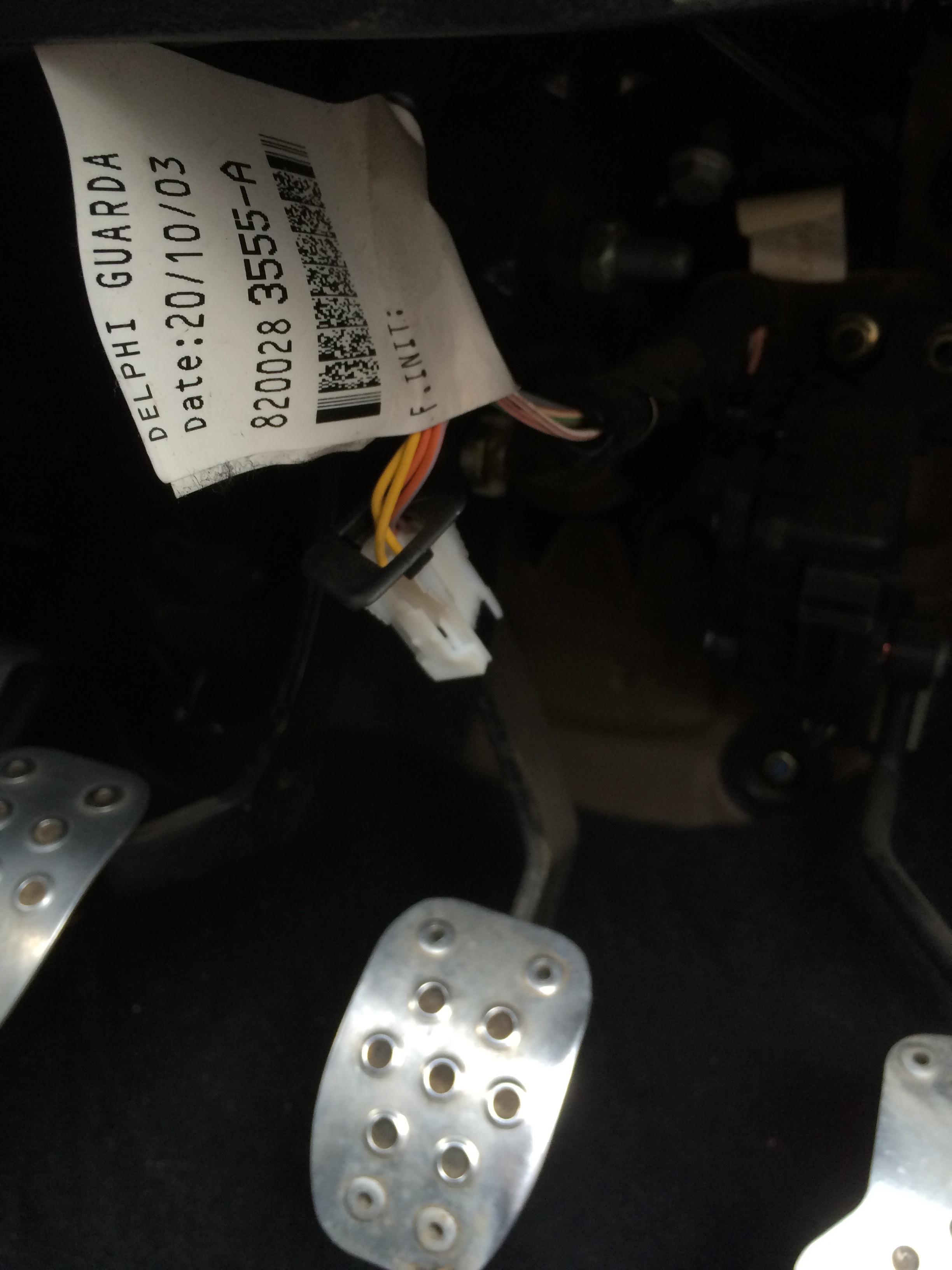

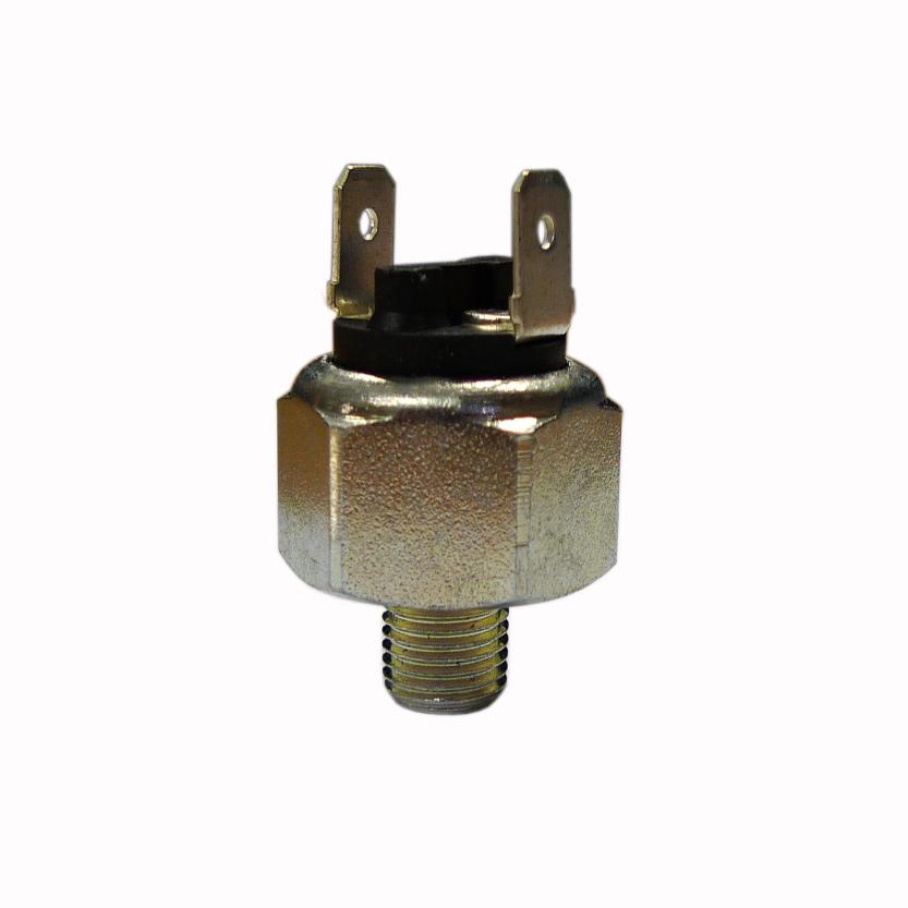

I'm looking to wire a brake light switch into my pedal box and currently have this type:
I still have the connector and wiring for the original brake light switch but it has 4 wires:
Does anyone know what each of the 4 wires is? Can I wire my new brake light switch into those?

Hi mate, would you leave the other wires in the connector and just cut and splice the ones for the switch?
