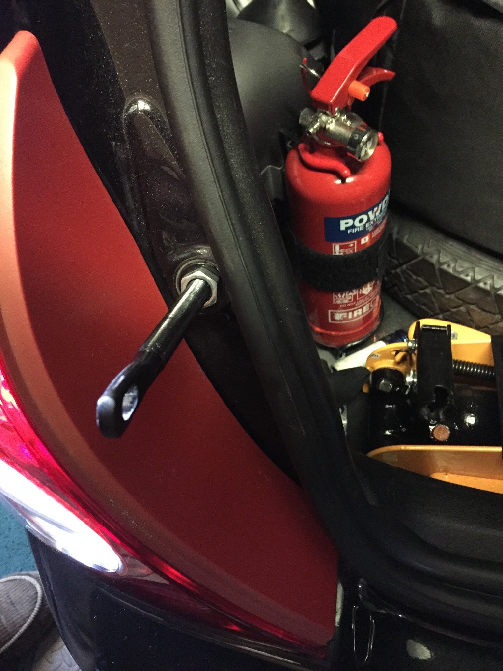

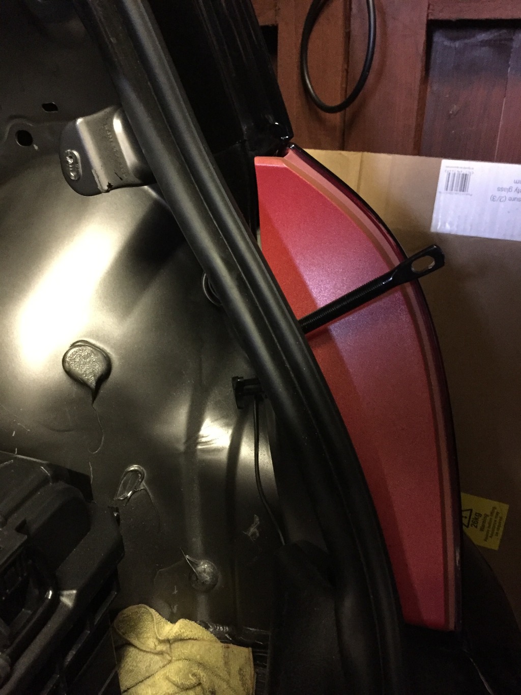

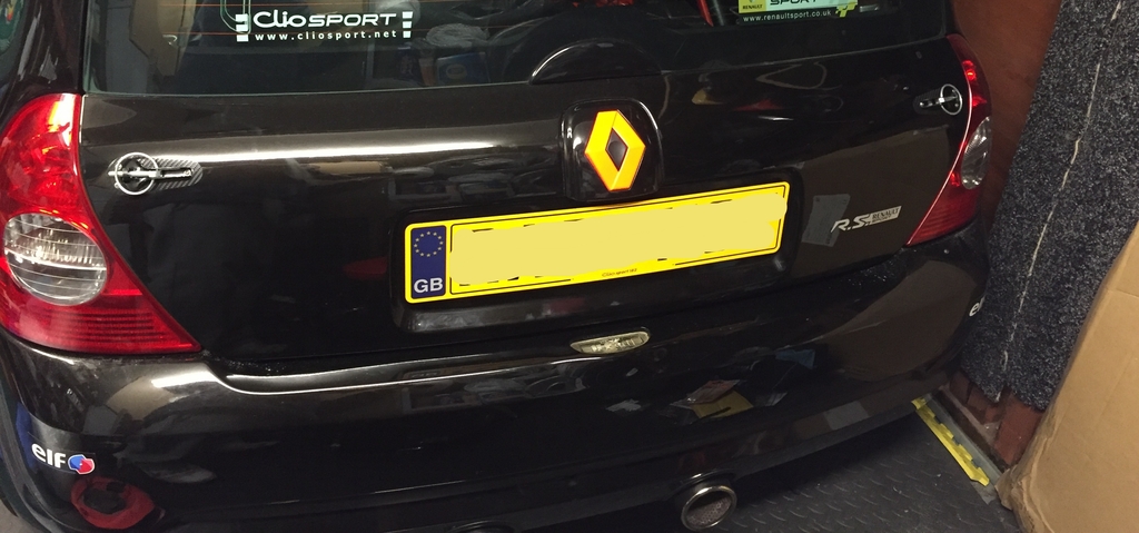

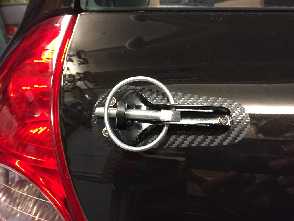

As my boot would knock when going over bumps I decided to fit some pins.
I have had them for about 4 months but finally got round to fitting them today, I cut some carbon vinyl out to put under the latch to stop it scratching the paint and used stainless bolts instead of rivets, not bad for £5 just need some rubber edging trim and some rubber stops to finish it inside.

Have you picks of where you have mounted them inside the boot.
  172 Ph1
Lovely jubbly looks like a good place to put them - have you put any kind of sealer around the locking nut that may let water in ?

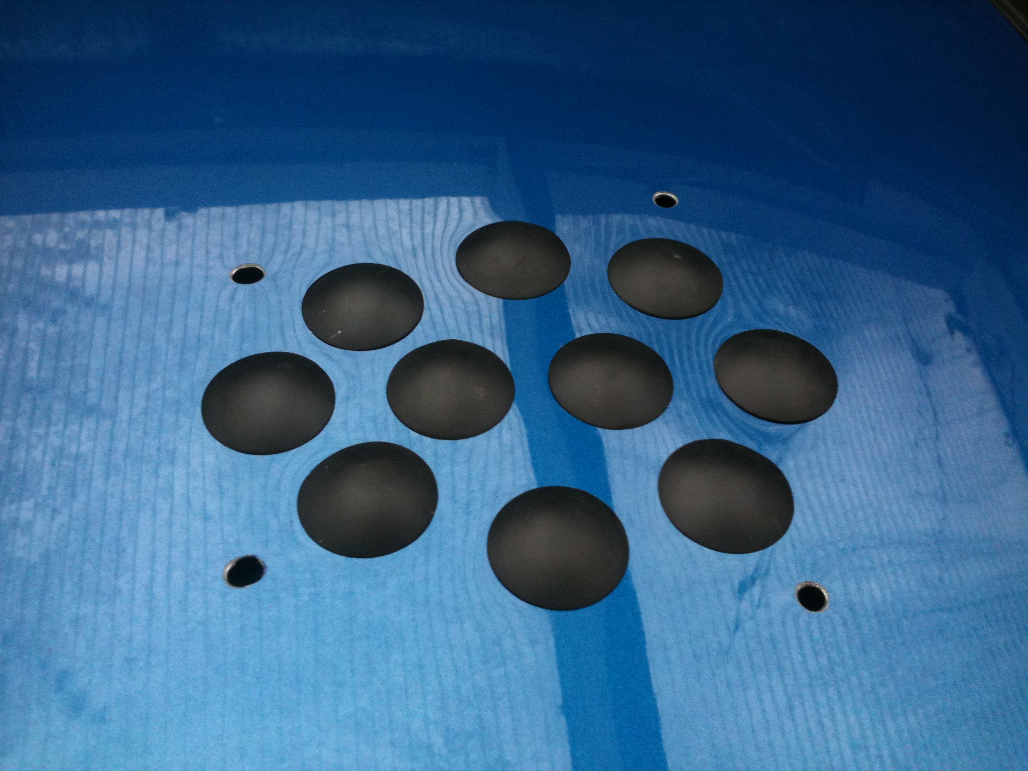

Ah I see what you mean now , Christ is my eye sight that bad I thought I was looking at holes lol . Now I see the rubber bungs .
So in summer they are removed , and in winter they are plugged .

Yeah that's it mate, or when your on your way to spa for your stag do to watch a bit of f1 and it's absolutely howling down with rain!! I was cold, wet and extremely pissed off! Lol

Oh sweet Jesus Mark , I bet you were cursing that scoop . Was it a case of you didn't think it would leak , and when it rained it poured in.
Those grommets are a decent edition to the scoop and keeping it sealed in winter a very good shout .

We got caught out by the weather mate completely. It was bone dry in the uk so I didn't put the grommets in. Not the same story when we were over there though! Lol! The water collected in the bottom section of the vent as, so when you went round a corner you got soaked in cold water!!
Yeah the holes don't impede the airflow into the car either, so a very good idea of mine at the time! Lol!
