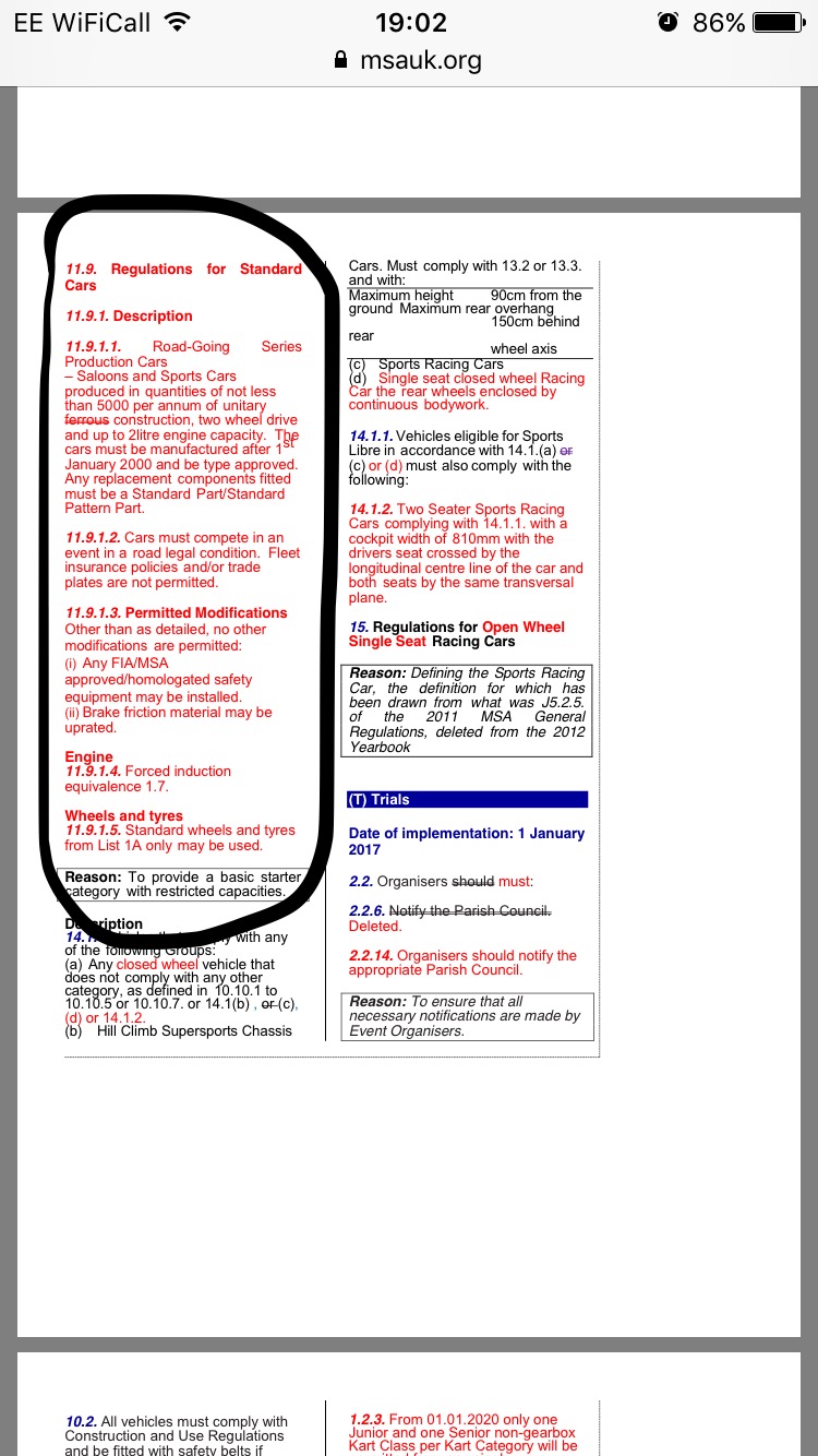

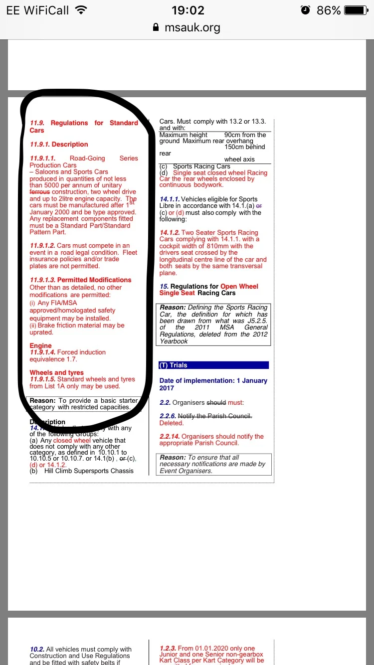

The confusion for me just now is with regards to the circled part below.
It mentions regulations for standard cars, and then goes on to mention road going series production cars, which for myself and Calum is currently A2 (up to 2000cc) and has quite a wide range of modifications permitted and also list 1b tyres.
So is the changes below with regards to tyres and modifications for standard cars (is there even a class titled this?) or for road going series production

From what I can see, the only changes to the Sprint and Hillclimb section relate to the Standard Car class so road going series production won't change.

Correct .... no changes to road going series production. The pdf issued by the MSA mainly covers the Blue Book changes for the introduction of the new 'Standard' category.
It's very confusing because the pdf only shows the sections that have changed. ... The sections that have not changed are not shown.
The MSA Tyre Lists (list 1a, 1b and 1c) have not been published yet ... so hold fire if you need new tyres for 2017.
@GrahamV182 is correct. The new standard class allows for no modifications to the car beyond those associated with fia approved safety. It also has the new 1.7x turbo multiplier that is not applied in road going(A1,2,3,4) and other classes. If you lower it, change the exhaust, change induction etc etc you have to move to the A class oh and it can only use 1a tyres.

11.9 is an additional class for Standard Cars (5000 plus produced per year) - there don't appear to be any changes to regs for Roadgoing Series Production Cars and Roadgoing Specialist Production Cars apart from mentions of the Standard Car Class.

11.9 is for the new Standard Class, not Road-Going Series Production Cars (the usual A1, A2 etc).
