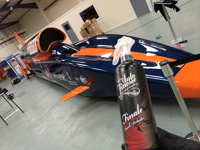

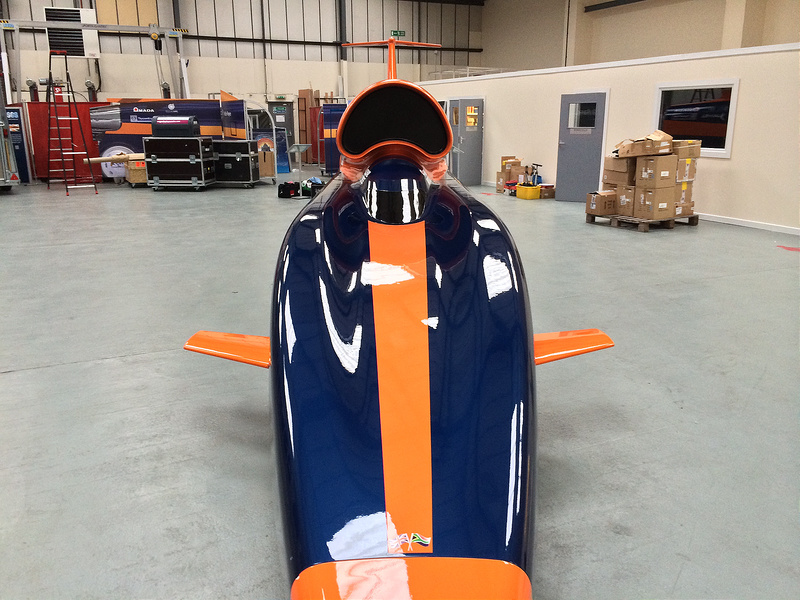

On to the detail, the brief was to get the car looking it's best within a day, so I aimed to correct the front end, removing all swirls and scratches picked up from shows and transport, followed by spot corrections along the hull of the car.
A few before's of the car -

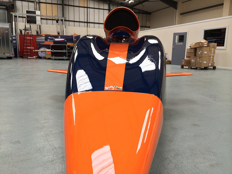

After a quick Finale wipedown I began on the front end of the car, correction beginning with the Rupes Bigfoot system. A few of the 50/50's below!
Working round the front end.

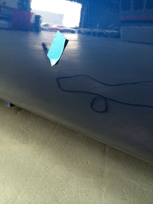

A few other marks removed.

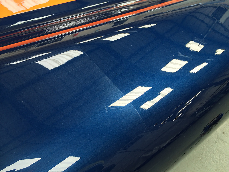

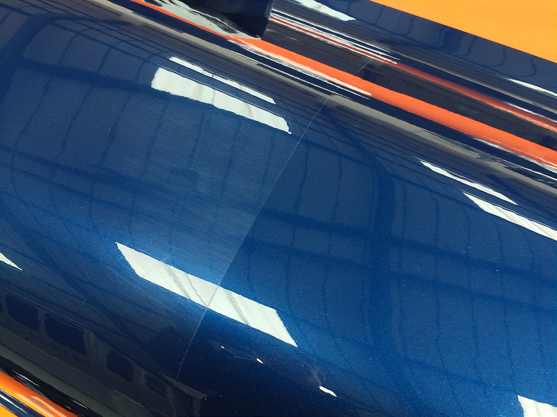

Before
After

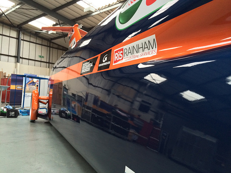

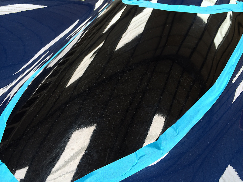

The entire body was then given a going over with Auto Finesse Tripple on a black pad, to add some protection and shine after a deep clean.

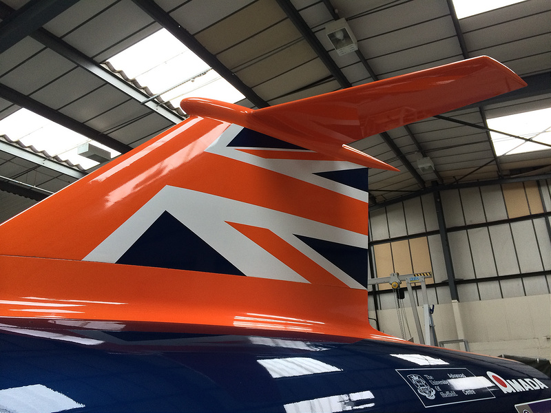

A step ladder was needed to get up to the roof fin!

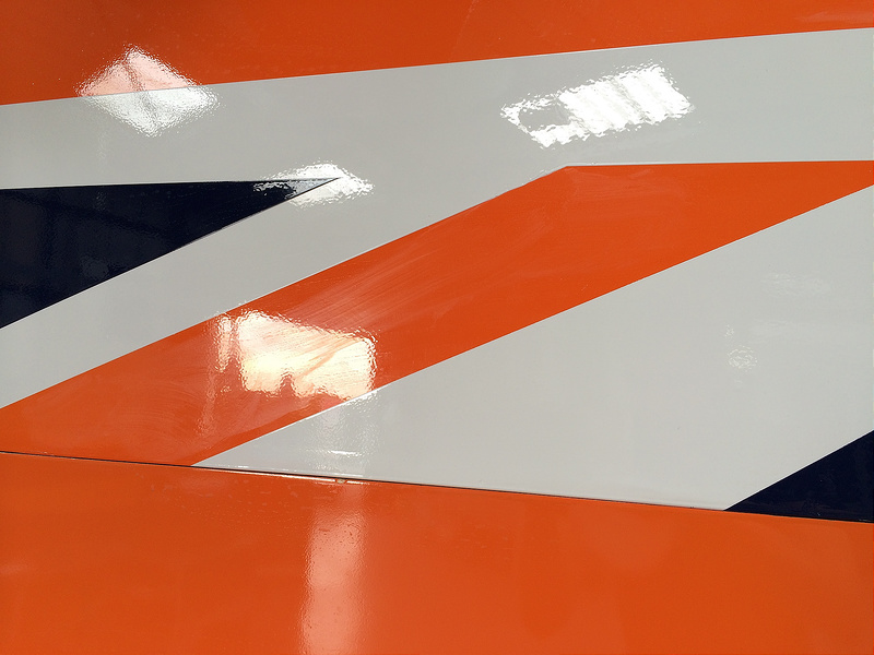

Before with a few marks, followed by Tripple to remove marring and previous wax residue.

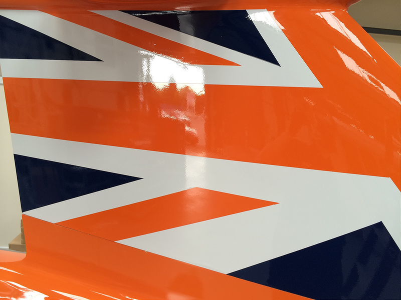

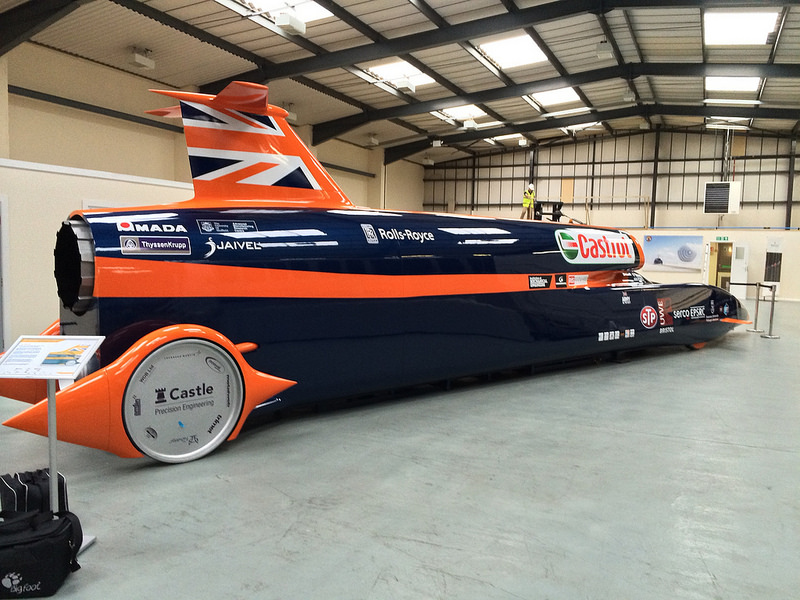

With the whole car Tripple'd, I gave the car a quick wipedown of AF Finale.
Leaving these final results after an 11-hour detail!
The guys at Bloodhound were very hospitable and were really happy with the finish. I was lucky to have Richard Noble (Previous land speed world record holder) set his eyes upon the car, saying it's the best it's ever looked!
