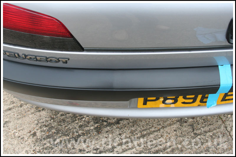

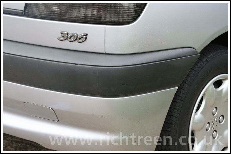

Undressed bumper

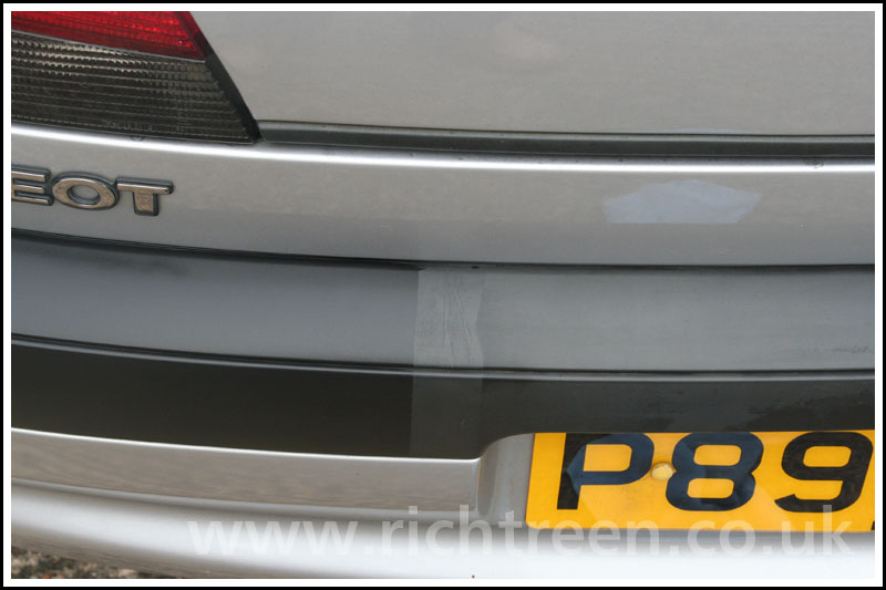

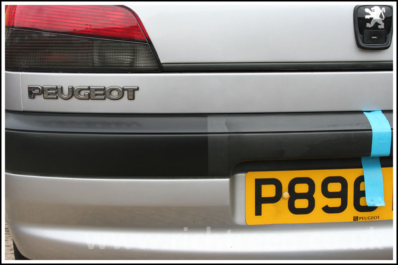

One coat of Black Wow on the left side, untouched on the right. Applied with a MF cloth and buffed with another.
AG vs Black Wow

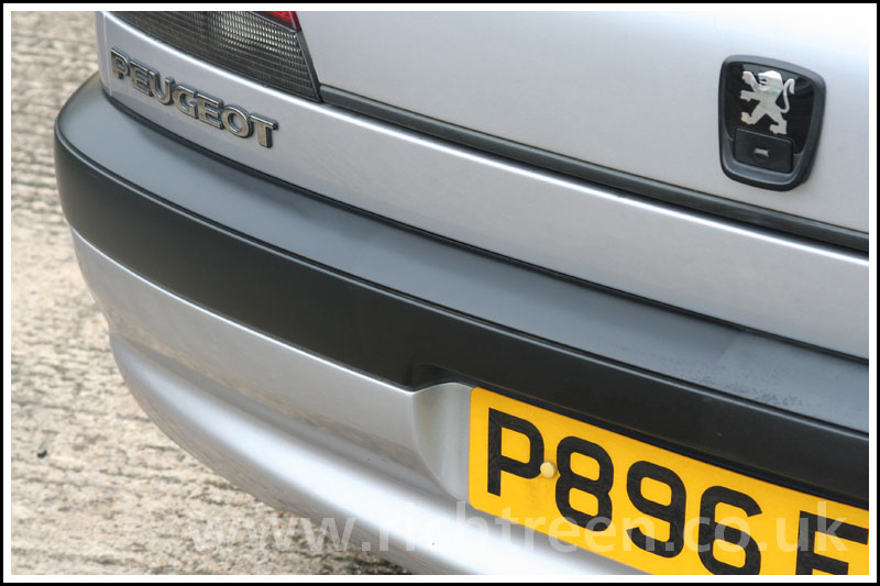

The previously untouched right hand side now dressed with AG Bumper Care Gel applied as per the Black Wow (Normal consumer version used rather than the trade one just in case). Black Wow fish was more even, dark and black as you can even see in the pics.
Above - tried to give the AG a chance so applied a second coat - still did not look as good.
The Bumper was just cleaned of dirt with water. Better results may come with a pre clean with Einszett Plastic Cleaner or such first. Looks like rain so will update on durability.
I was surprised you can see the difference in the AG and Wow in the pics but you can.
Untouched compared to Black Wow

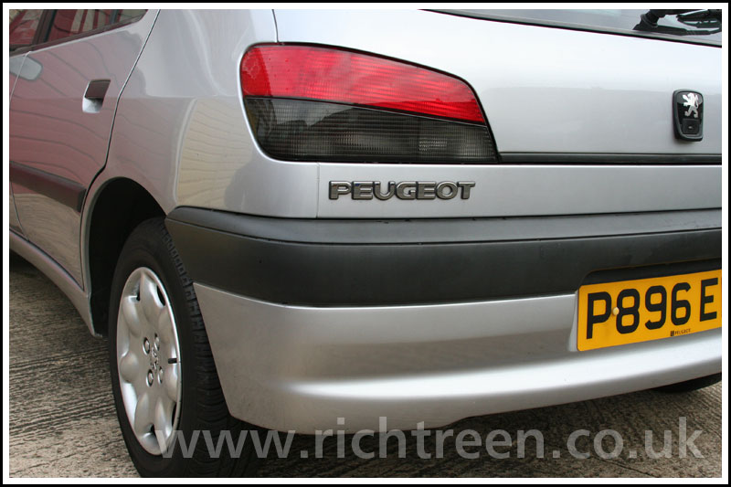

1 DAY UPDATE
lol - Just popped out to clean the glass - 24 hours on, 120 odd miles, some light rain last and a damp cold night the Black Wow has lost it's inital looks advantage over the AG, hard to split the two apart now aside from the fact the Black Wow finish looks more even. The additional sheen and gloss the Black Wow had on application is over, colour and gloss wise nothing in it.
Both are streak free though and neither have not run, and water is beading on both.

200 odd miles more and some heavy rain on monday.
Both the Wow and AG look about the same both have faded quite a lot, both just look dark grey and the difference between the treated an untreated parts is becoming hard to tell.
Both the AG and Wow have water spotted in areas, both minor and neither really worse than each other. Dust attraction wise a swipe from a finger on each looked the same, but both had attracted more grime then the untreated side.
