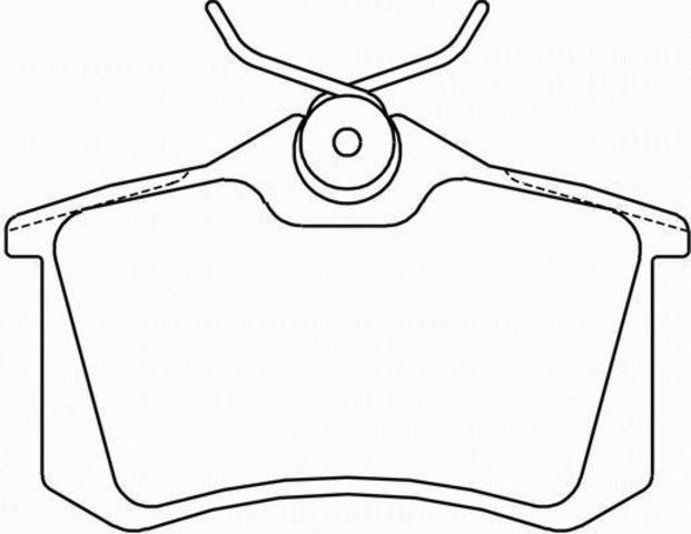

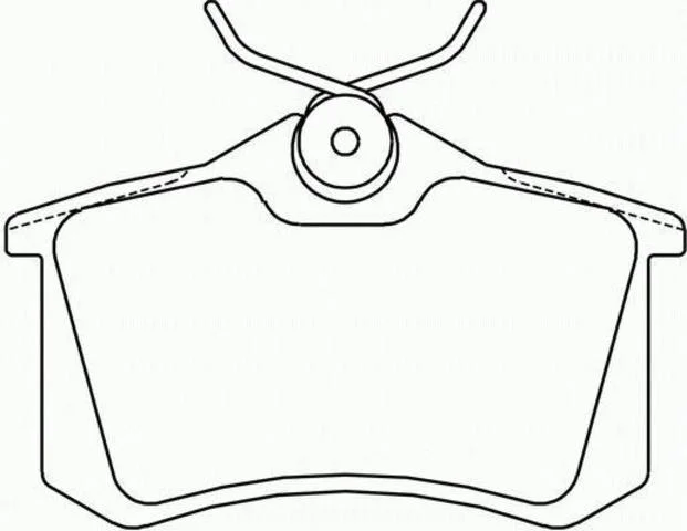

P.s GodSpeed the size of 197 cylinder is 23,8mm!The pad avaliable for this setup is this one:

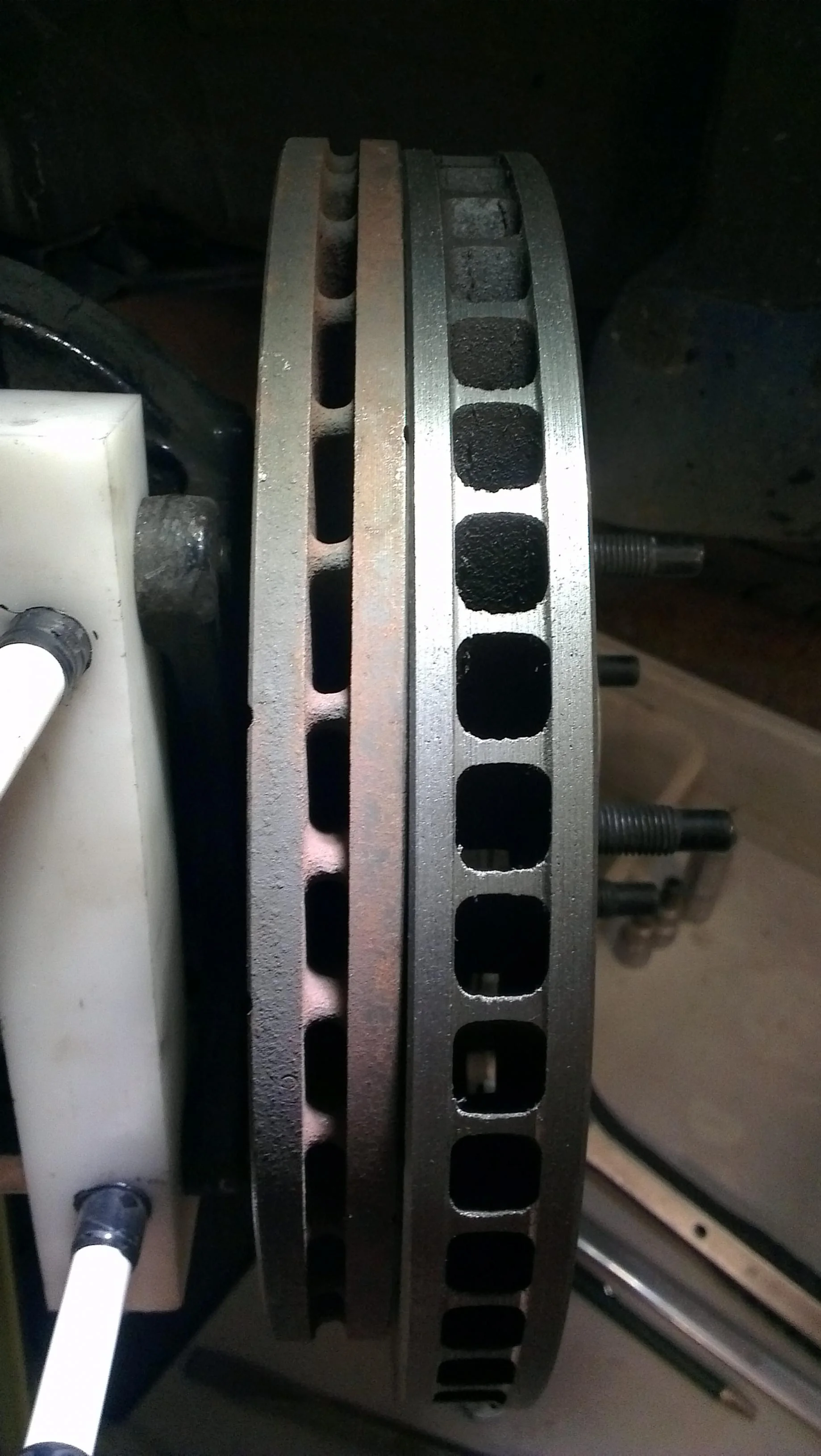

This kit uses Brembo 4-pot calipers that are visually the same as on Clio 197/200, 300x27 AP discs with vents from the inside and curved vanes in the discs.

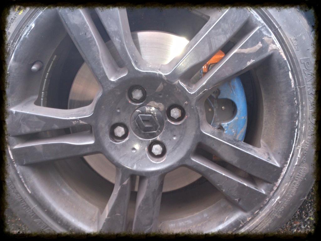

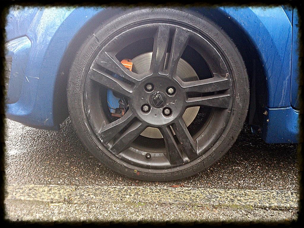

Managed to install Grand Scenic 300mm/ 24mm thick front discs and pads using larger scenic carriers , pads but keeping the 133's 57mm Caliper.
Before
After
before (before install of brembo max )
after
7701209199 - £75.21+VAT (£90.25 inc VAT) per side
410600756R - £49.48+VAT (£59.38 inc VAT)
7701207897 - £70.40+VAT (£84.48 inc VAT) per disc
Have found better Tarox pads for the larger Brake pads or may just use 133 Ferodo DS2500 pads in the future.
