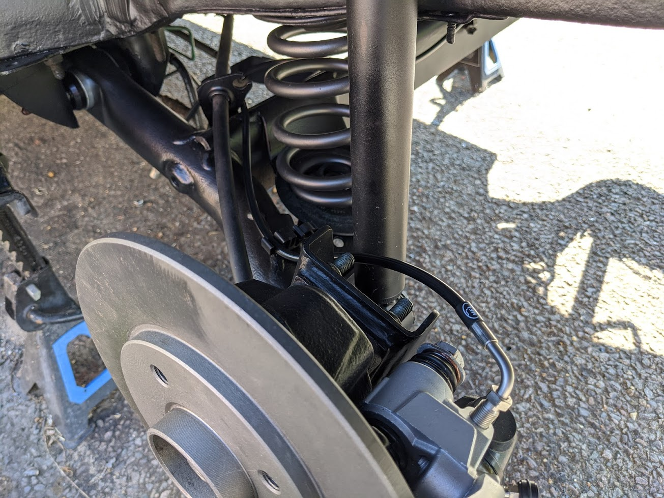

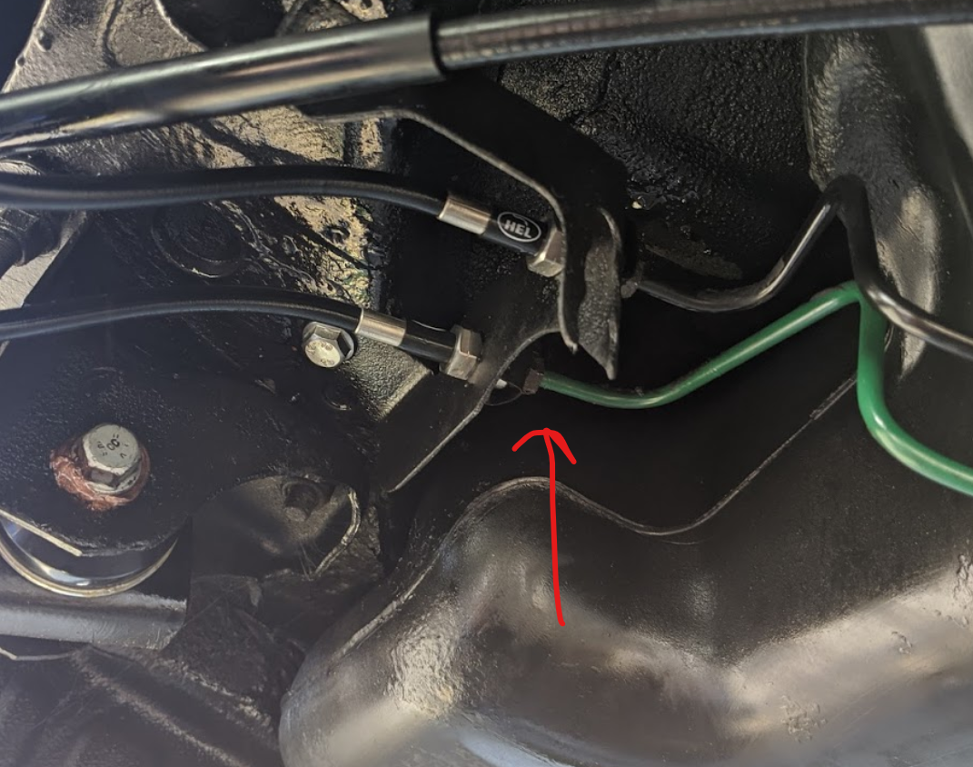

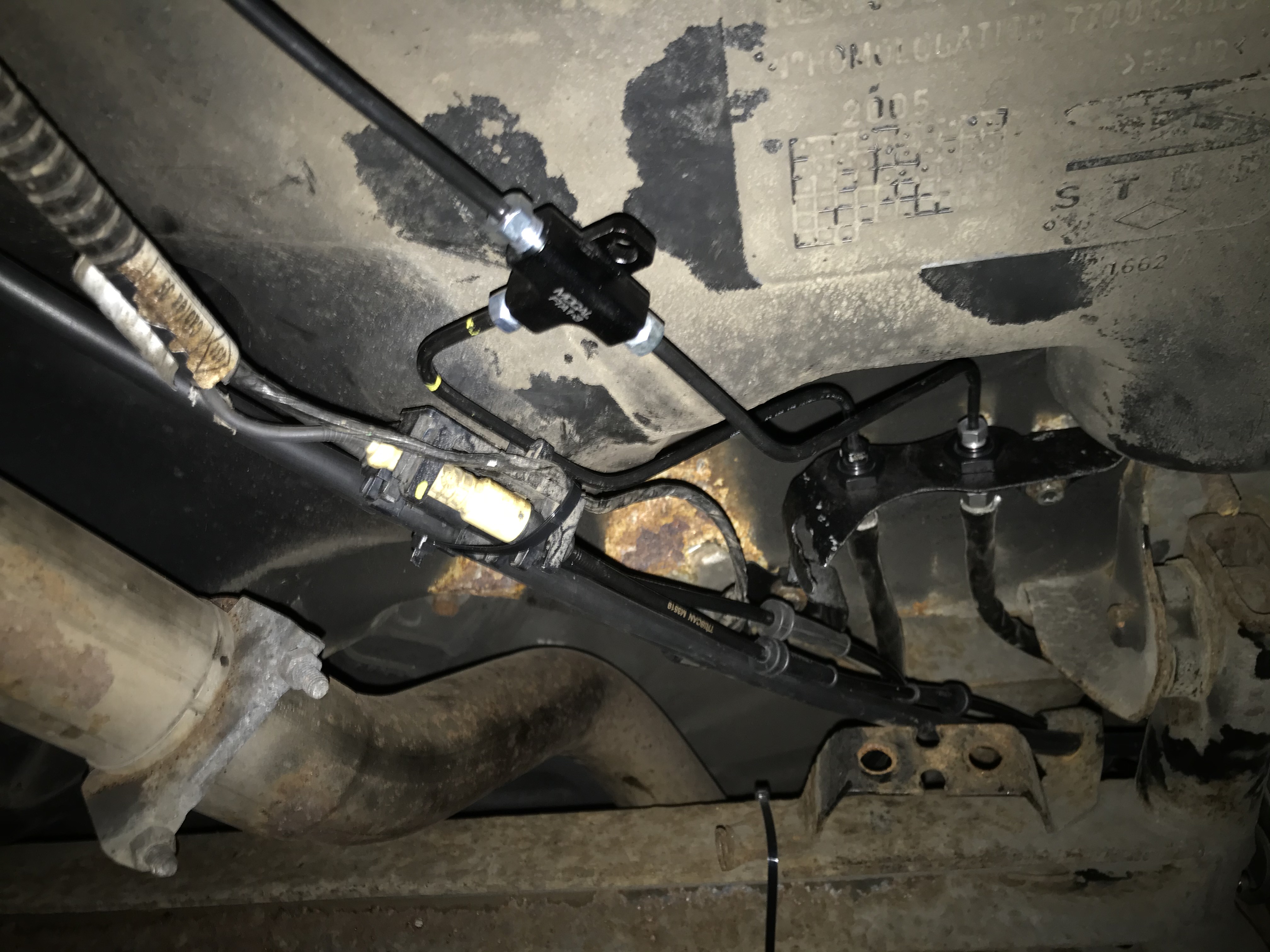

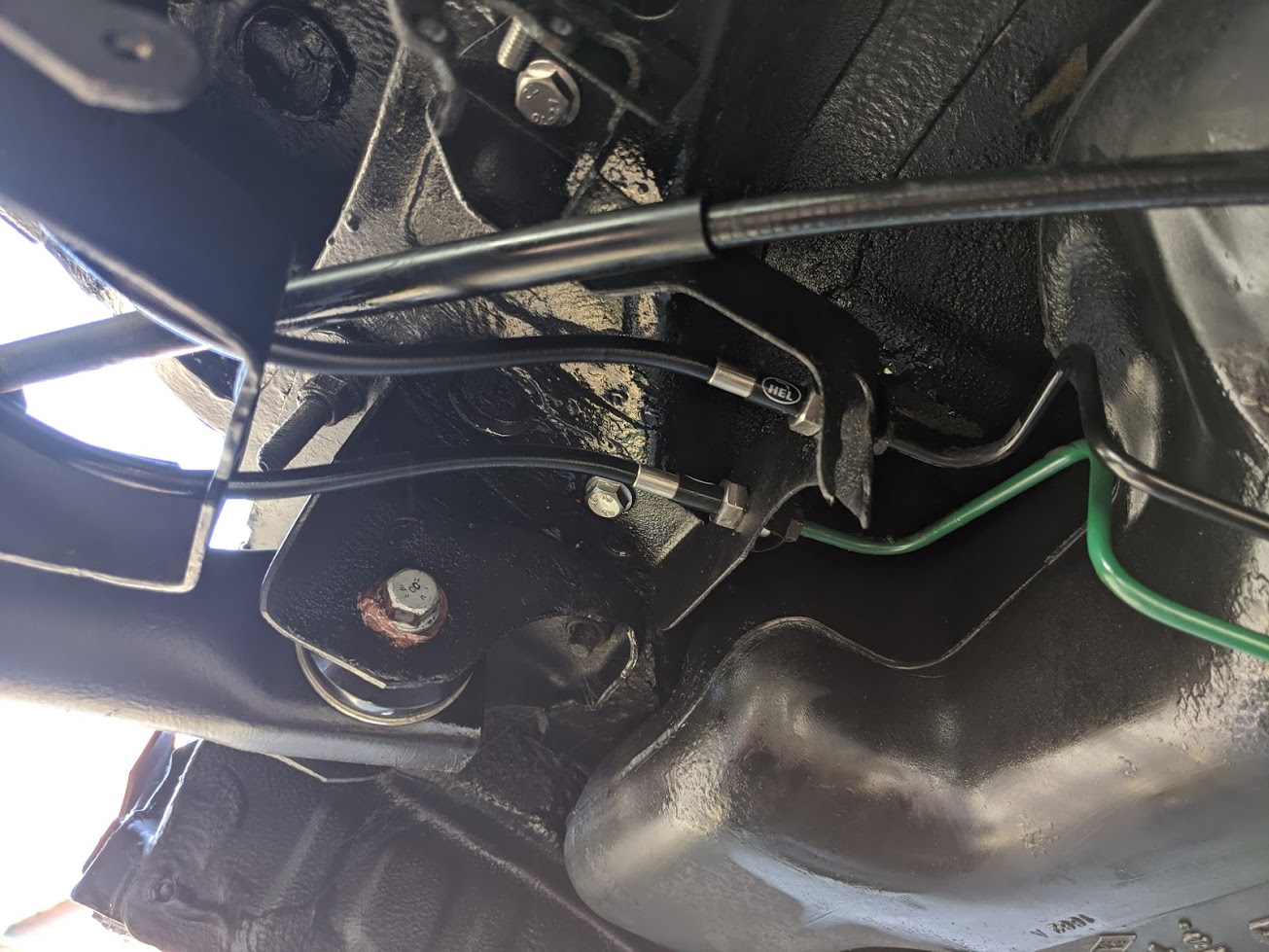

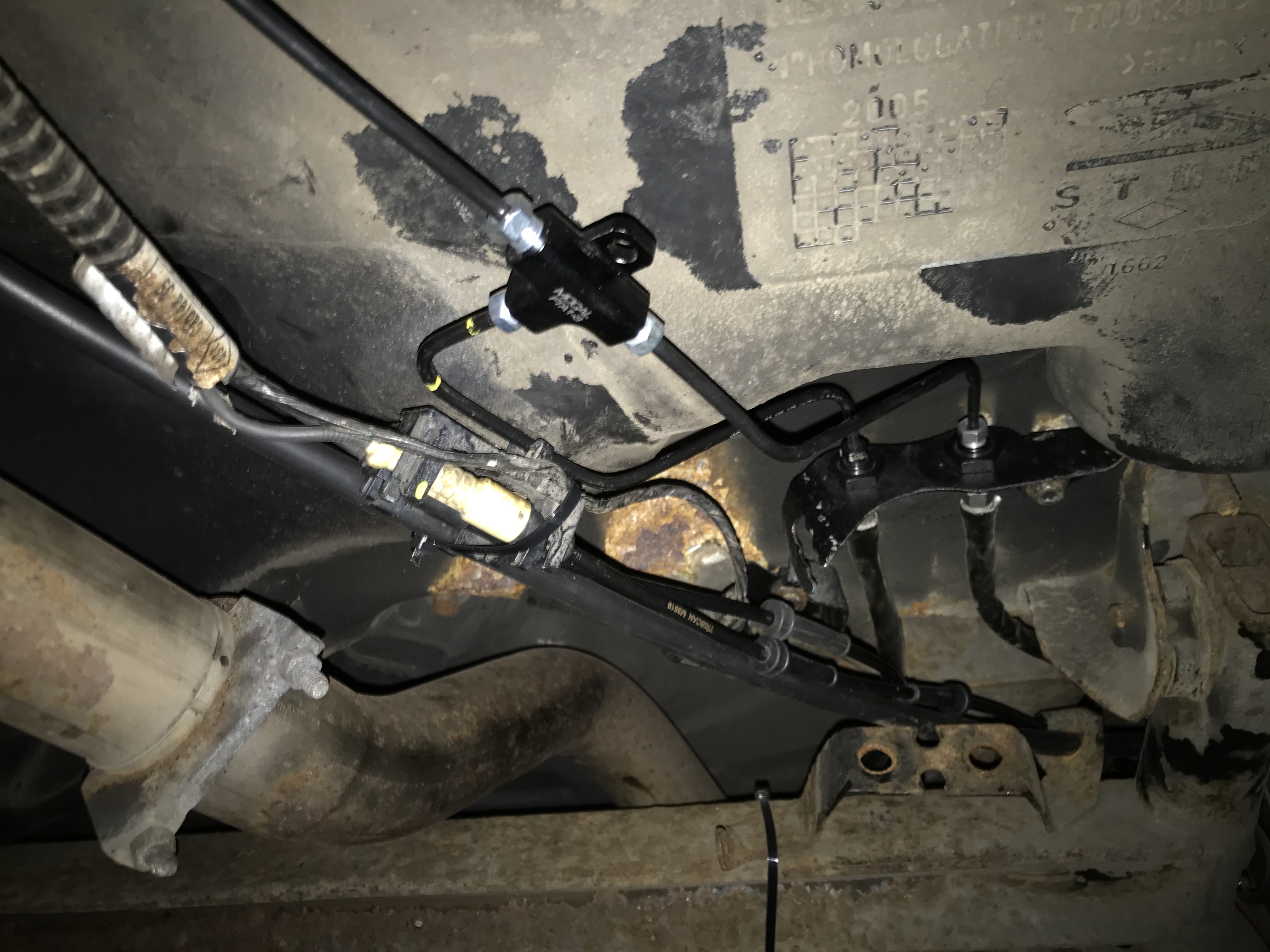

No worries, the rear lines are pretty exposed to salt and dirt etc, most at this age need doing of have been done. Enjoy, I've got some pictures somewhere i'll post in a mo
Touring_Rob
Thats the BRT kit which was great quality and not horribly expensive. (y)
  rstuned 182ff bg

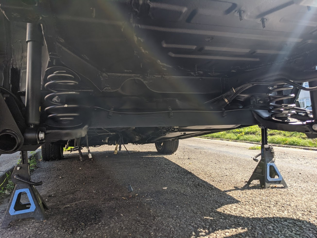

Look's tidy with the braided line/s ...Been freshing the BG up, wings off...bumpers off...sill covers off..back seats out , check and waxoil the inner rear arches, Front carpet out after the heater matrix gave way and seemed to off filled the foot wells up with coolant, , Luckily floors were in mint condition still, So yeah back to the brake lines, Thanks chaps.

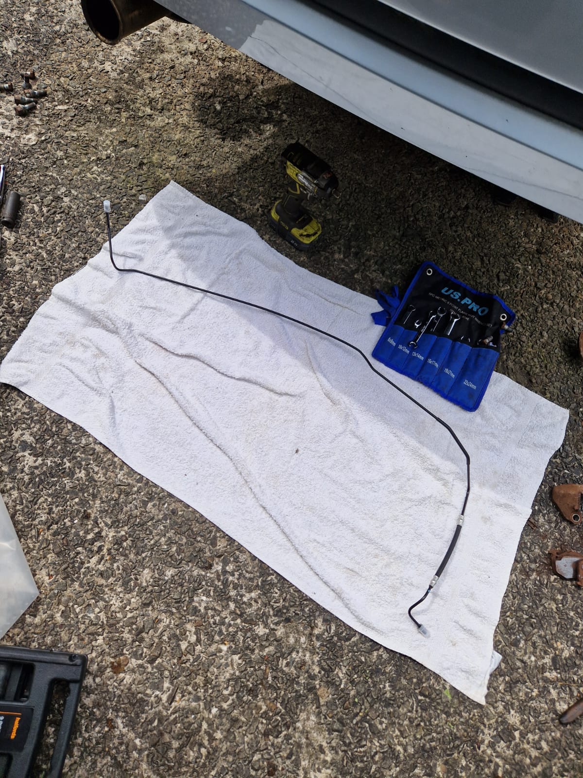

I've never used steel brake lines but have flared a new fitting into an existing steel line and my tools were not happy at all!
Copper was a walk in the park compared 😂
I bought one of the £200 kits for single din flares of larger lines, lets just say after trying it out its sat in the corner of the unit ever since lol. I don't know what oem use for flaring single din 1/4 and 5/16 lines but I need it!
