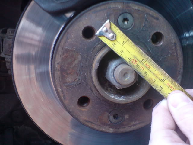

ok i think ive measured it right i took a pic and would i be right in saying it is 45mm? and does that mean fk highsports are ok to get for my clio??

no its not on the hub
the suspension strut, the two bolts that join it onto the hub you can see one of them at the far left of the pic by the looks of it

the two bolts above the hub on the suspension strut, straight infront of you, you cant miss them.

been and re-measured the bolts and got the right ones this time and they are 52mm center to center. this means the spax kit will fit but fk dont give there spacing measurements..
