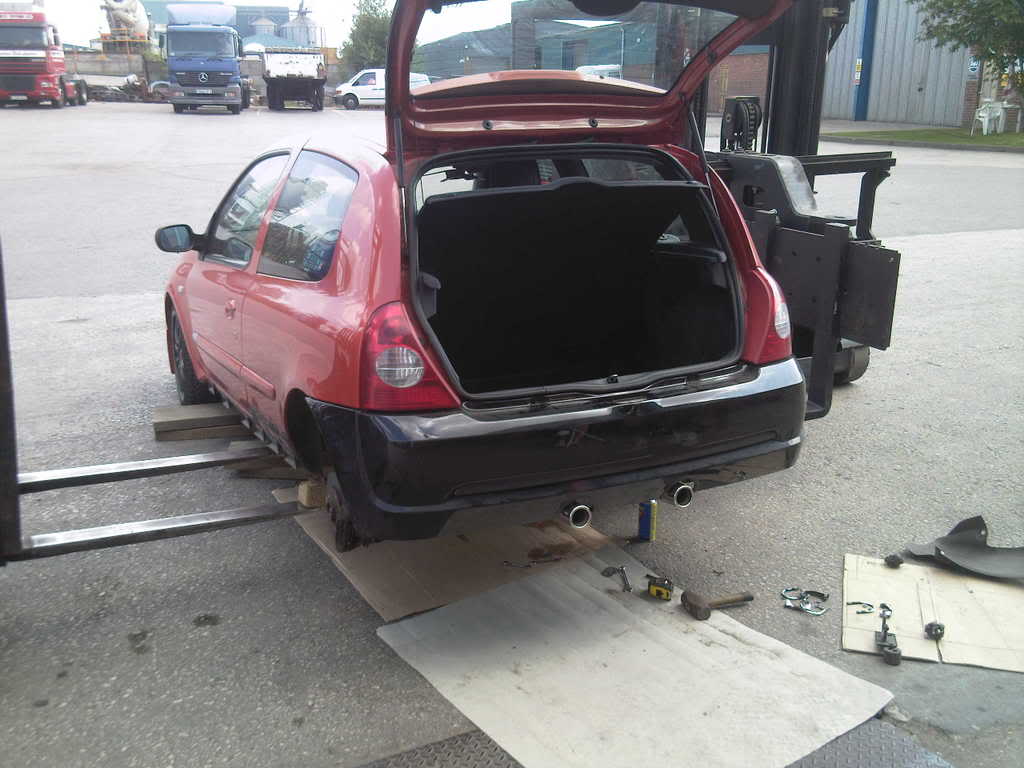

In regards to sills, when I was swapping exhausts over, I wondered what it would sound like with no scilencers at all. Proceeded to start the car up, forgetting that it was in gear! Knocked forwards, off the wooden blocks, and the sills landed on the forks. Didn't seem to do any damage though, was quite impressed.
