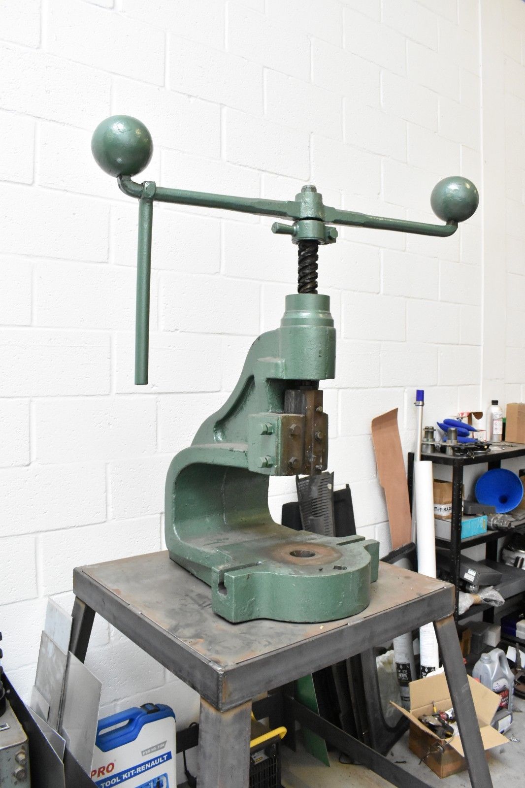

I wouldn't go for 6 tons, it would be ok some of the time but some are proper buggers. I use one that can do 20 tonnes but it's massive and from about 1903!

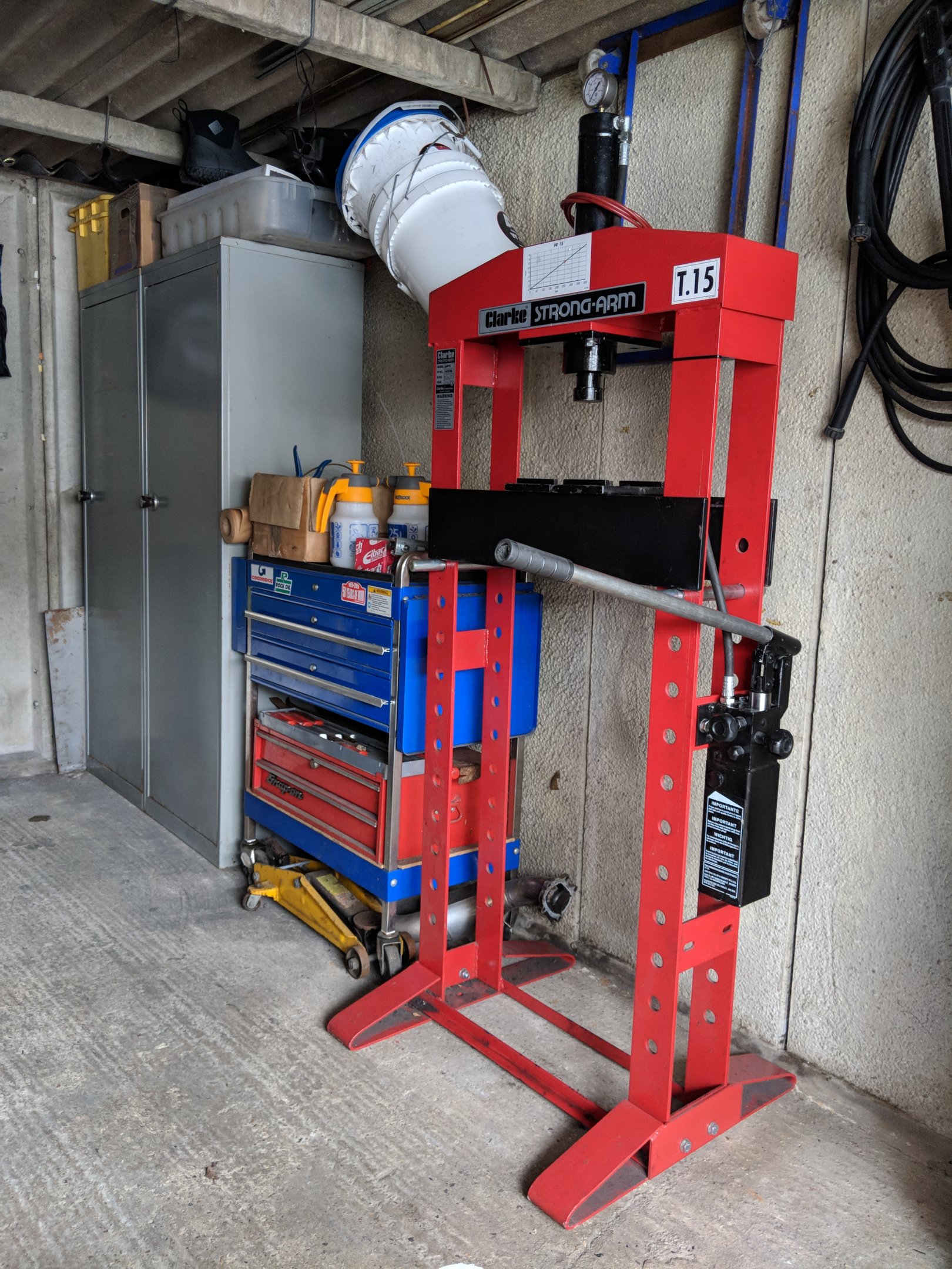

I’ve got a Clarke one I use often enough but for the sake of £40 I’d just pay someone. Some bearings can be a c**t and it’s no pleasant when they explode either

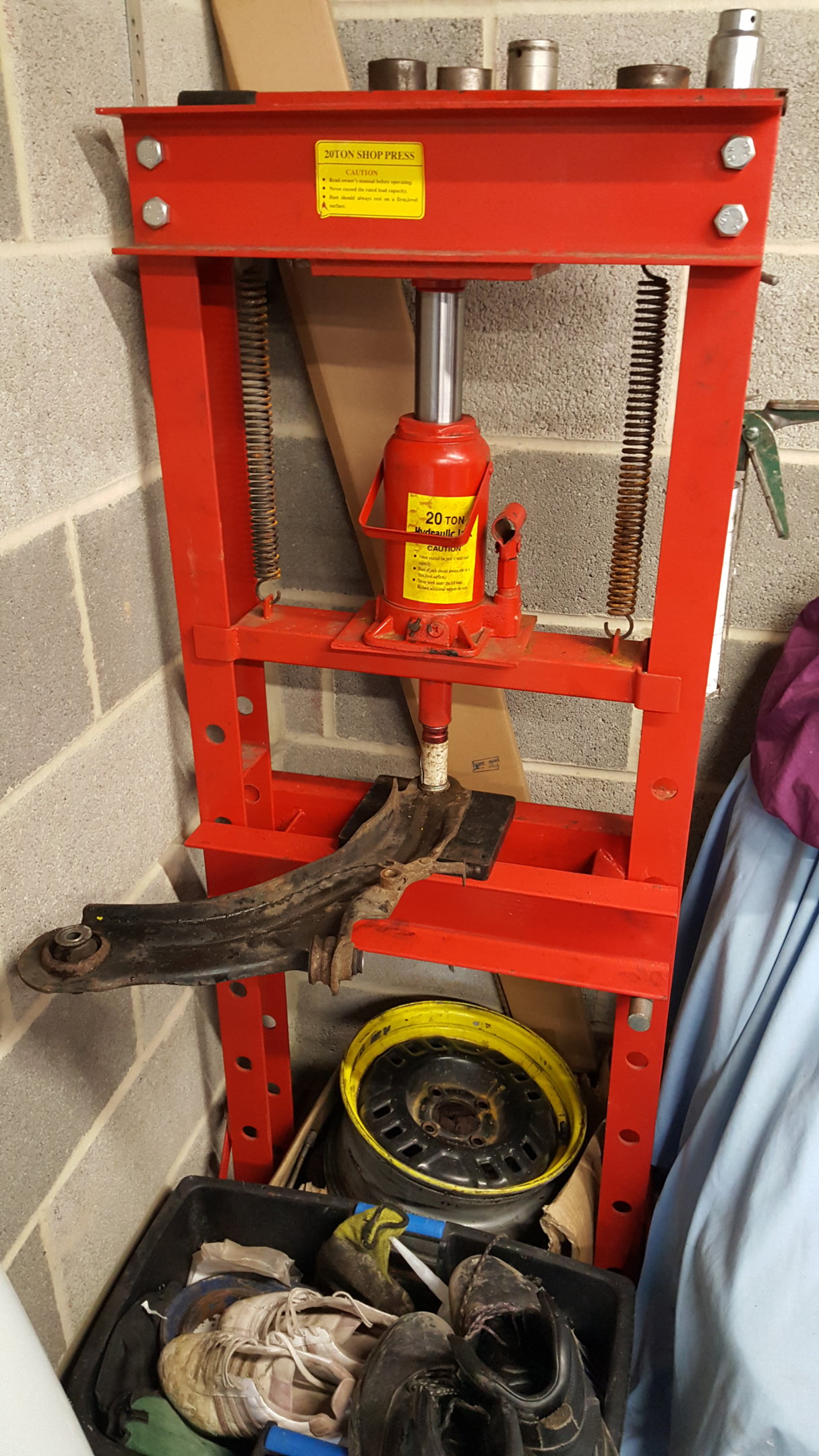

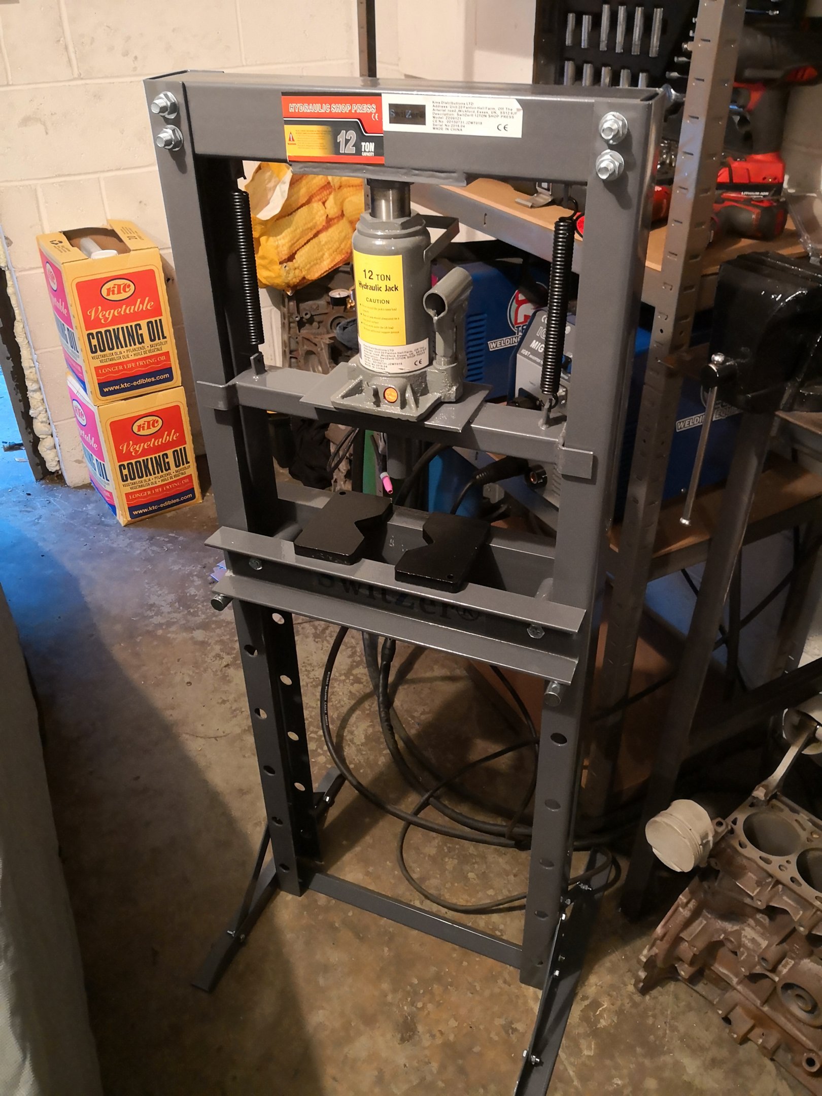

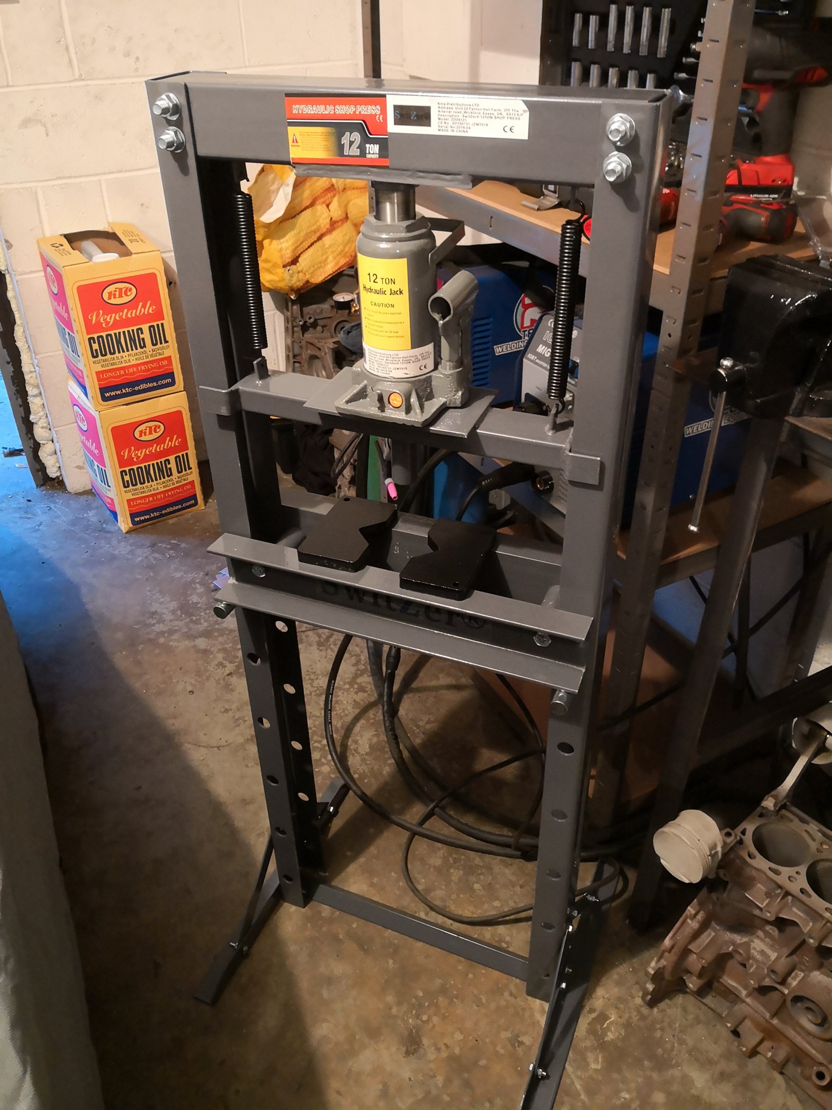

I bought one of the cheapo eBay presses, at 12 tonnes with the bottle jack style operation. It was 77 odd quid if I remember right, have done loads of wheel bearings, bushes and stuff with it and never looked back. The way I look at it if it stops working I'll just buy another 12 tonne jack and crack on. You can use sockets to prop the hubs up if you're a little creative and have some large, long sockets laying around, and once you've got one bearing out, the old races of the bearings work very well as press tools to press the new bearings in. It's all flat pack style as well, and you can easily fit all the bits for it in your clio. It's probably easier to have them done for you, but if you're a bit of a home mechanic it's a useful thing to have about the place.

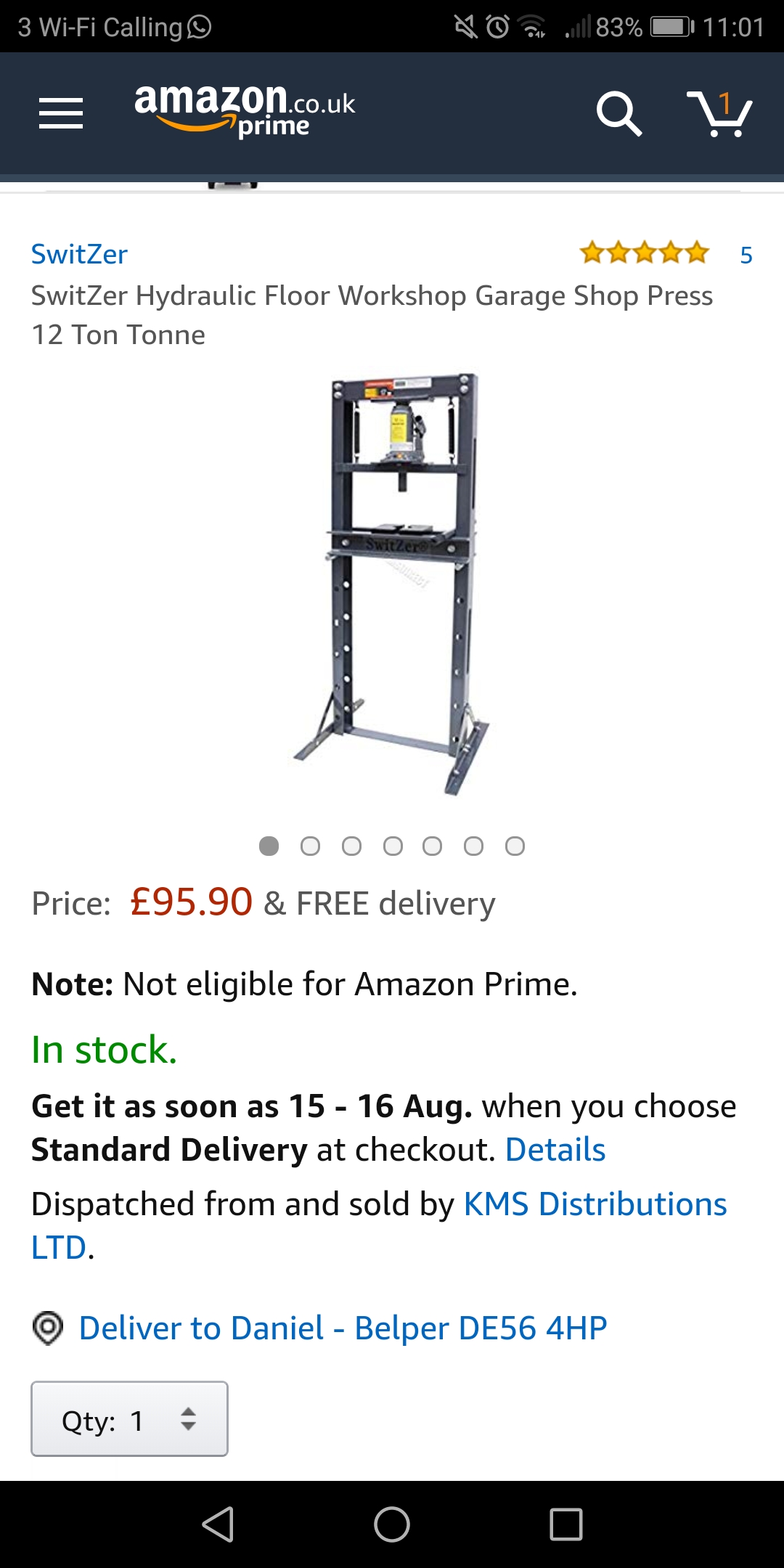

Been looking at these as mine in the lupo are going again. Seen some for £100 on amazon which have good reviews, well tempted as it'll always come in handy for bushes too! Looking at the 12 ton ones
