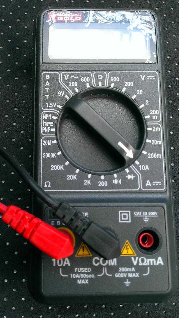

Can't get it to the garage till next month so got a loan of a multimeter and took some readings. Manuals rubbish so need to work out how to measure current drain with it.
Battery is 12.39v so needs a good charge I reckon.
When started I get 14.41v and then 14.35 with the lights on so should be charging ok.

Alternator can still be faulty if it's charging well but also drawing power when not running.
I had this problem:
From the +ive terminal there are 2 wires.
One goes to the engine/alternator, one to supply the accessories (I think)
Disconnect -ive terminal on battery
Disconnect the +ive one that supplies accessories (this goes towards the fuse box)
Put multimeter on current (amps)
Test between -ive terminal and the wire you removed from that terminal.
If reading is unusually high then its likely the alternator thats packed in. (check by removing it at the alternator and amps should drop to normal)
If it isn't then remove the alternator side and connect the other side on the +ive terminal.
Test again, if high amps remove the fuses one at a time to see what drops it and thats your problem.
As for what amps are high or not, I don't know for sure so someone else will have to confirm. Mine read low miliamps when it was on the accessory side, the alternator was the one dragging it down and was drawing about 1 amp IIRC.
This is what we did with mine anyway, could be a load of tosh and a much easier way to do it.

Not sure if I'm doing this rigth but I disconnected the negative from the battery and connected the meter as above in line to complete the circuit and gave a reading of 0.17
koi
  Audi S1
Thanks Dan, at least I know I'm on the right track now. Start pulling fuses one at a time till the current drops, that's my weekend sorted...

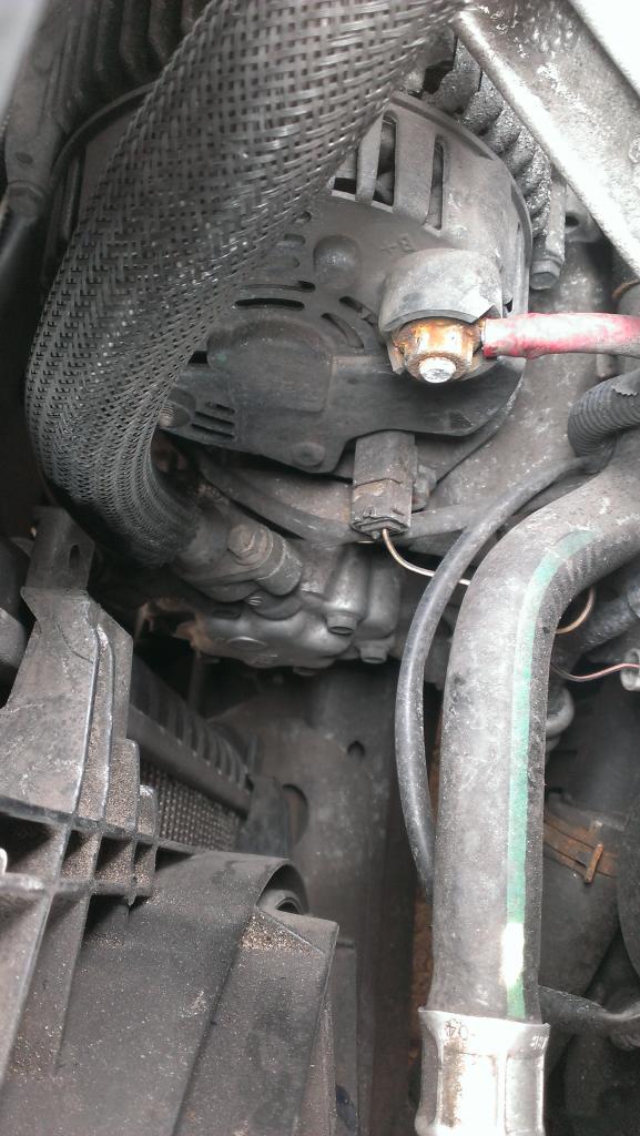

With the alternator side disconnected only getting a drain of 0.01A so guessing this is fine.
With just the alternator side connected it jumps to 0.12A, when I disconnected the cable below it drops to 0 so guess the alternator is faulty. Is this easy enough to swap out? Had the bumper off before so no problems with that but guessing that's the easy part.
jenic
Sounds like you need a new alternator then.
You need to untension the aux belt, remove the old one, new one in, retension belt. Easier said than done ime, I'd get a garage to do it, I'd replace the belt too, maybe even the whole aux kit if it hasn't been done before.

Well alternator changed and things are looking good finally.
Voltage engine off, 12.44v
Voltage engine on 14.56v
Drain now 0.01a
Hopefully that's the end of that and cars running 100% again.
