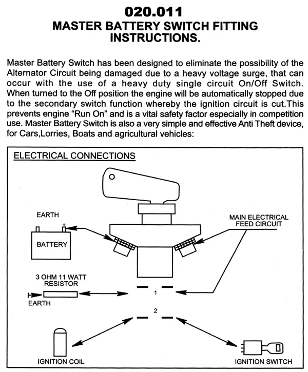

If it's a proper kill switch you should find this useful;-
Yes that's the one. I just need to find out the best place to cut into the wires for the ignition then I guess. Will putting the ignition feed from the original key switch ignition barrel suffice?
Perfect. That's easy enough then. I was thinking I might have to find the live to the coil and bring that through the bulkhead and connect that up to the switch and the ignition live to the other.
