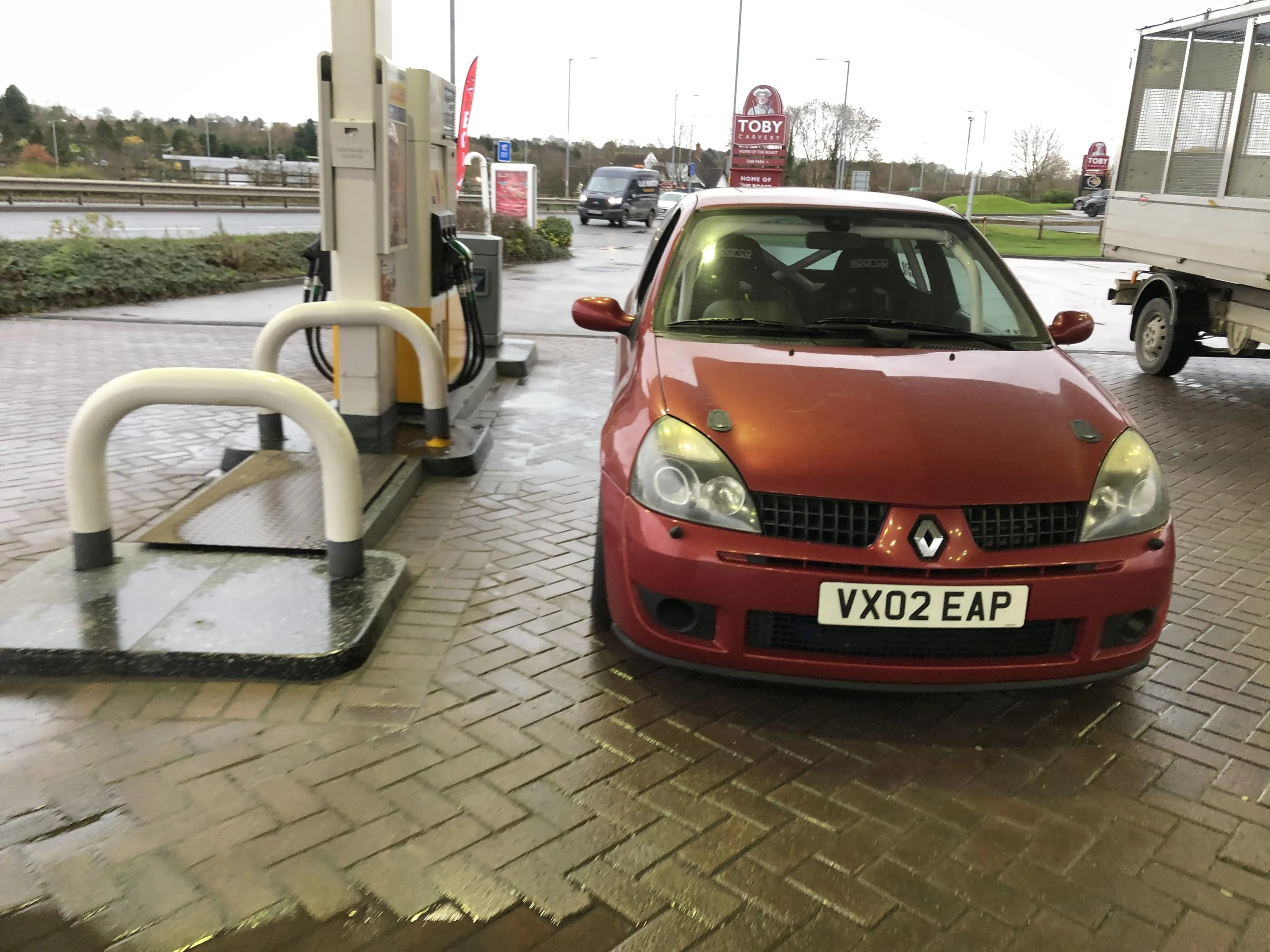

Took it for fuel, ready for Sunday. It still works....

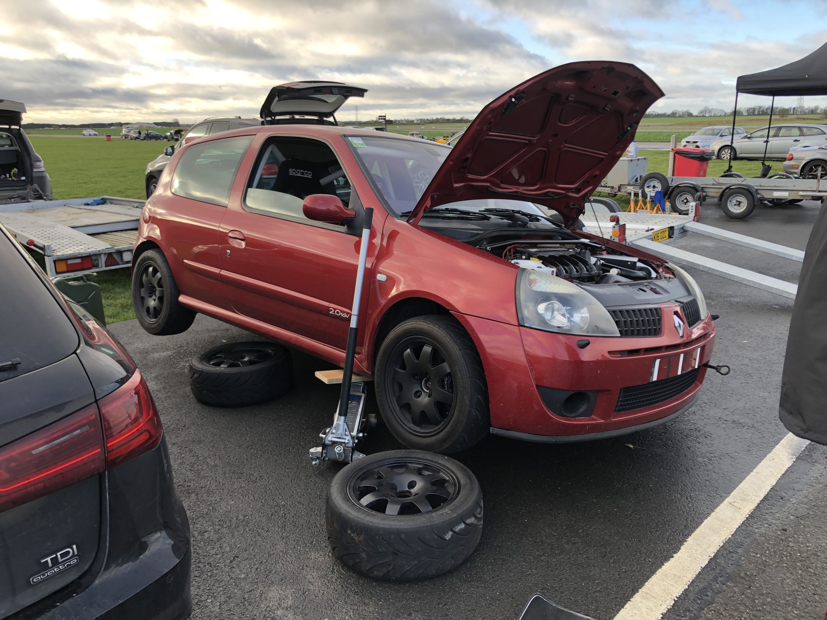

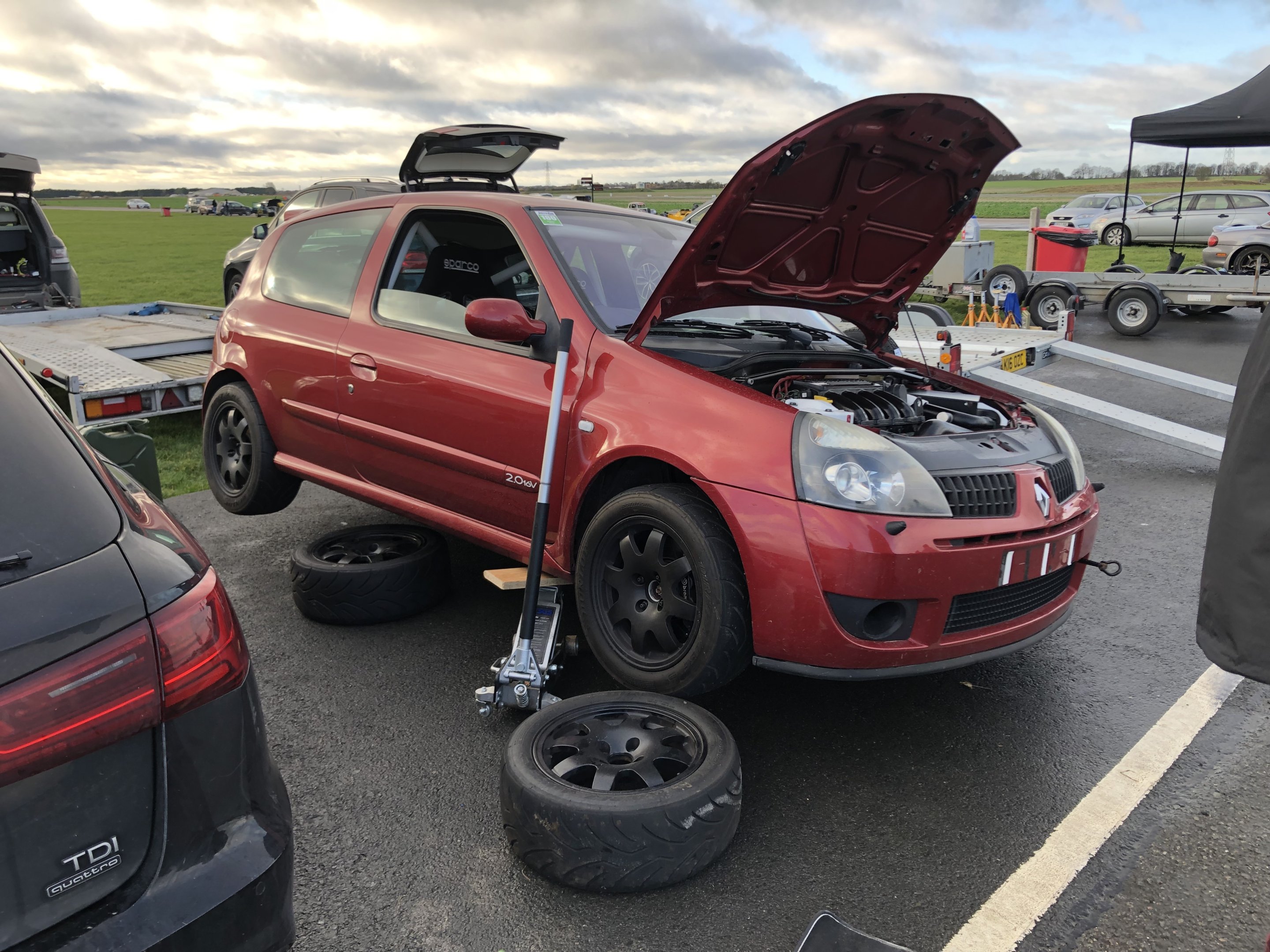

Cats fucked and the manifold join has come apart.
Done 4 laps.
Waitey
  Alpina D3, AC Cobra
Well......
Today wasn’t a total waste of time.
60 laps done. Half a tank used. My two mates got a drive of it too.
Issue with it was the rear exhaust hanger breaking, the movement then causing the cat to manifold joint to open and bugger the gasket ring.
Cable ties and some exhaust paste got us back out after an hour of down time.
