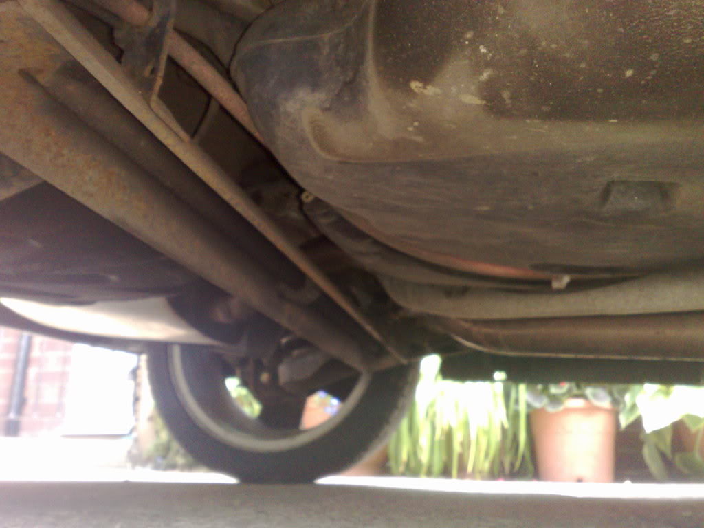

Even use the rear axle (the bar that runs width of car) :)

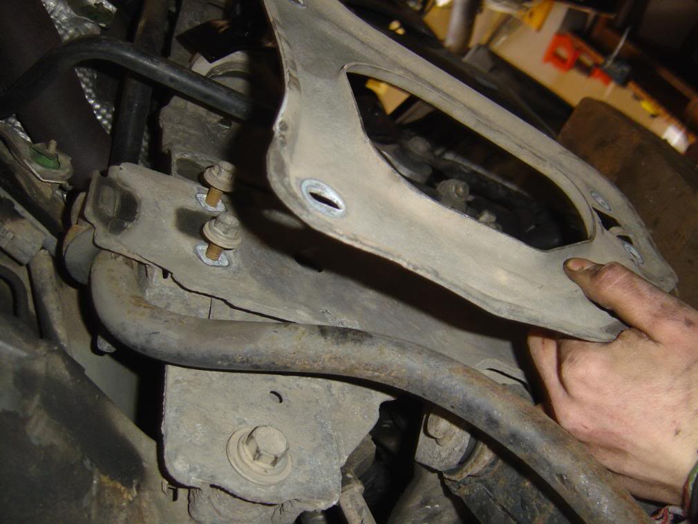

And on the front you could use the subframe braces to save paint chipping of the sills
You can even jack up on that bits (where the bolts go through on the box bit of body) to save chipped sills ;)

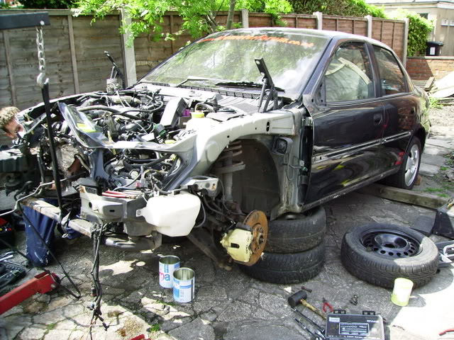

Jack it up and shove some old wheels under it, spread the weight out better so it doesn't really matter where you put them. Axle stands aren't that safe if you knock the car...
