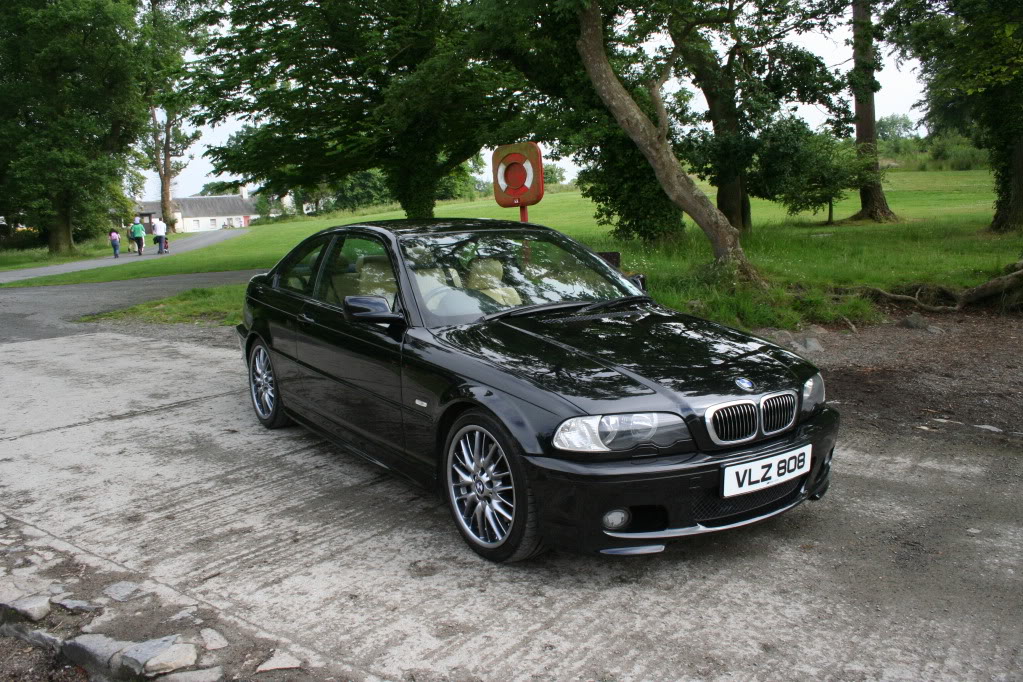

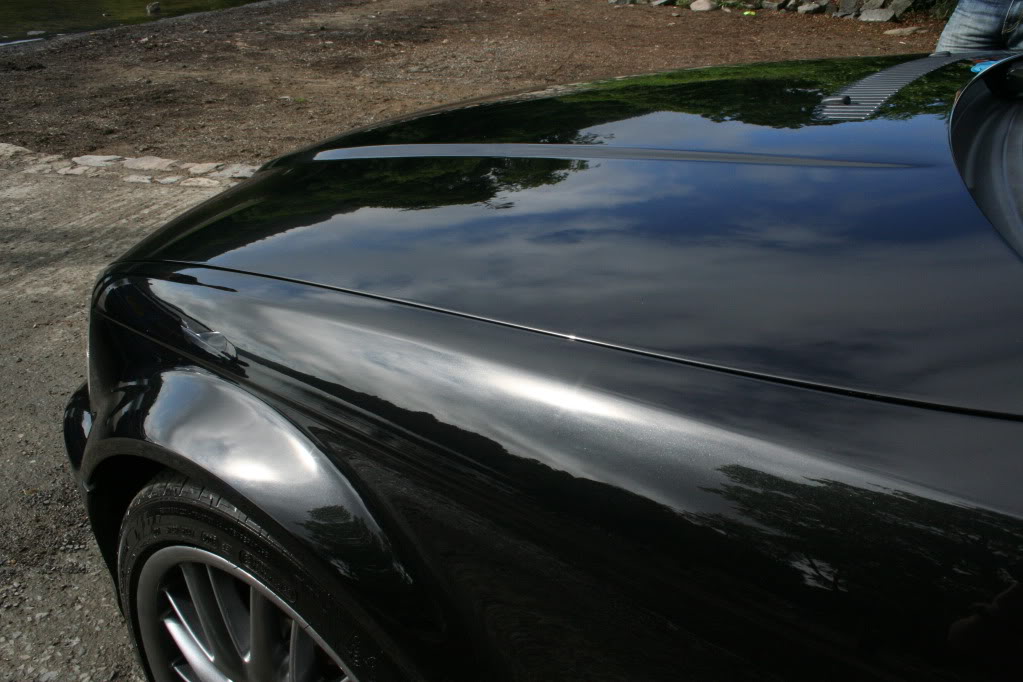

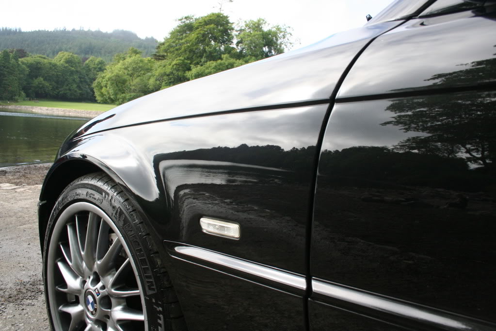

found this on another site and i was so impressed by the before/after results i thought i would post it on here
before
after
thread found here
http://www.migweb.co.uk/forums/car-...284-how-remove-orange-peel-lots-pictures.html
credit: cheekyalex from migweb.co.uk
