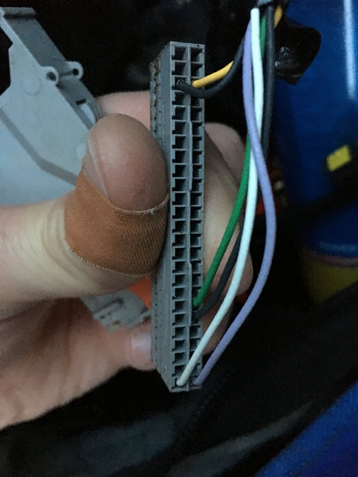

Its easy if you follow each wire - some branch from big soldered joints of multiple wires, some go straight to the fuseboard/uch, some have shared earths etc. Just be methodical. Airbag plug needs some wires leaving in to prevent airbag light coming on (assuming you have deactivated or used resistors for any removed airbags), see picture. It took me a few evenings to remove most of my redundant loom, label the plugs, cable tie the groups and branches before you remove the wrap as well.
