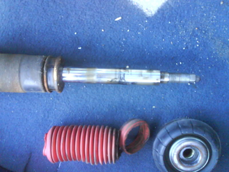

Everything went to plan with removal of the old setup. Jack car up, take off wheels, remove struts. Checking over the AVO’s to make sure they were fine I could see no major issues except for a split rubber piston cover, which I jury-rigged to be effective again, and very slight evidence of fluid loss on both pistons, nothing to worry about:
The problems started to occur as I started to build up the suspension with the new mounts. Check adjustable heights of both struts, refit the springs, place new AST top hats onto springs...my first problem:

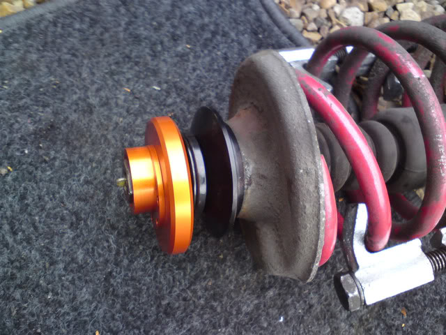

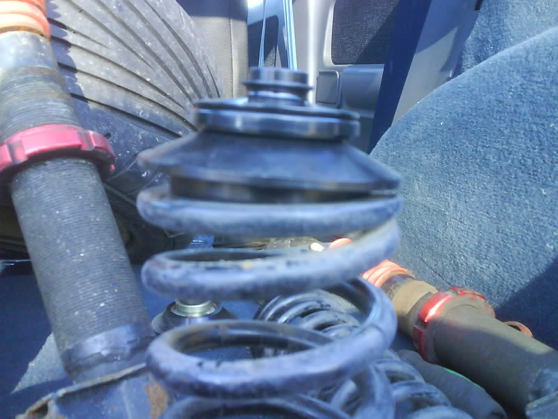

I find I cannot get the top hats to sit on the spring correctly; the inner lip is too thick. I decided to put them on as best I could and hope the weight of the car would settle them in with use. You could possibly jam them on with tools but I didn’t want to try it at this stage. If they remain like this when I next inspect them then I may try this or contact AST myself.
Now, next time I fit these I will put the two anodised parts of the mount on the top of the suspension turret first and screw them down so they are secure and already in position. This way you save risking them not being in place correctly so the top mount ‘sleeve’ is not incorrectly positioned when you lower the car to the ground.

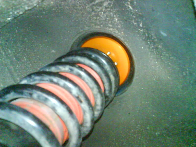

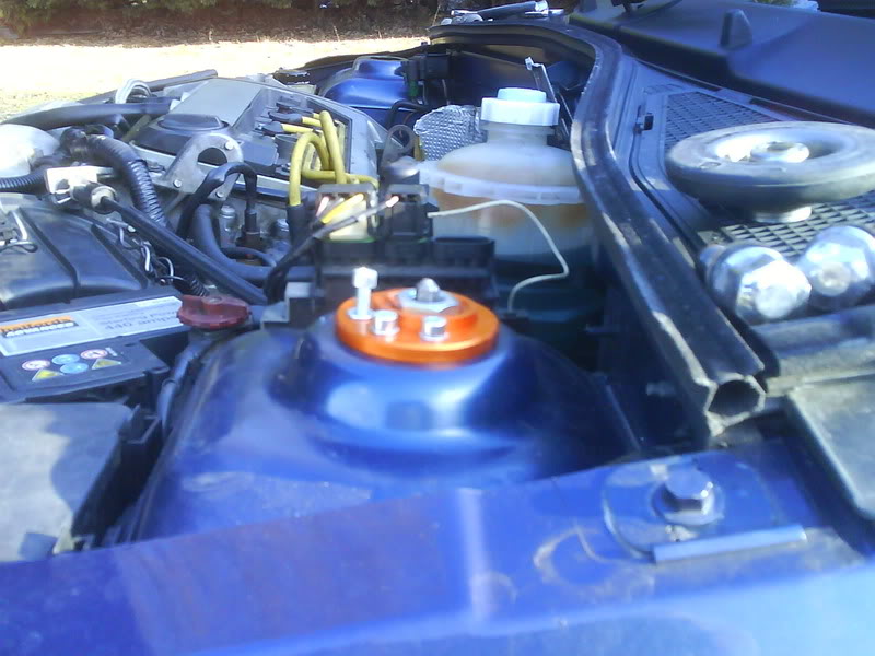

I fit the first built strut in the turret; here is a pic of the underside:
I then locate the top into the turret hole correctly and fit the top anodised part, bolting it down:

Ok, so adjustment time. Initially I set mine with a little negative camber and some positive castor:
To adjust them you need the car jacked up to take the strain off the mounts. Slightly loosen the three small bolts and simply twist the top part of the mount, watch the wheel as you do this, you will see it move about with more castor and more or less camber, interesting to watch how they change the geometry so easily.
With my initial settings, I did my wheel nuts up and off I went on a quick test drive. With these settings you could feel the car behave differently, it’s not a vast change but the dead-ahead feel and self-centre on the steering wheel was a little odd, this is due to the altered castor. Cornering was better though and it felt firmer.

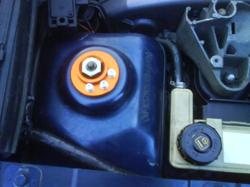

Another issue I discovered when I took a look at the top securing nut was that due to the nature of the design, the securing nut fouls the inside of the inner anodised mount as there is a bit of flex from the rose jointed rubber bit allowing the nut to move on an axis as the strut moves, making contact with the mount. Leaves nice indentations. Have to keep my eye on that as it could loosen the nut.
Do they do what they say on the tin? Yes. The car feels better, firmer, and I have lost that slight wobbly feeling from the less secure standard top mounts mated to the ‘sitting too high’ AVO coilovers. I wanted to keep driving about like a loony but as this was only a test drive I needed to get home and give it all a check over. The rattling noise had settled, but I am sure they are not in their correct position still.
I will be making notes as time goes by and making some recommendations to AST on the design shortly, as they can be improved. I am not happy about the top hat mounts on the springs or the way the nut sits, or the size of it.

Yea mate, I will be sending them feedback. I think they need to enlarge the recess where the nut sits. This itself wont compromise strength as that part does not need it, it's only the solid part that sits up in the strut hole that needs to take any strain.

Did you have issues with the part that sits on the springs not fitting?
Just got your PM's on C16v dude. And yes, they should sit inside, mine do, it seems your springs are slightly smaller in diameter.

I think they will go on, but need a lot of force to get them to do so, even the weight of the car didn't do it. They are standard 250lb AVO springs, all interchangeable with other coilover springs.
I think I will raise the car a tad more ;)
Very odd that they are such a tight fit. I tried someone elses from this group buy on a brand new FK strut and it was a 'perfect' fit into the spring, so im guessing 1mm difference in size would make it tight!

Just loosely assembled mine, the spring sits over my cup easily, not had to force it at all. FK spring's so possibly a little different to your Avo's.

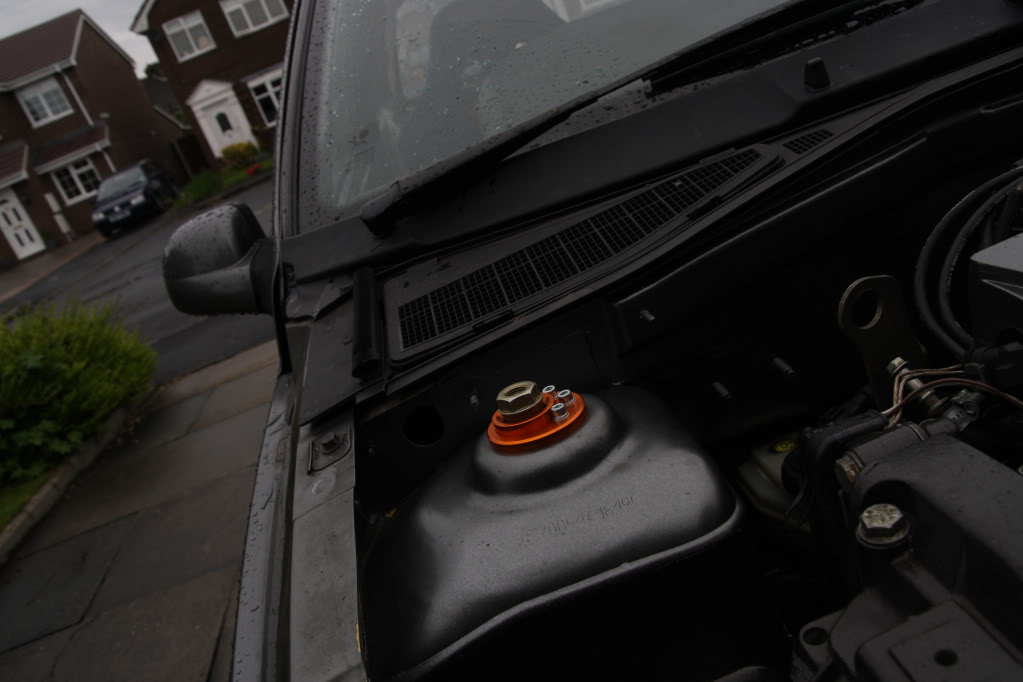

The older/larger headed nut here:

Yea see the nut in the top? Mine has fouled the inside of the anodised part and scratched/dented it to hell already!

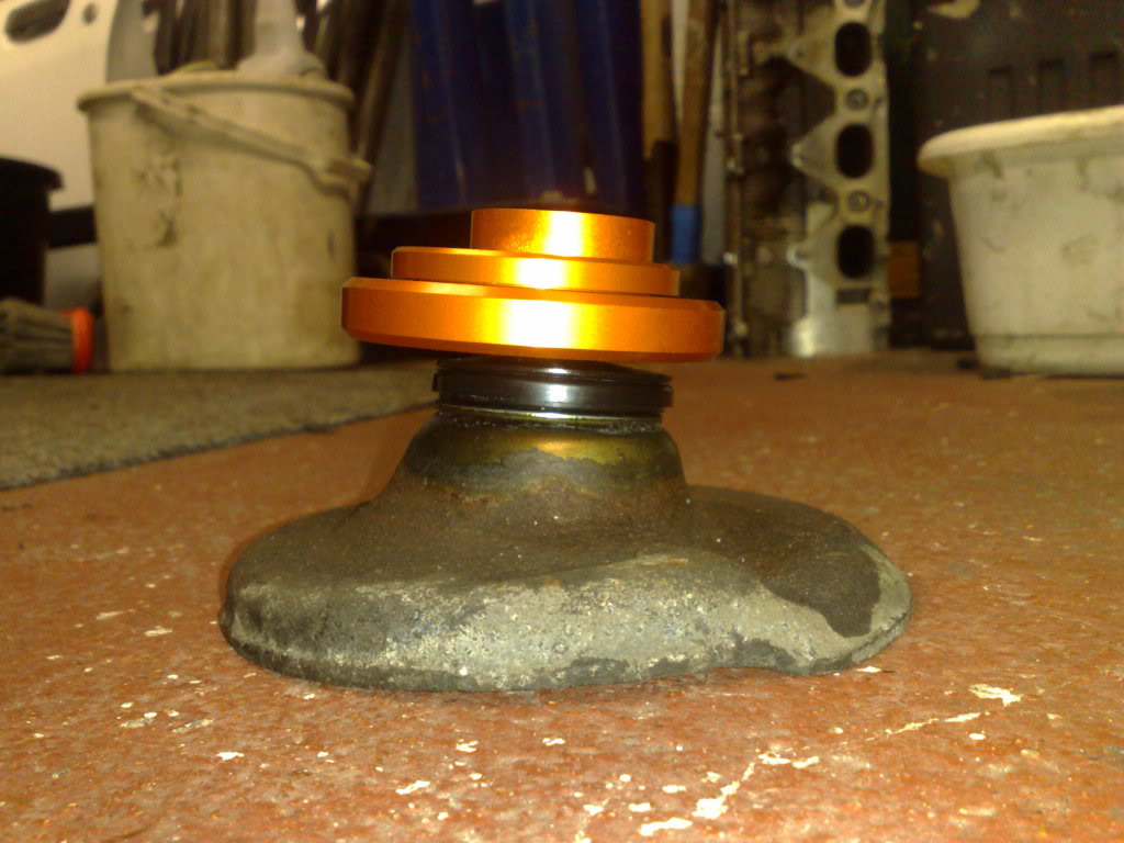

it all lines up with the strut shaft so dont see how it isnt safe. The bearing wouldnt sit flush without it, I dont see how else it could work . . .
Really need to find someone else who has fitted them to oe style dampers to see what they have done . . .

that doesn't look safe, the tophat isn't meant to be used on standard struts
If I've asked Kam Racing to machine the collars, so it's suitable for use with an OE setup, should I not use the top hat?

Overall, I like the look of them under the bonnet too. The main flaw is that the securing nut has fouled the inner sleeve of the anodised mount.

^ isnt actually bolted down in pic is only resting on . .. and all flat faces that should mount flat together are doing
