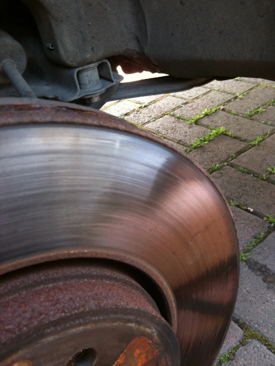

Are they shagged?
This is my front disc, do I need to buy new ones?
- slight (c.1mm) lip
- some black marks on the face of the disc, but they don't look like cracks
- rusty on the top
Cheers,
Matt
  LY 220 Trophy+IB PH1
I've seen worse ! you just looking to renew or do you have problems in the breaking department ?
Alastair.
  986'S 172ph1+182FF
measure the disc thickness, if they are genuine discs they should have a min thickness printed on them , they look ok though
If its non rs i think the min discs thickness is 17.8mm iirc
Dan
  Yozza'd Blue Bus
Don't look far off mine ATM and I have been told I have got 5 to 7k left but they will be changed before that comes round Just because they look old and rather crap :S
  Clio 197
front wear wont tell you that much. The back of the disk will be worn out well before the front will be visibly shagged
yeah this happended on mine, on the face of the disc there wasnt even any scoring however different story on the rear - £45 delivered for the Brembo HCs
