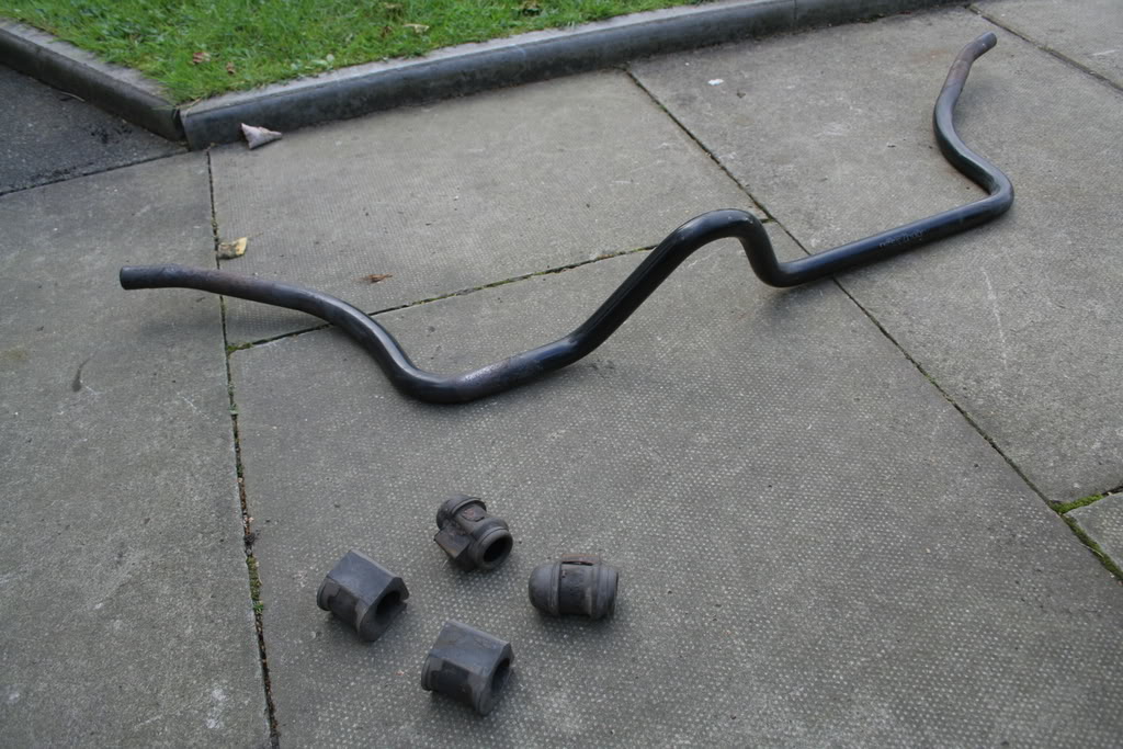

looked at a mk2 ARB? might be worth a shot
  ValverInBits
f**k me dan. That's a point. If anyone has any photos of a MK2 ARB, post em up. I'll go trawling the projects for a subframe setup.
  BMW M5 & E36
172 ARB
  ValverInBits
ah don't say that. :(
I might get a 1.2MK2 one from the scrappy and have a look at the hump situation.
