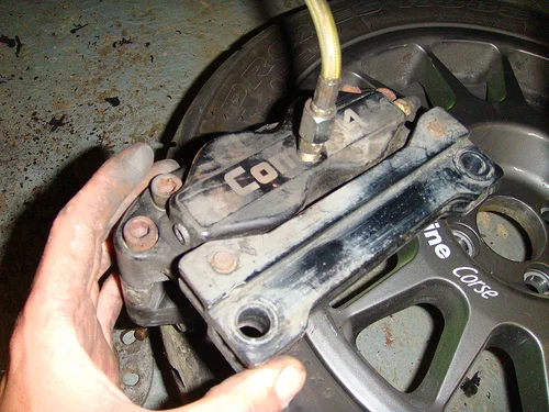

I have the Comp Brake set up on my clio and they are really good but seem to go through pads really quickly and when i first had them they were wearing the pads unevenly it was like the groove in the disc was grinding them instead of getting rid of the gas and brake dust. It was like two of the pistons were working harder and the leading edge of the pad was wearing out.
I thought id had the discs on the wrong way round but i didnt the grooves go the way the disc turns to get rid of the gasses. I know that different people have different opions on that tho!
We were using the pads supplied with the kit 1st which were Hawk track day pads then changed to DS2500s now it seems that they have taken their toll on the discs and have worn them unevenly it seems that the outside of the Disc has more wear than the inside!
It is pointing toward that they are not bolted on correctly doesnt it! But the bracket is a one piece CNC part that can only go on one way. Or does it??????
Ill try and get some pics up tonight was just putting this thread together on the off chance someone uses the same kit!
Many thanks in advance!
Fletcher

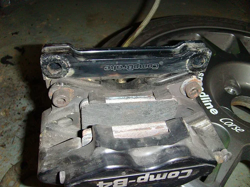

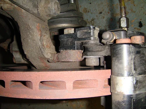

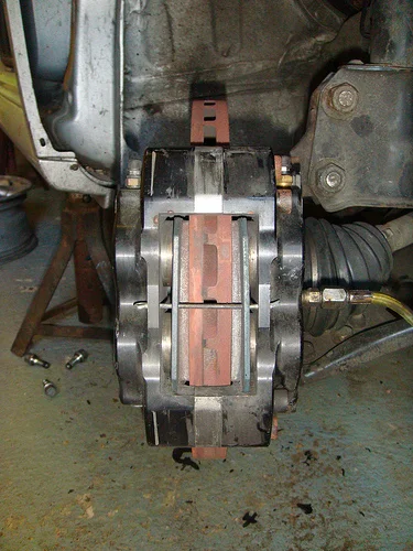

5713089739_7f64b5697e.jpg5713663154_8b223019b9.jpg5713666640_3423163159.jpg5713655632_9066fa28c8.jpg
Yeah i use a small bit of cooper ease when i put the pads in hopefully here are some pics to see if i have them fitted correctly!
Can you see the two top pistons are slightly more out than the bottom two there for wearing out the top of the pads!
Any ideas?? Is it something silly like ive got the brackets on the wrong side or something????

Its not that it bothers me i just didnt think it was correct! It seems that they have worn the outside of the disc out more then the inside aswel! Is that normal to???
