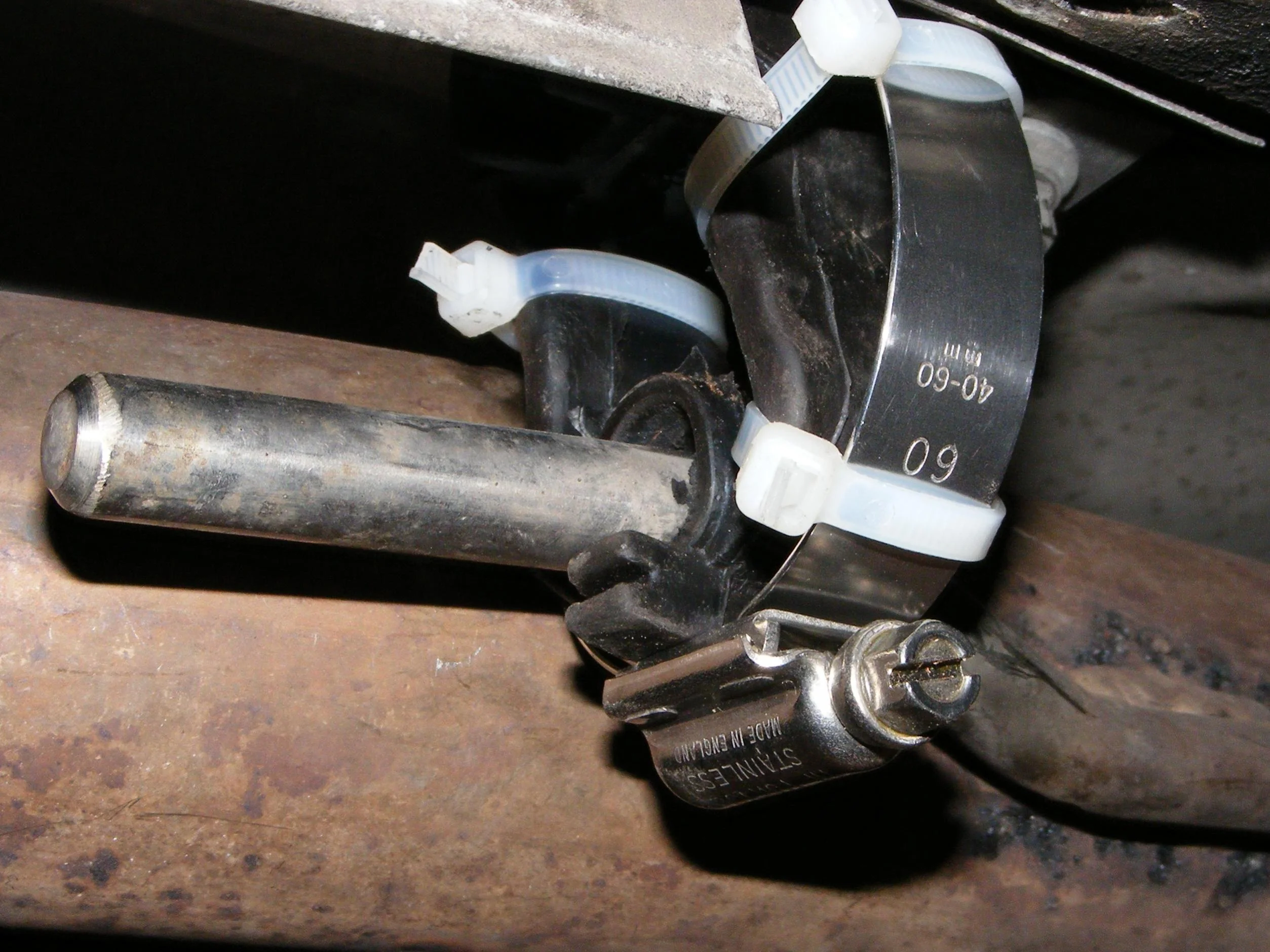

Did mine this evening... heavy duty jubilee clip !
Wrap round the new mount before you offer it up.. Just a few cable ties to stop it slipping away from the rubber. And it's adjustable.
Similar to that ^ But just put a couple of cable ties around the outside of it, rather than the jubilee clip. stop it stretching, if you get what I mean.

There was a thread on here while back - someone used a D shackle + a Powerflex universal bush. Seemed to do the trick :)
