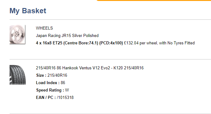

I've looked at a few different websites and posts to try and get my head around wheel fitment and the different aspects but still left with a question of whether particular wheels will fit. I know the centre bore on wheels can be reduced with a spigot ring and I know offset can be corrected sometimes with spacers. Will the wheels and tyres below (no hate pls) fit my 172 and if not can anybody advise what would be needed to make them fit (other than spigot ring).

I'd imagine they would be too wide tbh.
8 inch wide rim and an offset of 25. They will probably stick out of the arches.

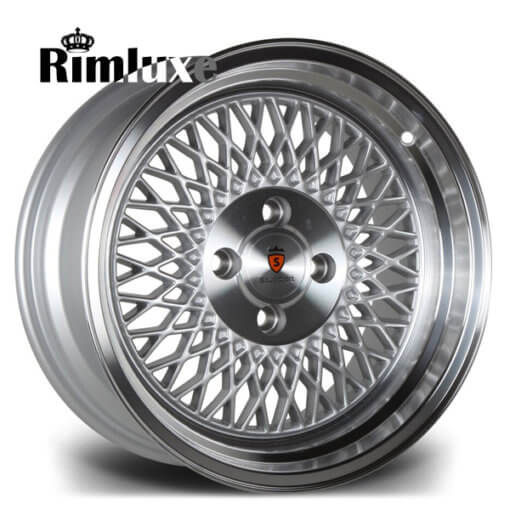

stuttgart are 8 x 15″ 4×100 ET25

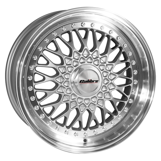

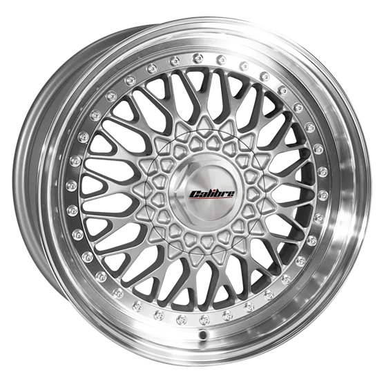

Calibre vintage are 7 x 16″ 4×100 ET38

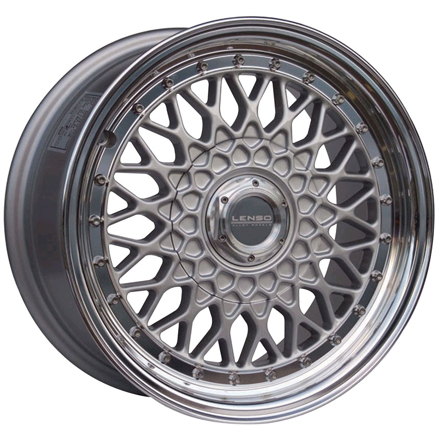

Lenso BSX are the same as the calibre but 7.5" wide and available in a range of offsets from 15 up to 45.
As you can see all similar style which is the style that I want but just also want the best fitting and then need to find out what tyre I need on them considering the weather and that it will be used daily. Appreciate the help :)
First set are far to wide and the offset is way to much, they will stick out a mile from the arches and potentially cause rubbing if you plan on lowering. Not to mention you'll be needing at least 205 width, more like 215/225 tyres which are much more expensive. As for the other wheels, yuck!:smile:

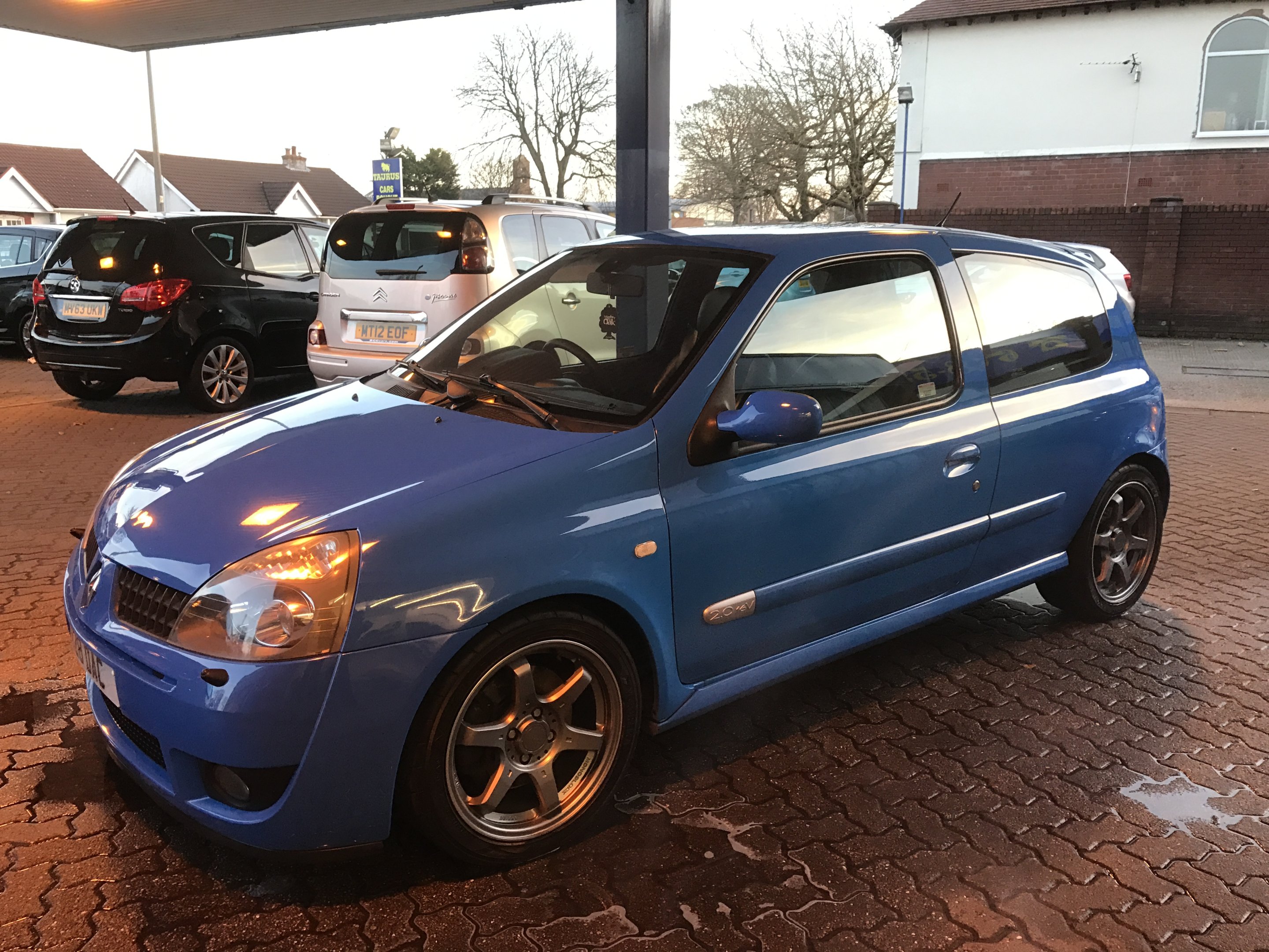

rota grid v :up: Sure @imprezaworks had them on his RB
