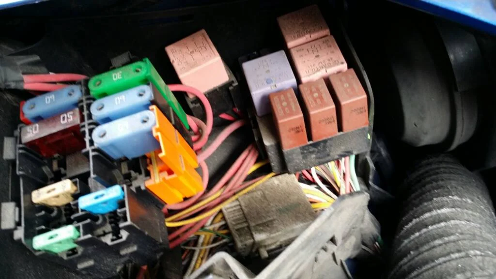

Air con not working.
Clio 182. Air con was drained and re gassed last year but can't remember if it's worked since then.
Only recently paid any attention to it not creating cold air...
Anyway it seems that she you press the ac button there is no distinctive click or change in engine rpm etc.
Have checked the fuses in the passenger compartment but they're all fine
Looked in engine bay but don't know which relay is the ac one or how to test
Can anyone help please?
