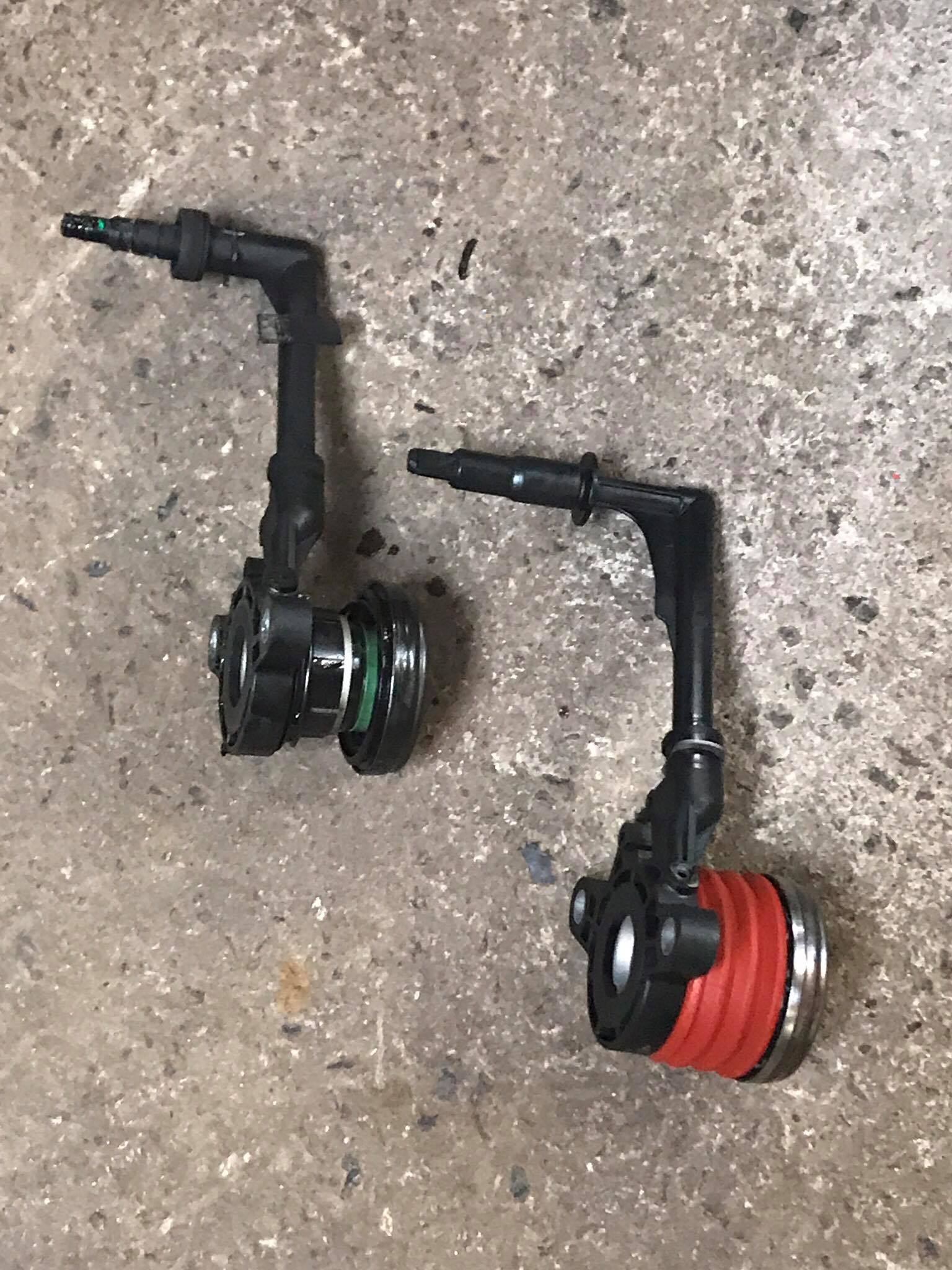

So a few days ago my 200 had me stranded in a car park after id reversed out of my space. It wouldnt select 1st, or anything else i tried for a minute or so until a few pumps of the clutch one finally worked. Then it drove fine for a the next three days going a few hundred miles, then this morning after a 2 mile drive to work same thing, put it into reverse, then when i looked for 1st nothing, would go in any gear.
The cars a 2010 with 35k on the clock, im guessing (hoping) the gearbox fluid has never been changed and that just might be it.
I'm assuming it could be a weep in the slave cylinder or even the clutch or linkages or even the gearbox.

So dealership says clutch is wear and tear item go f**k yourself so I've been quoted £550 for clutch kit slave cylinder and gearbox oil change

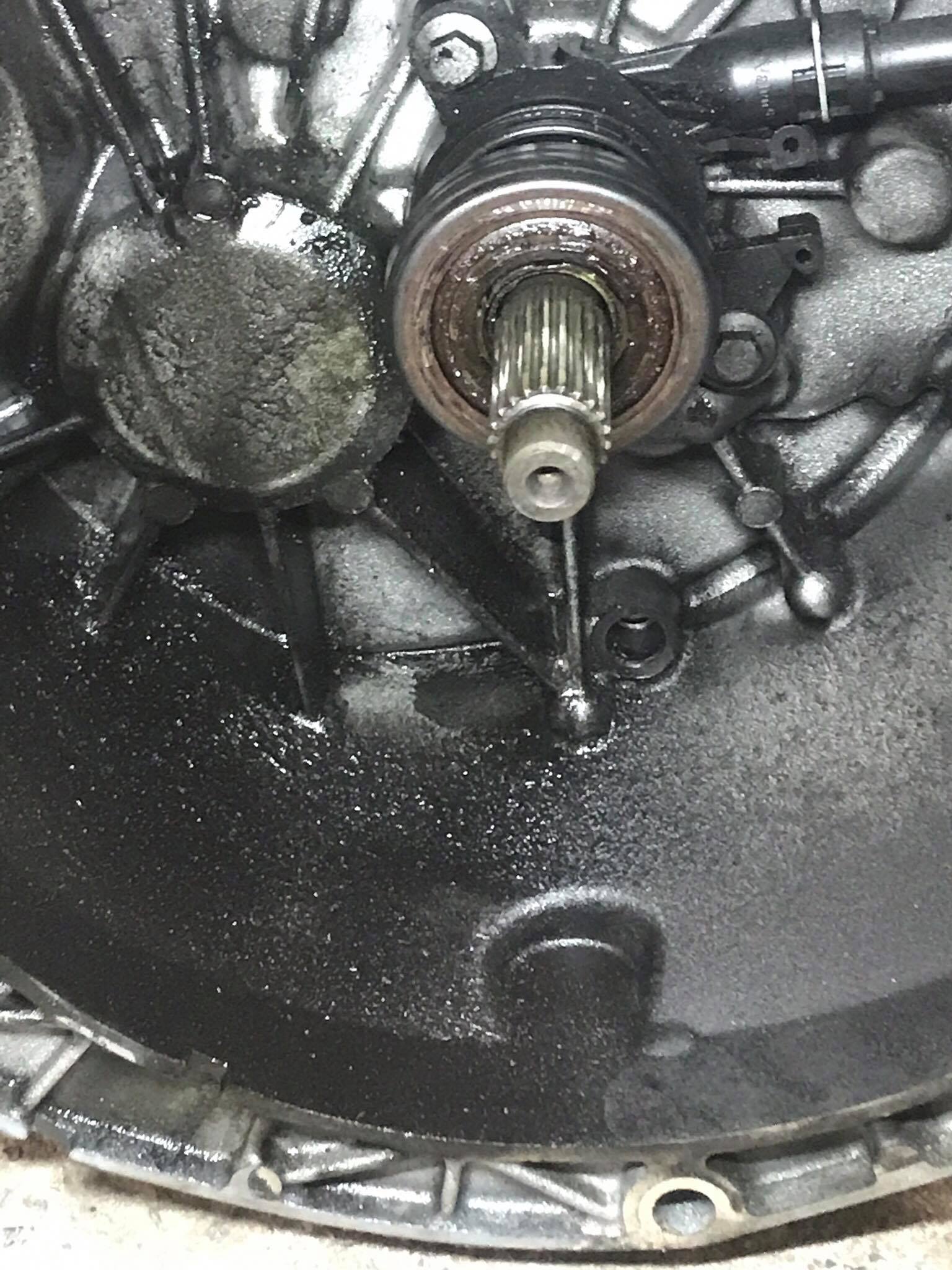

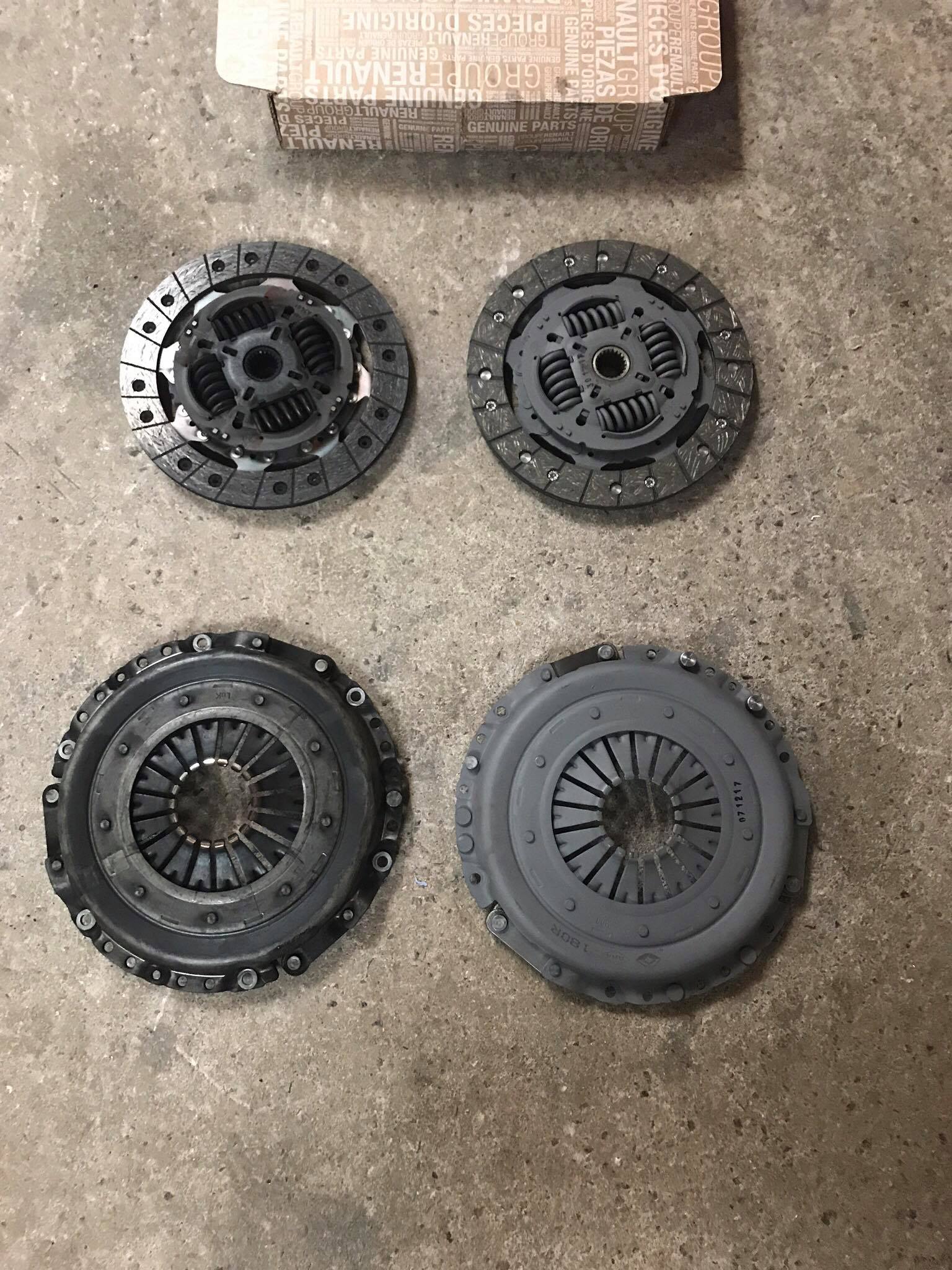

So here's the pics, old leaking slave on the left, brake fluid in my gearbox and old clutch on the left too. I know clutch doesn't look too bad but thought may aswell get the both done
