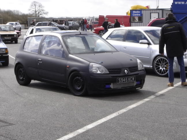

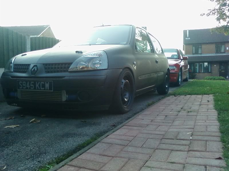

I personally think it's a fraction too low at the front, it looks too wedge like and the splitter often contacts the ground on some corners!!
Couple of turns on the front uprights or leave as is?

depends what it handles like tbh.
I personally couldn't give a rats arse what it looked like, as long as it was purposeful. Whats the understeer like with the front that low/stiff?
That's the thing, it handles ok but then I've got used to it like this.
I think when the H&R's were originally fitted IainC had Mark Fish set the car as low as possible.
Like yourself I'm not fussed about looks but if it's set up "technically" wrong I wanna know about it.

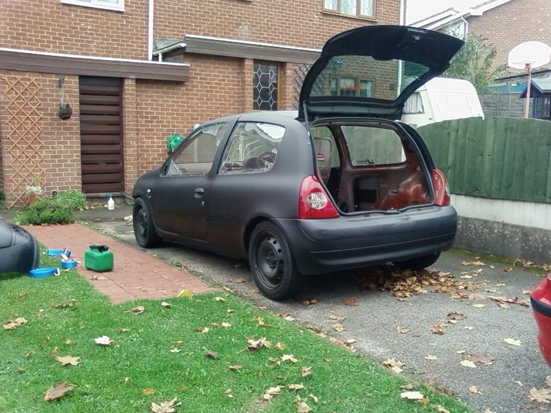

Try and get the sills level mate. Will mean the front is slightly higher than the back. Will try take you a pic.

It doesn't look too far off mine to be honest, perhaps the rear is a little on the high side, let me dig mine out........for the moment check the Westerham pics thread, mines S20 CUP, it was originally set up by Mark on the turini's, need it re-done with more camber on the 2020's.

looks too low on the front
there should be 41mm of thread visible
or
155mm from the middle of the top mounting hole on the strut to the bottom of the spring

No no no. you want the front of the sill to be fractionally lower. its called rake. improves turn in and front end grip! if you dont believe me go and look at any performance car such as an m3 etc and you will find that the sill slopes dwn at the front! It looks a bit low at the front at the mo to be honest and id say raise it up a bit and lower the rear a tiny bit.

Yep it aids turn in for the front to be lower.
higher lol
but the nose down stance is obvious!!! Who are we to argue?
mark set my ride hight but i couldnt get on and off my drive without the splitter scraping so i raised the front 4 turns and its fine now,
Would have been perfect on 16" wheels but because im on 15's it was even lower
when i raised it i had to take it back and they adjusted the camber and toe

Looks the same as mine. I mounted them how they came out of the box, i think it's the recommended rideheight from H&R.
the back is at its' lowest though.
I get scrubbing on fast/hard turns from the front. I've noticed there is a funny bit of the arch-liners that stick out something like an inch ; i think these are causing the scrubbing...

it looks to me like mark has given you his normal setup wich is the dogs you whant the frunt to be 10 to 20 mm lower to help turn in .
your ride hight looks just like mine the only down side is speed humps the car tends to cach going over them

Happy Christmas to you to, there are a lot of people on here you talk s**t but most of the time its easy to work out who. I do think it is good to have a litle weight over the front wheels by having the rear a little higher. If you look at the clio cup cars most of them are set up this way.
To be honest I've only owned the car since October and have only driven it in anger for a couple of dry laps around the Nurburgring, I guess come March time once I've pushed it safely around somewhere like Brands/Donington I'll be able to make my own informed decision :)
I'm happy with the way it is hence I've not bumped this thread up from the depths myself!
Removing the front carbon splitter has given me an inch of front ground clearance so speed bumps are less a nuisance as they were!!
